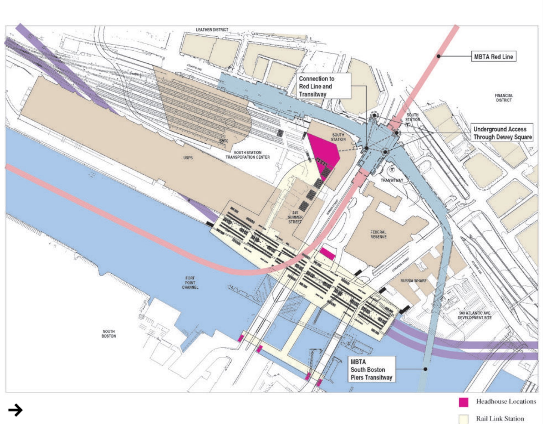

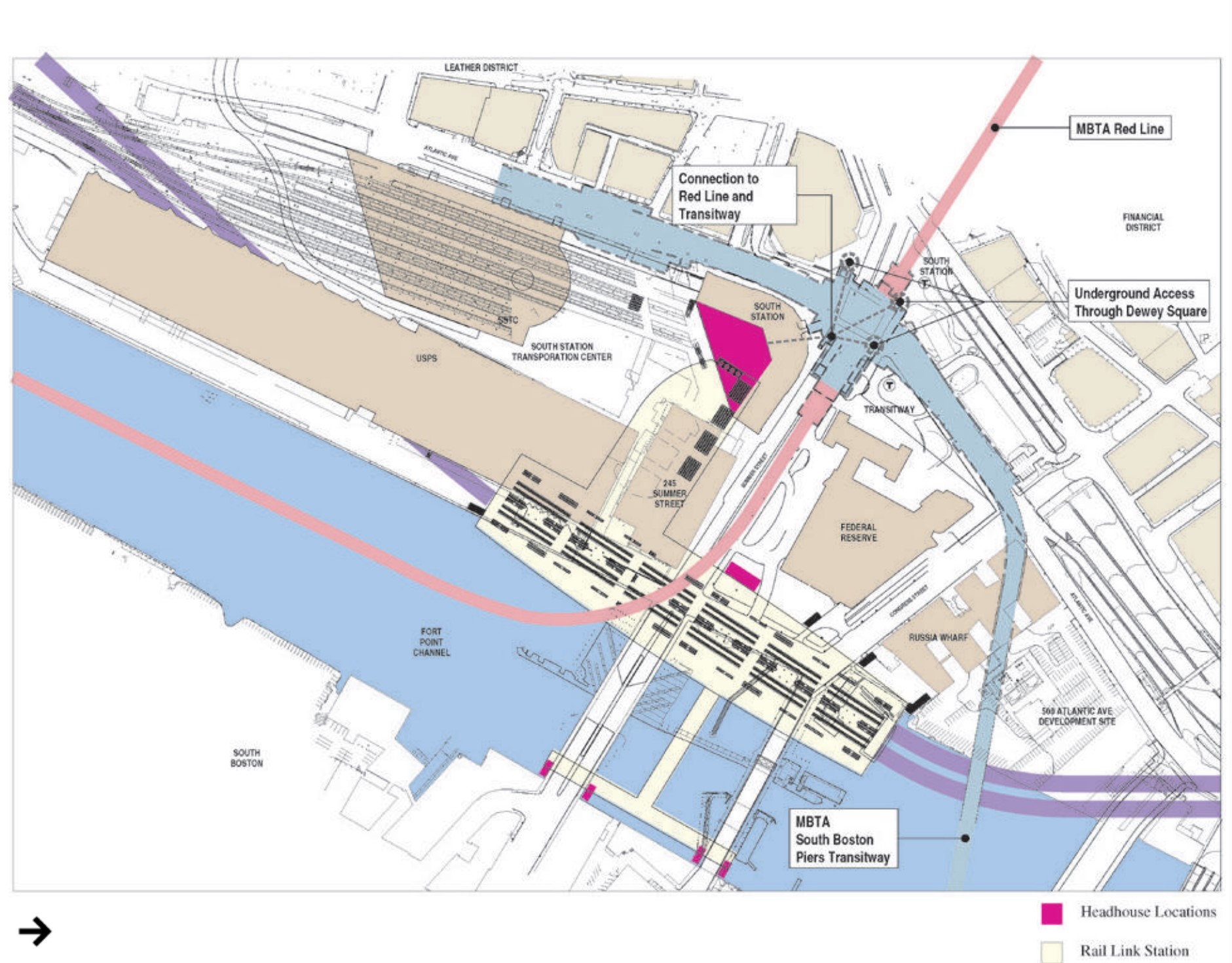

I found in the link below from a North-South Rail Link study the image below which shows the location of the underground Silverline line tunnel (MBTA South Boston Piers Transitway) as it ends under Atlantic Avenue. I do not know if it shows a fairly accurate depiction of the tunnel or is more diagrammatic. As discussed in earlier posts the Silverline Phase 3 was going to turn down Essex, but this plan seems to indicate it could be possible to slip under the train tracks going into South Station and then head towards Marginal Street or portal out on Atlantic Avenue with LRT connecting to the Greenline (Gold line:). This could be done as part of the proposed South Station expansion into the USPS location.
https://www.mass.gov/doc/chapter-5/download
Further below is a photo I have found of the Silverline turn around under Atlantic Ave.
View attachment 46521View attachment 46523
I believe this has been reviewed in multiple other threads (I cannot find the reference), the Silver Line cannot go any further south at this point. There is too much Big Dig tunnel work under Atlantic and Surface to navigate across. And under the tracks means navigated through the maze of foundation work for the South Station Bus Terminal. Not happening.
@F-Line to Dudley mentioned in multiple threads that the loop under Atlantic can't be extended further as the vertical space is constrained by the I-93 tunnel:
The loop's under Atlantic, but the dead-endedness of the stub is because of the orientation of the I-93 tunnels as they rise to the South Bay portal. They infringe on the SL tunnel's level as you advance down Atlantic.
The corner of Atlantic/Essex is where the wall is notched for the hook-in for the unbuilt SL Phase III. Essex is utility cleanroomed by the Big Dig to Surface Rd. for a tunnel (from somewhere) to be built, as that's the only feasible entrypoint. But there's no actual tunnel under there today.
Yes...on the bus loop end of the tunnel on Atlantic it pinches out of spatial room by tunnels above/below for any continuation from that direction. The Phase III hook-in point exists on the corner of Atlantic & Essex as a wall notch, with the junction trajectory basically spanning the middle of the intersection pavement plus the front steps to Two Financial Center (i.e. a pretty wide-angle junction for BRT/LRT). The Atlantic-South block of Essex facing Two Financial and South-Surface Rd. blocks were clean-gutted during the Big Dig for building the CA/T vent stacks and associated underground physical plant and was cleanroomed with SL III in mind. Transition from Big Dig nuke zone to Old Boston street is at the Kingston St. corner opposite the Radian & State St. HQ.
So any trajectory of any kind into SS & Transitway will follow Essex between Atlantic & Chinatown Park next to the Radian...slipping underneath I-93 @ Surface Rd. From the point of clearing the last I-93 wall it's then choose-your-adventure...but this block is the one and only set-aside insertion point into the Transitway because the Loop area further down Atlantic is squeezed off by criscrossing tunnels.
Now...to answer Van's question, the problem with going deeper under Essex west of the Radian is that there is hardly enough incline room to matter after you've thread needle on a totally fixed trajectory between Atlantic & Chinatown Park. Chinatown OL Station with its blowout underpinning costs is only 800 ft. west of there, and that's near the point of max street width pinch. The inclines already had to be of performance-killing variety to slip under the 1908 OL tunnel in only 800 ft. of run-up space, and were already unsuccessful at avoiding building foundation mitigation despite dropping as quickly/steeply as the mode would allow. Mode-switch to LRT and maybe it's not so lethal a performance hit at the same grades...but it'll still be suckily slow from what a sustained descent that must be to clear the OL tunnel, and still scrape the same hull on building foundation mitigation. If you try to steepen the incline some more for LRT's max grades, then maybe you can inoculate more building foundations, but at cost of the performance hit being so absolutely shitty and the constrained upstairs/downstairs transfer to Orange being such a P.I.T.A. that the tunnel won't be able to run representative headways. GL-Chinatown will be a dwell-killer.
At only 500 ft. west of Chinatown, the tunnel still keeps dropping to hit Boylston Under in a deep cavern. On BRT the deep cavern was completely untenable via the performance hit, and because you were now booting every passenger off the buses to loop making the sojurn upstairs to the GL level truly painful. You couldn't go deeper given that ALL from Atlantic was on a thread-the-needle trajectory set by criscrossing Big Dig tunnels, Orange Line tunnel, and max descent between them. Boylston was simply too close to drop down any more...and dropping down as much as they could possibly drop down already failed to ameliorate the blowout underpinning costs of the GL level + Common archeology. They already tried to go most of the way to Arlington with the Charles St. South portal approach underpinning GL, but while that proved feasible the Design was already fucked by Chinatown + Boylston where the depth could not be changed.
So, no...simply going deeper isn't an option from where any Essex trajectory must start. It's not enough running room. As before, Essex corridor ITSELF is the point of failure. It's no-go anywhere up that street because of the way insertion angles are set in stone by the thread-around other tunnels.

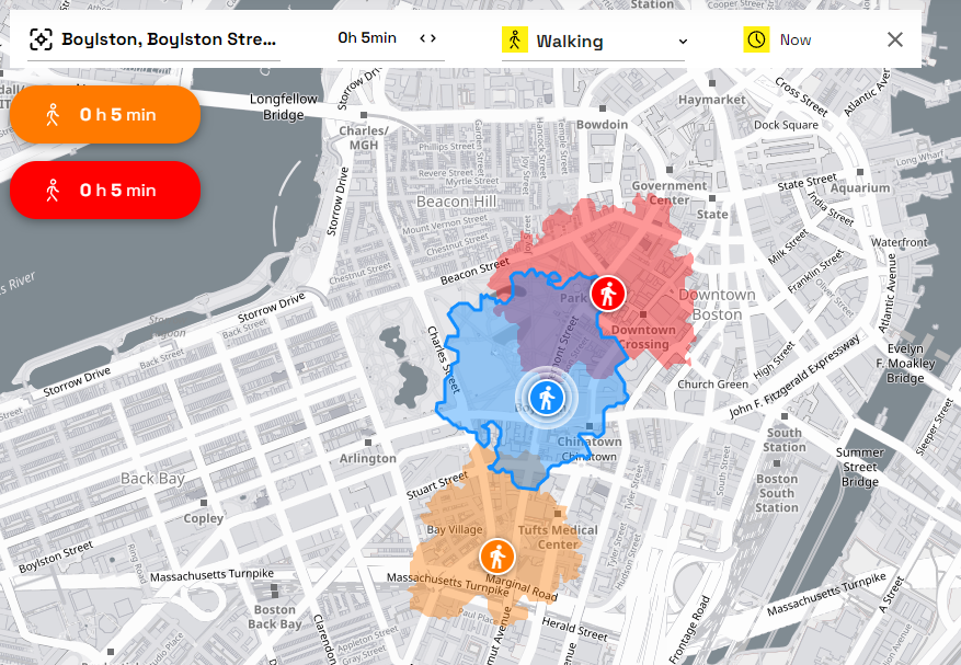

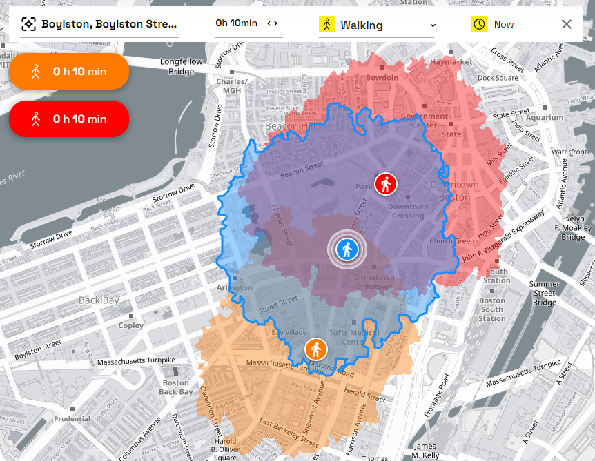

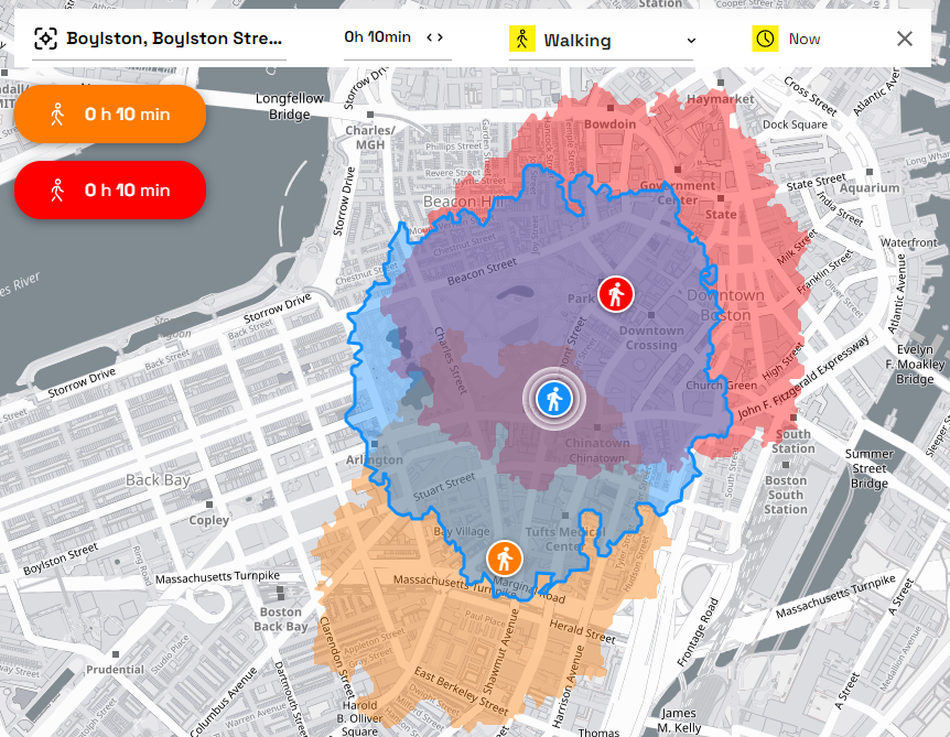

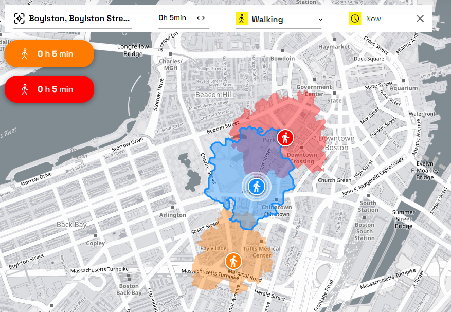

Boylston is also (by far) the lowest ridership stop in the Central Subway:
(You could consolidate Boylston with any station other than Park St, North Station, and Copley, and the combined total still wouldn't exceed those top two.)
So... why not have Gold Line trains run express through Boylston? The station would still be served by Kenmore trains on the inner tracks, and the only existing OSRs that would be disrupted would be those from the D and E Lines. (Assuming an even distribution of that 5,265, that would be about 2,600 riders -- comparable to some of the lowest-ridership [gated] stations on the network, including Green St, Shawmut, and Savin Hill.)
And those D & E riders would have an easy transfer at Back Bay to Orange Line service to Chinatown, or would have the option of walking from Park St or Bay Village, both which of cover almost all of Boylston's 10-min walkshed...:
...and do okay (though not great) on the 5-min walksheds:
Having Gold Line trains skip Boylston would have systemwide benefits:

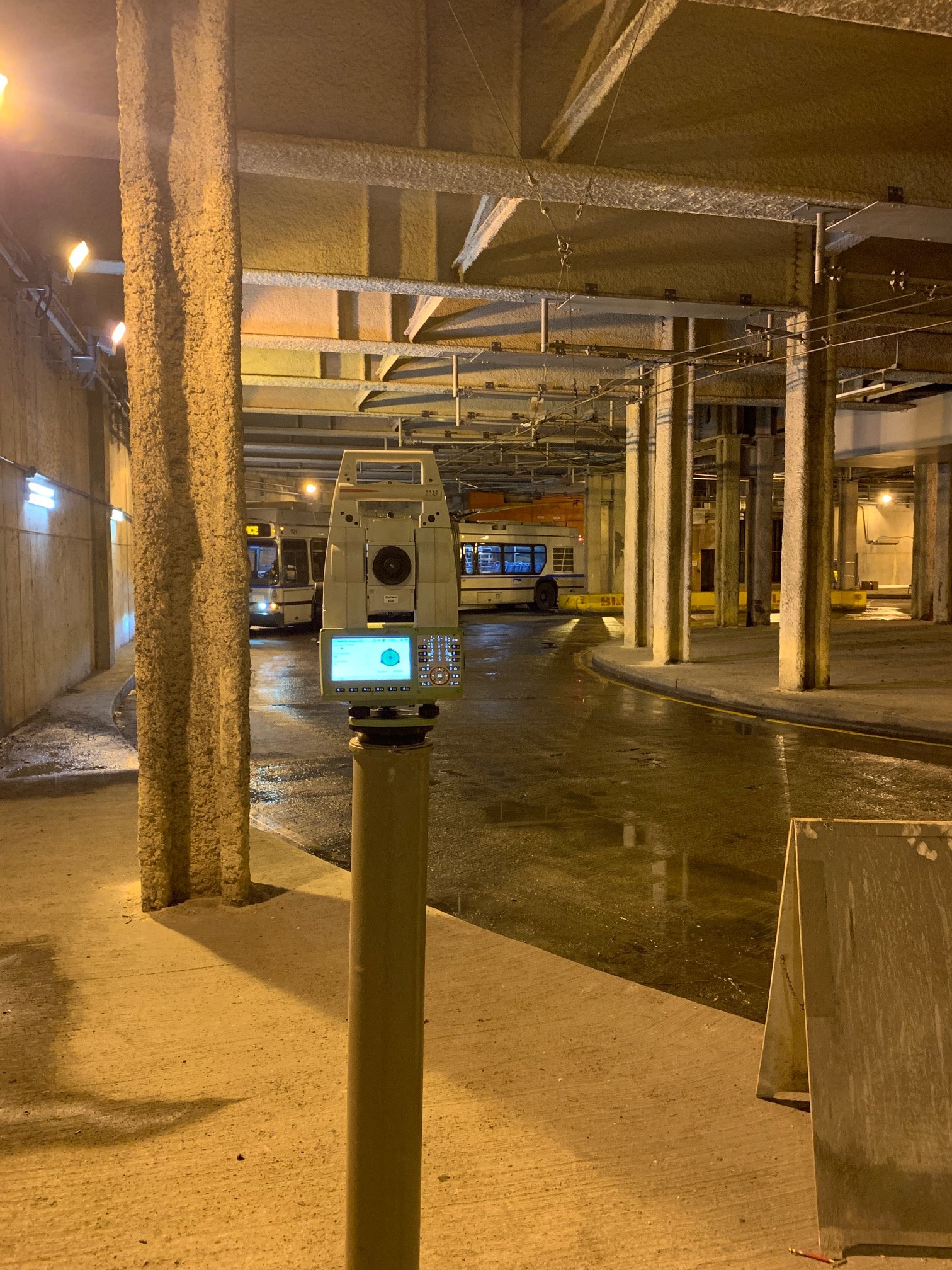

The Silverline transitway bus turnaround floor is essentially the I 93 North tunnel roof. As I 93 begins to portal up headed south, a transitway extension would also need to follow it to the surface. Therefore, a Silverline tunnel cannot continue south of Beach Street, but it should be feasible to portal up on Atlantic. A portal on Atlantic could be tough with traffic and South Station vehicular drop offs, but if that could be managed, I think a portal is possible.
In this 2016 post (below) F-line notes that it would be operationally dangerous to keep the bus turnaround loop under Atlantic Ave and a Greenline portal on Atlantic. He noted a portal is possible but the bus loop would need to be removed (and he felt that was not realistic).
http://archboston.com/community/threads/crazy-transit-pitches.3664/post-254062
With the bus loop removed the Silverline could continue out of the portal to Back Bay Station on Stuart and Columbus Ave as described earlier this weekend. This creates Chelsea (and Everett?) to Back Bay and Airport to Back Bay via Seaport Connections.
A Greenline connection from North Station to the Seaport via South station could be achieved by adding a Greenline portal on Stuart Street connected to Tremont Street tunnel. Light rail from the Atlantic portal could also turn down Harrison / Washington Street to Nubian SQ.

Skipping Boylston or not
  • Remove the most significant barrier to 3-car super(hyper?)trains for use across the network, increasing capacity by 50% everywhere from Needham to Medford, Back Bay to Seaport
  • Speed journeys between Back Bay and Downtown, providing a faster alternative to and decreasing crowding on the Orange Line
  • Reallocate funds that would need to be spent on Boylston to other parts of the system (e.g. lengthening other platforms), where the same dollars can be spent to stronger effect
While the ridership statistics did give me a curious idea of consolidating Boylston and Arlington into an in-between station at the site of the former portal between Arlington St and Charles St (provisioned for Post Office Sq), as for closing Boylston itself, I agree with @TheRatmeister's conclusions: Ironically, while consolidating Boylston may have value in today's Green Line, it likely becomes much less desirable in a full GLR world.
