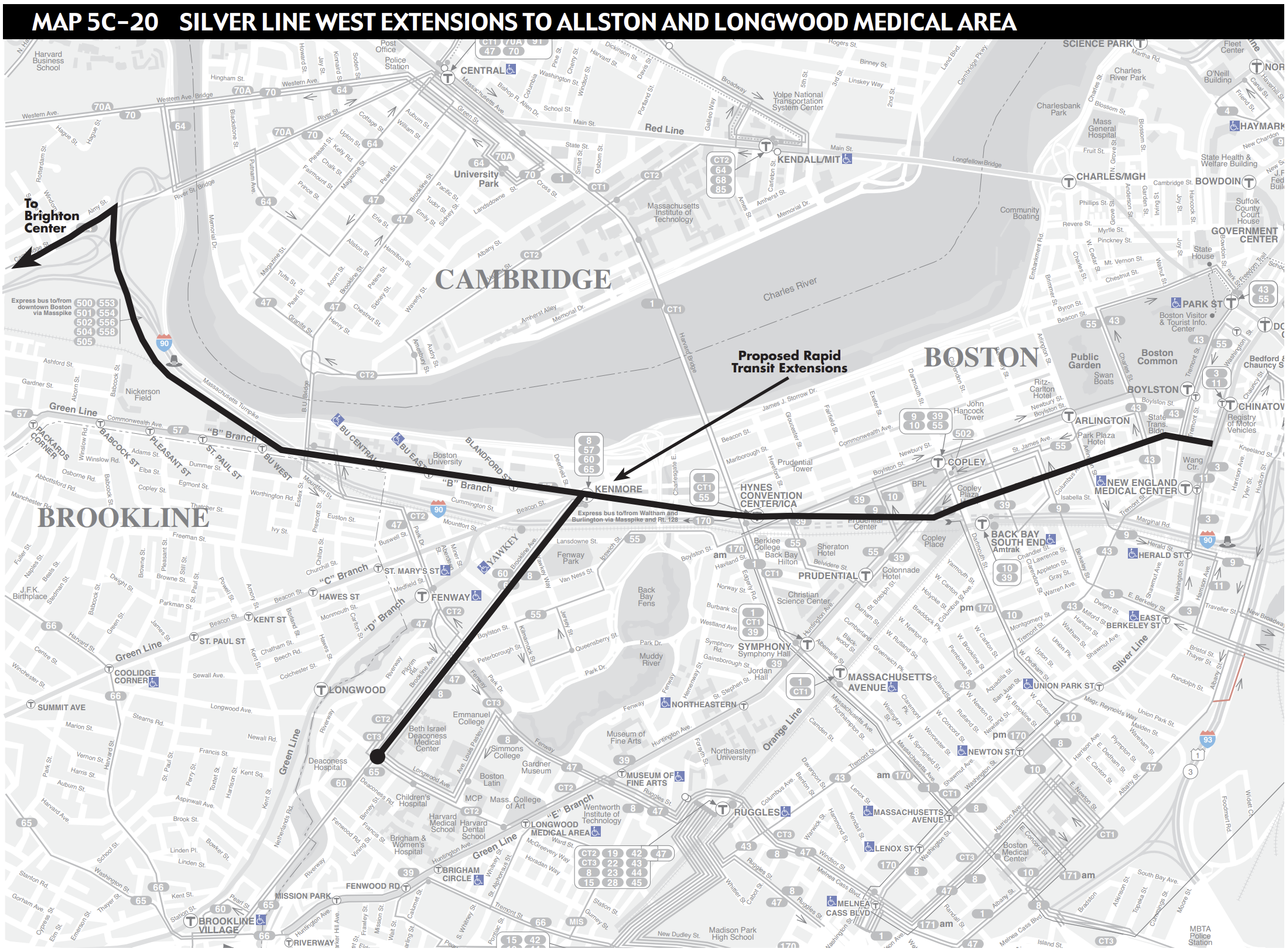

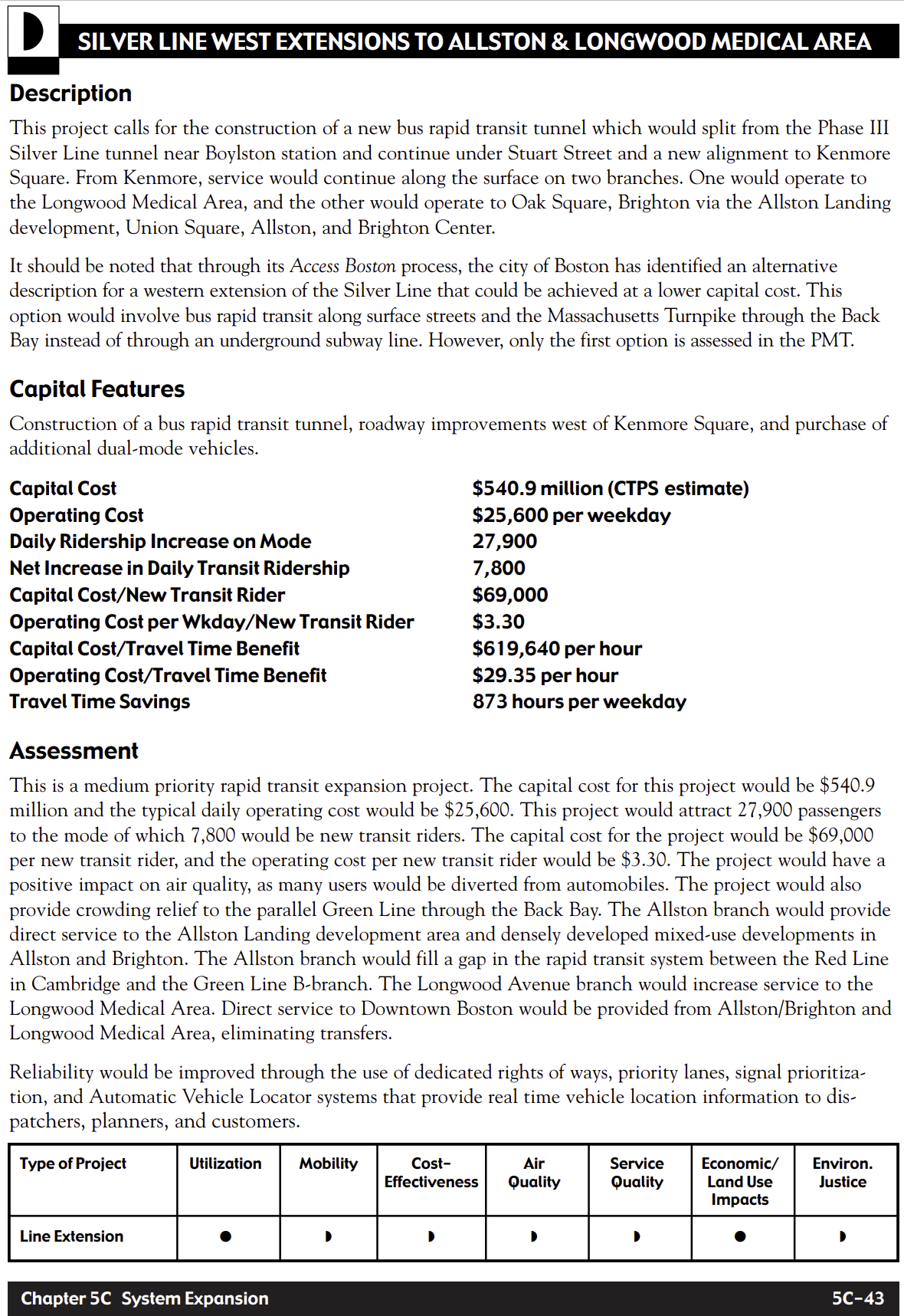

Anyway, while revisiting the 2003 Program for Mass Transportation (PMT) that evaluated a huge number of projects, I found this:
Absolutely wild. I can't believe this was a real-world proposal. Apparently, it was indeed proposed by the city of Boston.
A Silver Line BRT tunnel extension from South Station (branching out from SL Phase 3) to Back Bay (via Stuart St) and then to Kenmore, where it rises to the surface and runs in two branches: one to LMA via Brookline Ave, and another to Brighton Center via Comm Ave, Soldiers Field Rd, Cambridge St and presumably the 57 corridor.
It's already wild to think about a second tunnel from Back Bay to Kenmore (though, of course, @Riverside has proposed it before), much less doing it for a bus!
Yet, the idea actually does very well on ridership, enough to net it "medium priority". To put 27,900 projected daily riders in perspective:
  • Higher than BLX to Lynn (21,000) and SL Phase 3 itself (20,500)
  • Much higher than Red-Blue (6,500), GLX (8,400), Arborway restoration (14,200), Needham branch (3,400), OLX Reading (9,400), OLX West Roxbury (11,300), and RLX to 128 via Arlington (6,700)
  • Comparable to another (crazy) idea of merging the 23 and 28 into Silver Line (29,300)
  • Only 4 rapid transit projects have higher ridership: Urban Ring Phase 3 (134,700) and Phase 2 (53,000), NSRL (96,100), Nubian surface LRT (34,300), and the aforementioned SL23/28

Even better, GLR likely won't have as much cost, due to not needing to tunnel between Back Bay and Kenmore, and not needing to modify Kenmore itself. (Even a surface Huntington branch should do the job as well as this proposal's Brookline Ave surface-running.)
  • Their projected cost of $540 million for a 2-mile tunnel, part of which is under the Pike, seems way too low to me... Until you realize that their GLX projection was $375 million.
To me, this provides some support that Green Line Reconfiguration will indeed have good ridership. With LRT having higher capacity than BRT (and likely higher frequency if the Huntington-Seaport route can run every 3-4 mins), and improvements to service on every other Green Line branch, I expect eventual ridership to be even higher, even though likely not at the level of NSRL or the (much more expensive) Urban Ring Phase 3 tunnel. Even better if you also include Nubian LRT's ridership.
That is completely insane. Really goes to show how prominent the BRT craze was in the 2000s. Just the mental gymnastics you would need to go through for this...
At the time of the Access Boston study and the PMT, SL Phase III was already a-go (the PMT didn't even evaluate it because it was *assumed* to be thrashing along already). But it was before the problems during design started mounting with degraded vehicle performance in the tunnels, tunneling alignment straw-grasping, heinous cost blowouts, and so on. As well as failing to predict the existing Transitway's poorish vehicle performance and loading problems (it hadn't opened at the time). Even if they had evaluated SL III fully, the actual ridership would've severely lagged the projected ridership because of the resulting extreme slowness of the trips and the need (because of the degraded performance) to force-loop all ends at Boylston Under rather than run thru and hit all the subway transfers and all that Red/Orange ridership. The existing SL Washington underperformed by half its projected ridership because of the lack of behind-prepayment subway transfers to 3 of 4 lines like originally promised. You were probably looking at at least a 35-45% underperformance of SL III's projections if it couldn't hit the Green+Orange+Red trifecta on a thru trip because of the forced Boylston loopage, and probably half or more for "SL West" when the slashed roster of transfers collided headfirst with the poorer-than-originally-predicted bus performance.
The assumptions for "SL West" were thus built on a total house of cards, and assumptions making an ass out of U and me. The City generally doesn't run as robust transpo studies as the state does, so the methodology in the Access Boston source document was probably hella flawed to begin with. But the PMT should've known better and applied much more rigorous screening for this one. A big blight on an otherwise authoritative-over-time document of most-needed transit projects, but as you say...the BRT kool-aid was free-flowing in the late-90's and early-aughts.
"It's just like rail...except it has tires!" :poop:
Actually, the PMT did include SL Phase III. The alignment at that time included the Boylston loop and then going via Tremon St. Interestingly, its new ridership projections fell short of both Nubian LRT and this SL West proposal.
I actually wanted to ask: looks like buses can theoretically handle steeper grades than LRT, but I recall that you said before about how LRT running via Essex would have less punitive performance constraints than BRT. Is it because LRT can run faster when climbing up the tunnel, even though it's closer to the maximum grade that it can handle?
To be fair to them, the PMT map drew the SL West extension via Stuart instead of Essex. While it's not clear how they intended it to branch off from the "completed" Silver Line, the map shows SL West starting at Washington St while SL Phase III uses Tremont St further west. If they did intend SL West to branch from SL Phase III near the Surface Rd vicinity and bypass Chinatown, it would have been much more feasible.

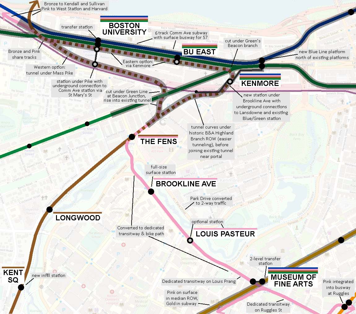

Brown uses the existing bellmouth between Arlington and Boylston (former Public Garden portal) for a flying junction under Lime. It then turns onto Charles St and Stuart St to the Chinatown Gate vicinity, at which point you resume with the old GLR plans. Magenta uses the Charles St Connector idea (entirely isolated from Gold) to also turn onto Charles St, and then join Stuart St in a bi-level automatically-flying junction with Brown.
This allows you to run all four service combinations: Kenmore-Park (Lime), Kenmore-Seaport (Brown), Huntington-Park (Green), Huntington-Seaport (Magenta). (Note my coloring system is a bit different from Riverside's.)
It was initially motivated by my concerns of tunneling under Hudson St, a narrow street abutting tall buildings. While this alternative Stuart St alignment for Magenta alone may not be worth the hassle (namely utility relocation) compared to just "brute-forcing Hudson" or many other alternatives (which I plan on writing about at some point), the ability to run Brown is definitely another draw. Another benefit is that it does away with possible concerns regarding turnback capacity of the Park St loop.
The main concerns are:
  • Reliability concerns of (1) having street-running branches enter the Seaport Transitway (instead of isolating them that GLR achieves), and (2) simply the amount of interlining required, with a new one now added at Seaport. (1) alone is today's Green Line which can hardly be described as reliable (see recent discussions), and (2) alone is NYC's entire subway system, where transit fans propose deinterlining every now and then. Neither alone is ideal, let alone both.
  • Frequencies on individual lines. If you run 2-min headways (30 tph) on each trunk, this setup means you can only run 4-min headways for each color. It may not be too bad of a capacity downgrade, as the load is spread out between many transfer points (and the mainstream GLR proposal limits itself to 4-min on Green, Magenta and Gold anyway), but still something to keep in mind.
But yeah, you're right that GLR's proposed 3-seat ride between Seaport and the entire Kenmore division is definitely one of its biggest drawbacks from a route design perspective.

A quick reply, but here is a broader overview of my take on this question, with the obligatory Pretty Map:
To your specific question of "is there a consensus on how to do this?", the answer to that is "Nope, definitely a topic of debate, and definitely no consensus yet!"
One question I think that would impact this: what kind of service are you running south of Fenway station? Is it surface-running in a dedicated ROW? In transit lanes? Is it grade separated? How far does it run -- LMA, Ruggles, Nubian? I think those would inform what kinds of investments and tradeoffs are reasonable between BU and Fenway.
@Riverside Very nice map, super interesting subject. If you don't mind me asking I'm curious what program you used. My thoughts...
  • Comm ave subway is very attractive to me, but six tracks with BRT? Is this just to avoid interlining completely?
  • BU could really use a less wide comm ave. The highest use of comm ave as designed is with a subway and a tree lined mall down the middle or on one side. If it was multiple tracks you could revive the A and take away the 57. They instantly get their campus back as well.
  • Doubling back at kenmore over digging a new subway provides some really nice frequency to that b branch trunk (if only it were more dense) but it seems like it would probably add more than a few minutes to the trip?
  • While it's a tight fit, if we were trying to go without or with only minor tunneling, Given that the pike may be decked there, there's room between mountfort st and the pike for some kind of crazy viaduct, or even move mountfort over the commuter rail tracks / take a row of brownstones and put the trains down Park drive. As long as we avoid dorms, we can and should be taking some land in brookline
Edited to add: Just saw the other guy mentioned Mountfort. I think there's merit all around but tunneling under the pike seems like it would be very deep grade-wise.
In @Riverside's proposal, the two Blue Line tracks are obviously needed regardless. The 4 tracks between the B (and possibly A) branch and the Urban Ring (from both Kendall and Harvard) are indeed to avoid interlining. Given there are two routes running on each, having all four interline will exactly max out the capacity; and the A/B branches involve heavy street-running further west, creating reliability concerns and propagating those delays onto Urban Ring (which itself faces its own street-running on Fenway-the-road).
The quad-track setup will be needed at two ends regardless to create flying junctions. IIRC, I've seen people saying the additional cost of digging a C&C quad-track subway compared to a two-track subway is relatively smaller (compared to TBM), but I don't have a citation for that. But one possible concern is utility relocation: the appeal of burying the B (and E) is that little or no utilities exist beneath the LRT reservation, but that's less certain under the travel lanes.
Beautiful work, as always! Quick question: with the revival of the A branch, is the 57 necessary? I could see a short-turned bus pinging between Watertown and Oak Sq (if the A terminates at Oak), but would it really be necessary to have a surface transitway on Comm for it?
Riverside and F-Line are both of the opinion that a resurrected A branch should only go as far as Oak Square, and I agree.
  • The biggest reason is again reliability. Oak Square to BU Bridge already has 3.1 miles of street running (only 0.3 miles shorter than the B would be once BU Central is buried). Running to Watertown Yard adds another 1.5 miles, and involved tricky traffic conditions when crossing the Pike, at which point it really becomes too long for me. Remember, the old A branch was chosen to be terminated (when the D was launched and there was a shortage of cars) exactly because it was the least reliable and had too much street running.
  • Demand patterns on the 57 also support it. Bus route profile for the 57 shows that while many people board at Watertown Yard and some at Newton Corner, the remaining stops along Tremont St and Galem St are relatively light until the bus hits Oak Square. It's not clear to me whether the Watertown and Newton Corner riders are taking it all the way to Kenmore and downtown, but even if they were, there may be better solutions for them (e.g. improving 504 and making it cheaper, commuter rail Newton Corner infill, improving 70 and 71 for Watertown).
  • The roads may just be too narrow for dedicated transit lanes. Parts of the A's route east of Oak Square already concern me, where the road is often 46' wide and not enough to accommodate 4 vehicle lanes and 2 bike lanes. (I assume F-Line's A branch proposal may have been before dedicated bike lanes.) But it gets even worse on Tremont St further west, where it's often just 43' wide. (To be fair, that portion also doesn't have dedicated bike lanes which may make it easier, but there's no reason to believe it won't ever get bike lanes; the neighborhood also seems lower density and more car-dependent, so getting rid of parking will be a hard sell.)
If the A only goes to Oak Square, the need for the 57 bus obviously remains.
(Edit: I realized I completely missed the part of @BosMaineiac 's question about shortening the 57 to Watertown-Oak Sq, vs. Running it full-length to Kenmore. But I think it's not clear either, because I suspect there's a decent demand from Watertown/Newton Corner to east of Oak Square, such as Brighton, Allston and BU. A forced transfer isn't ideal. But yeah, definitely worth the discussion. )
I've considered a viaduct over Park Dr too -- using exactly the land between Mountfort and Worcester Line as you suggested. The challenges are:
  • Putting up an El next to Brookline neighborhoods next to Mountfort St: Good luck with NIMBYs. (The buildings next to Mountfort and most buildings on both sides of Park Dr are owned by BU, but a few Park Dr buildings at the corners are private.)
  • BU air rights, as they're definitely looking into putting buildings on the parcels next to Mountfort.
  • Space: You have 950' of slack between BU Bridge and the point where the greenspace becomes too narrow (meaning you need to be above Mountfort by that point).
    • Using @Riverside's rule-of-thumb of "260 ft per level", it's enough to climb the 3 levels required (below Pike - Pike - Mountfort - above Mountfort), but with little slack.
    • But another problem is Carlton St: You have to be at Pike level (or below) at that point. There's only 410' between that and where you need to be above Mountfort, and you need to climb up 2 levels, which sounds infeasible.
