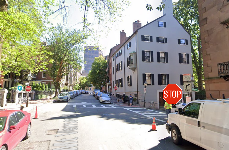

I've drawn my picture of the intersection (Mt Vernon uphill as Walnut tees out on the right).
Today, an uncontrolled right turn is permitted (the "right turn only" sign can be seen)
And when there's a vehicle parked too close to the corner (as seen in my Streetview hack job, below)
Vehicles making the right do not have good sight lines to the crosswalk and whip around the corner.
Hence the need for a stop sign, as shown, not to scale ;-)
My suggestion:
1) Paint a stop line (or a whole crosswalk)
2) Paint a bulb-out on the asphalt to encourage pulling farther into the intersection before going right
3) Put a bollard/planter with a stop sign about where the construction cone is (or even a little to the left)
4) And then come back and do a physical bulb-out (brick surfaced, cause this is Beacon Hill) around that whole corner

So I went away for a 2-week vacation and when I got back, the city had installed a new stop sign right where I requested it! (hat tip to @Arlington for creating the convincing image). See attached photo of the street as of yesterday with the new stop sign to the right.
I wish I could claim more credit or had an insightful comment, but I got a bit busy and never followed up with BTD about the case. I checked my email and text messages and I never received any contact from the agency. So I guess my finding here is that sometimes they do just follow up on tickets with no prompting. I wonder if other neighbors reported the same issue and that may have increased the urgency.
I did note that the stop sign replaced a "right turn only" sign and a 2-hour parking sign on an existing pole, which probably decreased the work needed significantly.
