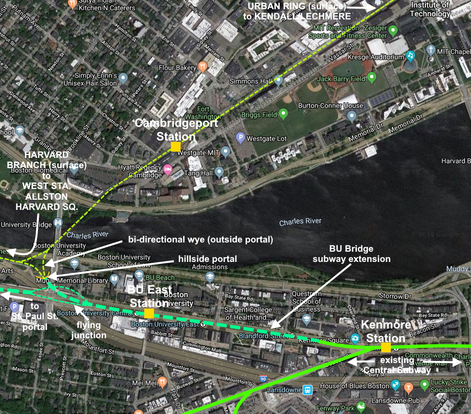

Keep in mind, the tie-in to the Green Line & Central Subway is going to have to be at BU Bridge in order to net any non- dog-slow junctioning geometry, so the critical parts of Urban Ring LRT all happen well east of the West Station/Pike realignment project limits. Plowing out to West then banking a hard left into BU and some other hard left back on-alignment gives up the ghost on any acceptable performance before it finishes making those turns to be practically operable as a service schedule. We've slugged that one out to the nines in Crazy Transit Pitches, and every stab at a Babcock St. subway 1/2 mile off-alignment and framed by unforgiving 90-degree turns out laughably impractical to operate in the real world.
Rather, West Station LRT itself is going to be located on the first 1/3 to 1/2 mile of the Harvard branch spur proposed for the UR...or built as a basic +1 West starter stub out there in a package with mainline UR that later gets infilled on the installment plan into a full branch through Harvard-Allston and finally across the river into Harvard Station. Whether you're burying the B reservation to BU Bridge or doing the more complicated BRT build that had some complex subwaying down Mountfort St. to some TBD portal, the UR interface all happens at BU Bridge because that's the only place where the angles coming across the Charles are anywhere close to favorable for making relatively speed-unrestricted turns on the Boston side.
See crude drawing here:
So anything and everything having to do with decisions re: West happens elsewhere, because the outer Pike project limits are a decent distance away from all practically operable permutations of the UR's routing linchpin at the bridge. Therefore, the only thing you have to provision is a 2-track reservation for the Grand Junction somewhere within project limits to make it compatible with a UR conversion. It's a pretty low bar for future considerations provisioning, and so far I haven't seen any alt. renders circulated that seem to jeopardize it. So we're A-OK here until proven otherwise.

It's not all that complex overall. About 4500 tunneling feet grand total for all components. Dig straight under the mostly utility-free B reservation to Carlton St., requiring at most left-lane shifting or left-lane closures on Comm Ave. to work in the trench. Mercifully few utility relocations and ultra-wide roadway width speed the schedule by keeping necessary block-to-block mitigations at a bare minimum, such that this can be blitzed in a couple years. 1 station cavern hollowed out at the St. Mary's intersection in front of Marsh Plaza. From Carlton to the hillside portal, a slight curve through the BU Academy parking lot for the UR route skirting the Pike footprint, and a flyunder junction of the Pike for the B portal (outbound side swings out slightly and descends under the UR level, inbound side stays straight but inclines under the Pike). New B portal at roughly where the west end + crosswalks of the BU West platform currently is, proceding into a St. Paul platform. During construction inbound B service is temporarily turned back at St. Paul/BU West and shuttle-bused to Kenmore. Covered surface then restored as extension of Comm Ave. Mall to BU Bridge, with whatever Bike infrastructure you feel like framing the park with.
Say you were to take as gospel the state's original Red-Blue cost estimates with their unprecedented contingency padding and nonintuitive construction methods (i.e. multiple methods including deep-boring under a street that most other experts conclude is spot-on ideal for uniform cut-and-cover at lower cost). And say you were to treat that as some sort of impenetrable cost floor for any tunneling of any kind, because we live in a horrible world of induced inefficiency where Not Invented Here syndrome makes us have to assume NYC-level overruns for damn near anything civilly engineered. Despite all that it is still physically impossible to come up with a more costly estimate for the BU Bridge subway than Red-Blue, because the digging is so much more strictly uniform in nature with such lower quantity of utility relocations. In the real world where R-B gets a sane adjusted-down valuation it's still probably not going to cost more than the Red-Blue we know we can build. Figure this:
  • tunneling feet: Comm Ave. > Cambridge St.
  • flyover junction: Comm Ave. > Cambridge St.:
  • stations: Comm Ave. (ultra-wide footprint, no attached structures) Cambridge St. (narrower footprint, required structural integration with RL Charles)
  • utility relocations: Comm Ave. < Cambridge St.
  • traffic mitigation Comm Ave. (slight width advantage) < Cambridge St. (emergency vehicle traffic). Even if the Pike throws in some complication, the narrow angle the St. Paul portal tunnel cuts under it means you can cover the roadway with temp metal plating + smooth-over top layer of pavement + "BUMP" signage for prepping the undercut rather than needing to close any lanes.
  • geological inconsistency: Comm Ave. (flat uniform fill) < Cambridge St. (base of a hill)
  • structural avoidance: Comm Ave. (way far from buildings, portal buffered from nearest BU Bridge pilings) < Cambridge St. (tail tracks must split around RL viaduct pilings)
  • demolition: Comm Ave. 0 < Cambridge St. (Bowdoin Loop retaining wall demolition to straighten alignment)
Tunneling feet + presence of junction runs up the score initially, but the significantly greater simplicity in all other respects knocks it back to near-par. Tally it all up and you should end up within single-digit % of par budgets for both the Blue and Green/UR tunnels. Now, of course the UR is a further-reaching project than Red-Blue encompassing all of the Grand Junction conversion and (relatively simple) Union Branch hook-in in addition while Red-Blue is just the tunnel. But it's also going to move a shitload more daily passengers when complete so the value proposition of the whole-shebang is in a different stratosphere too. Since tunnel is the most inapproximate type of construction to factor beforehand, to be safe in this case we're simply looking at what properties encourage and what properties limit the blowout potential. Then comparing it to a KNOWN project (Red-Blue) that has a readily available foul-smelling blowout estimate and far less costly cost-corrected estimate to usefully compare with. We can determine a range based on where R-B estimates blew out...then...didn't blow out. And if the blowout potential here ends up being sharply constrained by all the places where the engineering is easier on Comm Ave. than Cambridge St. you can reliably conclude that the chances of netting an off-scale whopper estimate are attractively lower. While the chances of netting a real-world actualized adjusted estimate are no worse than equally good.
So it will never ever come in more than Red-Blue's highest-ever estimate, and more than likely come within rounding error of Red-Blue's adjusted. We know Red-Blue's adjusted estimate is a slam-dunk build, and that in spite of the Grand Junction surface portion still needing to be fully vetted the Urban Ring's upside is intrinsically higher than a +1 w/transfer. So if you net a BU Bridge tunnel that's within single-digits % rounding of Red-Blue, you know you have a slam-dunk here too.
