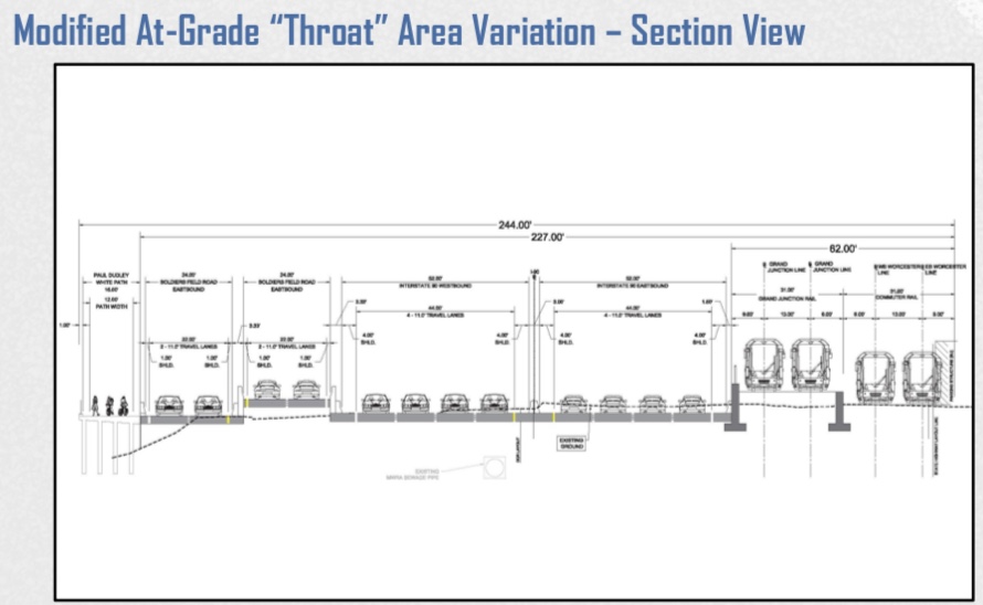

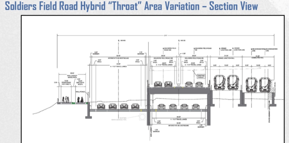

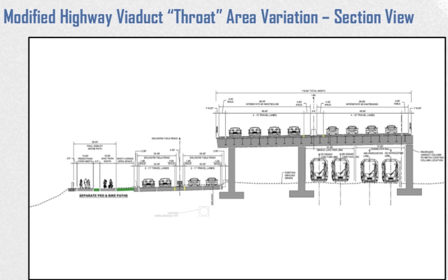

This is because the elevated sfr proposal that was looking to be the leading candidate drops well below the existing ground level and bank of the charles, much more than any other option including all at grade as you can see by the dotted line.
The at grade option only slightly dips below in the east bound lane and doesnt dip below the river bank at all, it just flattens out the ground level.
The “modified” rebuild as is option is the least of the offenders, but even this slightly dips below current ground level in the eastbound lane of sfr.
So it doesnt really make any sense why the feds would specifically single out the all at grade option as untenable, when it appears that the elevated sfr proposal is by far the worst offender as far as dropping below the flood plain. If anything the elevated sfr proposal should be the one taken off the table and they should have to either find a way to work with the at grade proposal or rebuild as is. Their argument for why the all at grade option doesnt work is a crock of shit, especially when every proposal includes either sfr or the pike at grade.
