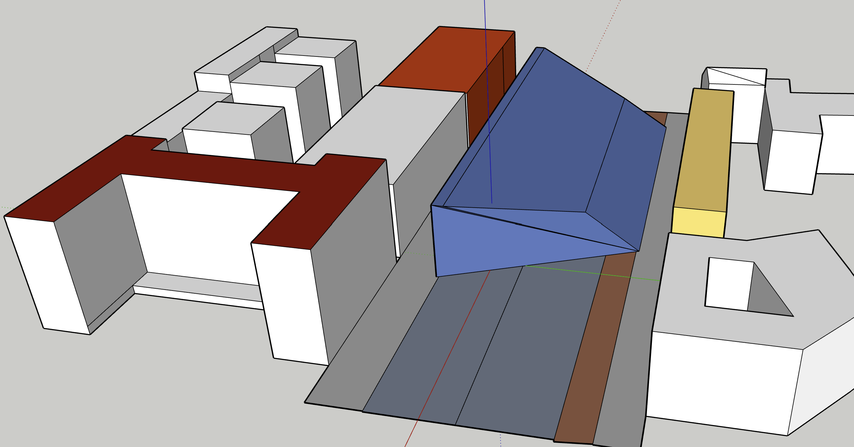

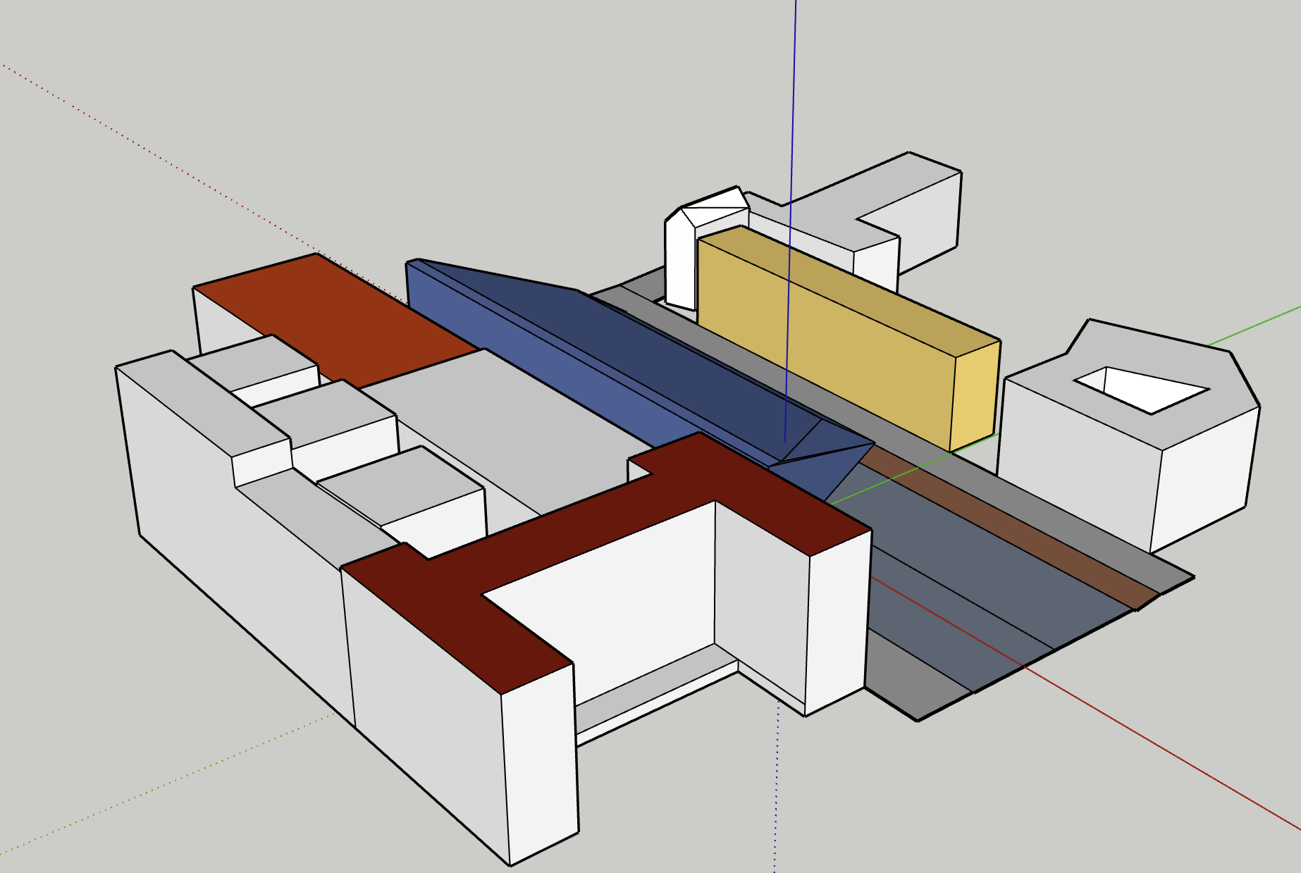

That said, a careful reading doesn't suggest no development at all; rather no development that would impact their natural northern exposure. I would tentatively posit (not being an architect) that given that the 6-7 story buildings / garage across the pike aren't impactful you could probably work out something like a landscaper in the form of a low faceted wedge. - I played around in SketchUp and something in this "sky exposure plane/" envelope to borrow a NYC term would probably work if one pretends that Pike clearances don't exist.
View attachment 21571View attachment 21572

Very cool visualization.
Looks like minimum highway clearance height is 16' and the average building story is about 14'. Instead of your wedge, I'm conceptualizing frontloading the development as close to Newbury as possible. Let's say you could steal the Pike-adjacent parking lane from Newbury directly across from 429 Newbury (crimson roof H in your render). If you could fit a legal at-grade lobby and stairs/elevators in that very narrow stretch, you could maybe get away with that plus 6 additional stories right on Newbury. Then you could build over ~60' of the Westbound Pike with just those 6 upper stories, which is comparable to width a "leg of the H". If you drop down immediately to a surface park over the Eastbound Pike, and perhaps taper to a total of 5 upper stories directly across from the studios (facing the garage and Harvard Club parking lot on Newbury), you MIGHT be able to avoid blocking their light.
The question is, even if you take into account the intangible public good caused by decking the Pike and creating a new park linking Mass Ave to Charlesgate, would that hypothetical development including 5-6 stories ~60' wide in the Back Bay make the cost of the deck worth it?
