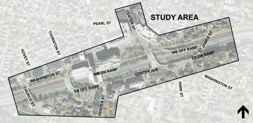

The virtual public meeting for the Newton Corner long-term study just started a few minutes ago.
The first public info meeting for the Long-Term Study is Tuesday, October 8, 2024, at 6:30pm on Zoom. Please register to obtain the Zoom link.

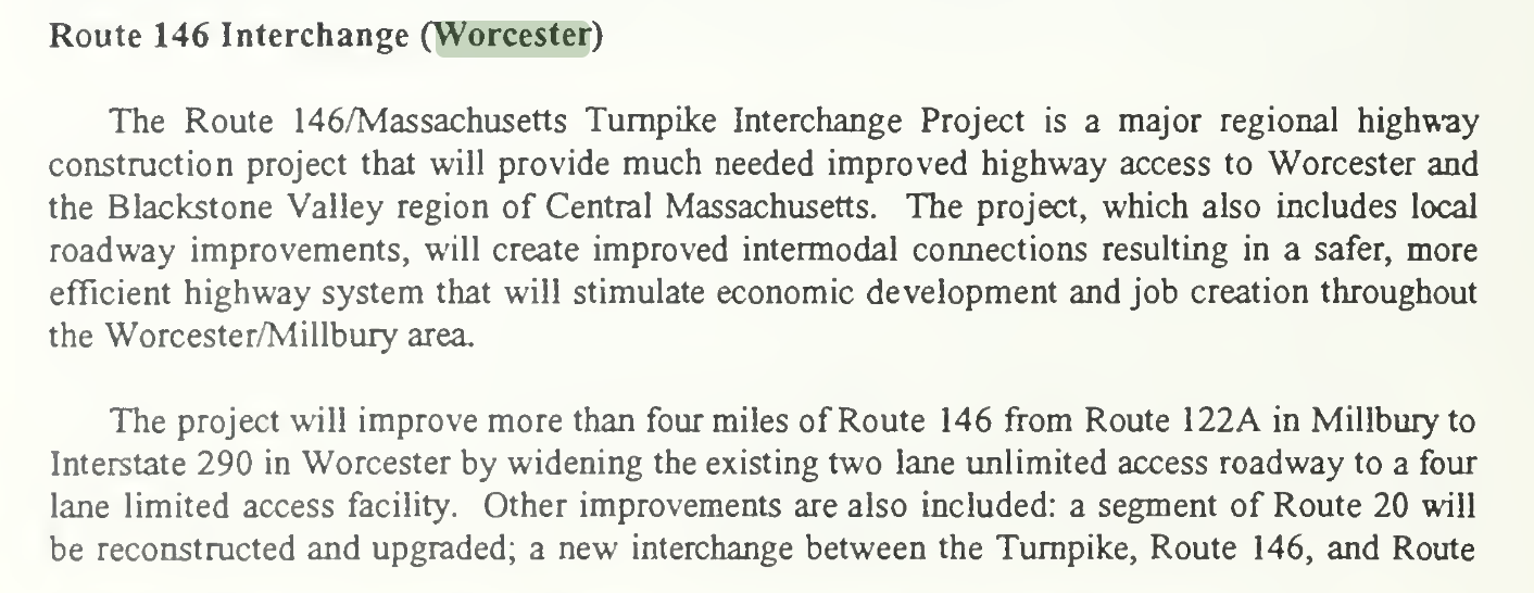

I clipped some example from my quick search of that 1995 document here:
EDIT: Well it looks like you could ask the Worcester Public Library to let you get information from this: Access study for the Worcester Regional Airport, Worcester, Massachusetts : final report.

From that digital collection, maybe finding something like this: Accessing the future: the intermodal transportation plan for the Commonwealth of Massachusetts 1995 (see pdf to download on the left) which makes references to some interchanges in the Worcester region. I don't have time to go further down the rabbit hole, but searching for "turnpike worcester interchange" and limiting between 1990 and 2004 leads to a bunch of results on that digital archive
