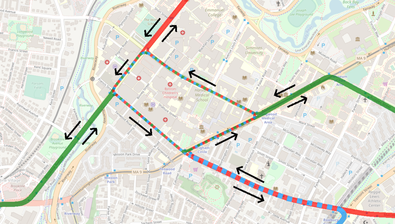

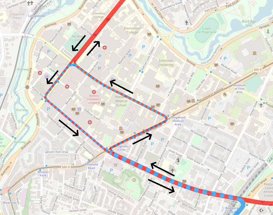

Has the Bus Network Redesign team specified any proposed/hoped-for infrastructure improvements for LMA? The final design will (I believe) call for 30 bph in each direction on Francis St (8 min headways each on T12, T22, T28, and T66), plus 12 bph per direction on Longwood Ave (T47, 65, 85) and and varyingly 17 to 20 bph per direction on Brookline Ave (T28 + T47 + 60, and T12 + 60 + 65 + T66).
Brookline is probably wide enough to accommodate bus lanes + car lanes, and the western half of Francis probably can, but I don't see have you get dedicated lanes on Longwood without making it one way to cars.
The network also leans heavily on Tremont St to connect LMA to the Orange Line at Roxbury Crossing -- is the expectation that they can grab bus lanes there? Over in the Green Line Reconfig thread, we've noted that some reconfiguration on Ruggles St (mostly already in planning by various parties) could accommodate bus lanes between Huntington and the Orange Line. If the T12 and T66 were rerouted to Ruggles, perhaps you could get away with creating paired one-way bus lanes on Longwood and Francis?
That would still leave the T22 and T28 going somewhat roundabout but need to use Huntington to cut over to Longwood from Tremont, but maybe it's workable?
(T28 in red, T22 in blue)
Actually, looking at now, St Alphonsus is potentially wide enough to take a single bus lane:
The downside is that northbound T28 riders end up with a longer walk to the southern corner of LMA, so I dunno.
Just to be a little clearer about what I meant about rerouting the T12 and T66 (in green below) to Ruggles:
Though stepping back, I'm not sure you really get much by rerouting to Ruggles, even with the pair of one-way routes through LMA -- you avoid the Longwood-Huntington-Tremont jog, but trade it for the Huntington-Ruggles-Tremont-Malcolm X jog (purple vs orange):
So maybe the answer is:
  • two-way bus lanes on Brookline Ave
  • paired one-way lanes on Francis St and Longwood Ave
  • bus lanes on Huntington (larger reimagining needed there to improve reliability of T39)
  • two-way bus lanes on Tremont St from Huntington to Roxbury Crossing
Thank you for attending my meandering TED Talk.

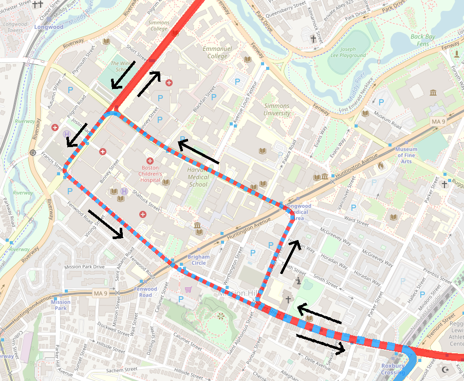

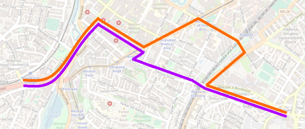

Great ideas! Now, would these bus lanes possibly be useful for SW quad of Urban Ring as street-running LRT, if implemented as shared LRT/bus lanes?
I've been chuckling to myself since I made the post and saw all the (very kind) "Like" reactions rolling in, because, like, a) I did not think my post was of particular quality, and b) I was legitimately asking, "Anyone got any [better] ideas?" 😂
One downside that occurred to me is that combining the Francis and Longwood corridors would mean that each of those bus lanes would see a huge throughput -- I think over 40 buses per hour. To @The EGE's points in the Green Line Reconfiguration thread, there's only so much you can do with transit signal prioritization; think of your typical traffic light cycle, and now consider a transit vehicle coming every 90 seconds -- it's going to be hard to consistently give the bus priority, meaning there will be a cap on the speed with which you can shovel buses through.
That's also going to create problems if we wanted to introduce LRT vehicles into the mix - at some point, you're gonna hit a capacity limit. Granted, LRT would probably replace some of the buses (e.g. the T47), but it's still going to be on the slower side.
The other problem with running LRT on those lanes is that those LRT trains need to go somewhere else, and, even with dedicated lanes, the level of congestion and number of traffic lights will produce a different level of reliability than a dedicated ROW (e.g. on the Grand Junction) would; "contaminating" those dedicated ROWs with the lower reliability of what'd we see in the LMA will be less efficient.
Everything is a matter of degree, of course. A lot of the same dynamics that impact an LMA bus lane loop would impact my proposal for a Transitway; but, my Transitway is intended for a lower frequency of vehicles, only needs to accommodate crossing (not parallel) auto traffic, and has fewer abutters (due to running along the park) which should slightly reduce jaywalking. (My Transitway also avoids the medical buildings, reducing concern about access for ambulances.)
Finally (again, thank you in advance for attending my TED Talk), it's worth remembering that the BNRD was explicitly designed with a 5-year scope in mind, with a strong focus on the "art of the possible." I think we're unlikely to see any LRT expansion in the next five years, but even on a 15-year timeline, there are a number of projects that would be prioritized over LRT in Longwood, including:

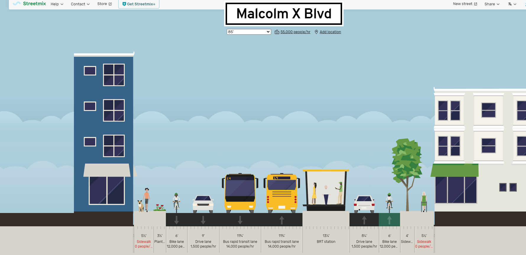

Phase 1 - BRT on Malcolm X Blvd
With an 85' width, Malcolm X Boulevard could be completely reimagined as an urban boulevard that prioritizes mass transit, walking, cycling, and micromobility, while still maintaining one through-lane for autmobiles (with turning lanes etc in between BRT stops).
These center-running bus lanes would serve the T15, T23, T28, T66, 19, 38, 41, and 45. They would improve service, expand ridership, and serve to further normalize BRT elements in this area.

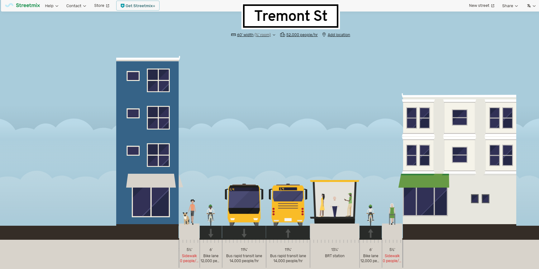

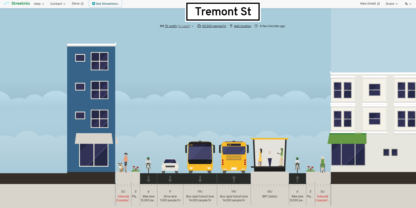

Phase 2 - BRT on Tremont St between Malcolm X Blvd and Huntington Ave
At it's most narrow within this section, Tremont Street appears to be about 60'. I'll take a page out of the Western Avenue Corridor Study. Here's what I'd propose:
Continue with an approximation of the above road design to Parker St, where the road narrows. The westbound automobile lane becomes a right-turn-only lane onto Parker St.
Between Parker and St Alphonsus, there is only eastbound automobile travel:
To remove conflicts:
  • Closed to automobiles:
    • The alley entrance behind 695 Parker
  • Re-route automobile access via Smith St:
    • Faxon St
    • Tobin Community Center parking, alleys, and deliveries
    • Parker Hill BPL parking, alleys, and deliveries
West of St Alphonsus, the street narrows further, with no private automobile access retained:
  • 1575 Longwood's driveway retains automobile access via Worthington St, but not Tremont
  • South Whitney St closed to automobiles
  • Worthington St becomes a two-way dead-end that dead-ends just north of Tremont
  • Torpie St closed to automobiles
  • The Shell at 1600 Tremont get purchased by the city for redevelopment
  • Wigglesworth St becomes a two-way dead-end that dead-ends just north of Tremont
  • Automobile access to the alley between 1631 and 1625 Tremont is rerouted to via Wigglesworth St and/or Hungington Ave
These center-running bus lanes would serve the T12, T22, T28, and T66. They would improve service, expand ridership, and serve to further normalize BRT elements in this area. They would also dramatically improve the human experience on Tremont Street, improving urban living for Mission Hill's residents.

If I were god-emperor, this would be my preferred phased approach:
    • Faxon St
Phase 3 - BRT on Francis St between Huntington Ave and Brookline Ave
I didn't do a deep dive into street widths here and what modifications would need to be made. Compared to Tremont St, seperated cycling facilities should be de-prioritized in favor of retaining automobile access, while still prioritizing BRT first and foremost.
These center-running bus lanes would serve the T12, T22, T28, and T66, as well as emergency vehicles.
Combined with the bus network redesign, there would be much better mass transit connections between LMA and:
  • Mission Hill
  • Roxbury Crossing and the Orange Line, so therefore:
    • Jamaica Plain
    • Downtown Boston
    • Chinatown
    • Charlestown
    • Somerville
    • Medford
    • Malden
  • Roxbury
  • South Boston
  • Dorchester
  • Mattapan
Phase 4 - BRT on Brookline Ave between Park Drive and Brookline Village
A relatively wide corridor that accomodate a variety of modes. These center-running bus lanes would serve, over various segments, the T12, T28, T47, T66, 60, 65, and 85.
Combined with what's described above, there would be much better mass transit connections between LMA and:
  • Brookline
  • Allston
  • Fenway
  • Cambridge
