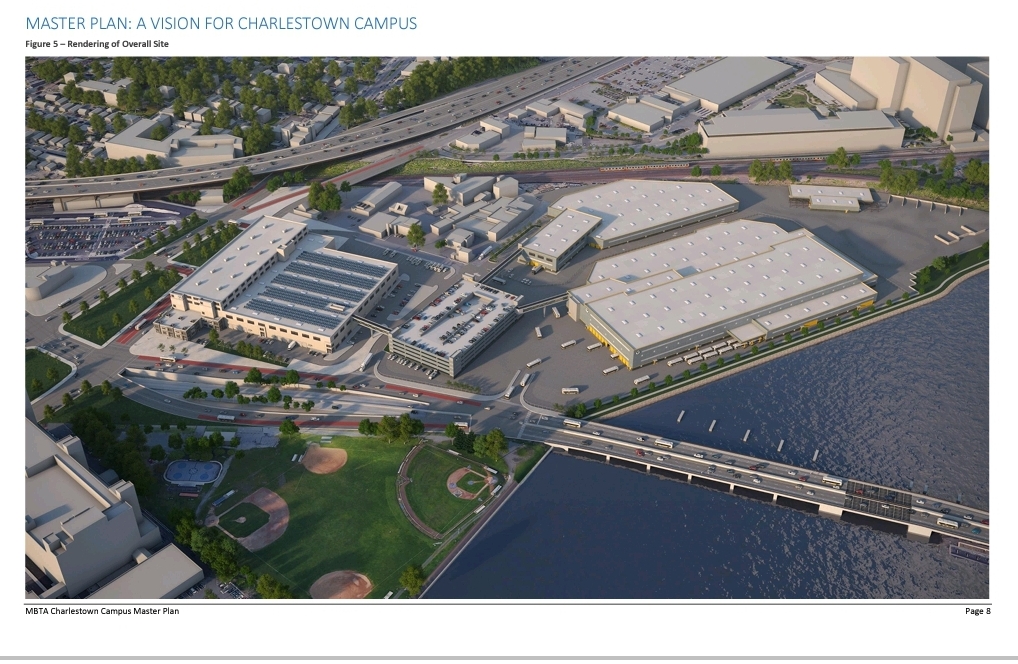

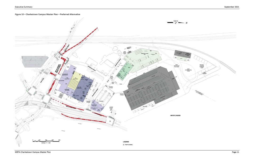

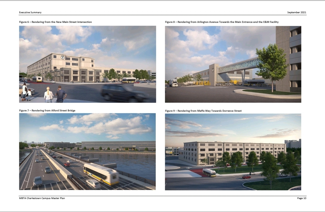

In other bus news... It looks like the MBTA very quietly published a master plan for it's Charlestown Facility (pdf) back in September 21. Tentatively planned to be the last major bus facility rebuilt in 2036-2038 at a total cost of $1 billion, design to begin in 2026-2028. it includes provisions for relocation of MBTA headquarters out of the State Transportation Building to here, locating office uses to the "front" of the site to be part of the streetwall with Sullivan developments. Full plan requires road takings as well as 2 private parcels in addition to overall raising of the site out of the floodplains.

What is it with the MBTA and having weird outlying headquarters locations? They were at 500 Arborway for a while, finally moved into the centrally located STB, and now they want to move back out onto a radial line?
This just feels disjointed and an all around poor integrated design effort...
1. Why orient a giant blank wall nearest the water? Flip the 2 buildings, and turn 45 along the tracks.
2. Why have the primary bus entrance continuing to disrupt the merge of the underpass, when you have the opportunity to improve existing traffic flow?
3. Why not adjust the new harborwalk to properly connect paths?
4. If they integrated the parking lot into the building and leased out a commercial property in the open space, it would pay for half the project.
Not saying these are good answers, but:
1. Why do they care? The water has no abutters and they put the more pleasant looking buildings near Sullivan/actual neighborhood frontage. Swapping the E&M MOW building with the bus garage would be even uglier if that's what you're saying, it'd be like a junkyard along the river. Arguably the "wall"-like nature of the bus buildings is a feature - it blocks the view of the much messier facilities behind it.
Additionally, you'll note in the phasing that they're looking to do the engineering and maintenance in 2026-2028, no changes to the bus facility at that time. They're not going to have the money for the bus portion for another decade after that. Rebuilding in place/limiting construction disruptions to existing bus operations is likely a consideration. Flipping buildings around would require doing the whole thing at once.
2. Lets the buses use the underpass, which is probably helpful to reliability. This would be a full signalized intersection, so they'd also be able to use it Northbound as well, unlike now. If it only triggers for buses/pedestrians I assume it won't disrupt much.
3. I imagine they don't want to give up a single foot more of their property than necessary for the Harborwalk. There might be some design considerations with the seawall.
