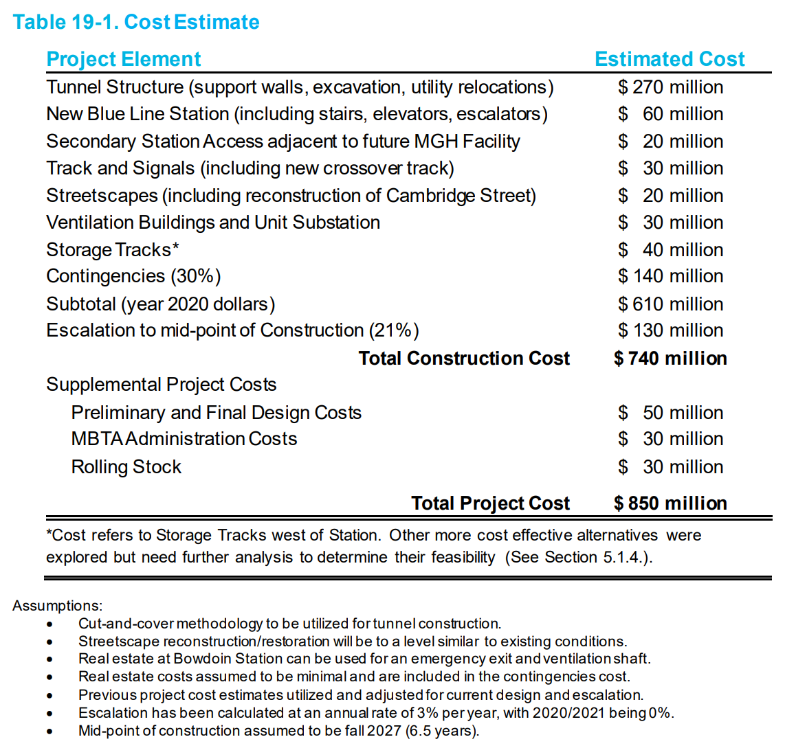

Random thoughts: How much do we trust the most recent estimate of $850 million for Red-Blue?
While this figure was quoted most recently in 2023, it actually came from the 2021 Concept Design Report, which was from the Baker era. The estimate does assume cut-and-cover, but still: could the costs have been overestimated with the intention of sandbagging or even killing the project, typical of the Baker administration?
There's no rolling stock costs associated with this. It's a 1-for-1 replacement of terminus stations that won't increase the number of trains needing to run on the line to maintain current headways. Rolling stock replacements/augments are part of Blue Line Transformation budget bucket, not this.
That and the contingency seems awfully large.
Also why wouldn't MGH be chipping in, especially for their own station access?
I’d certainly support MGH donating to this project, but I think it sets a bad precedent. The state is the entity that should be funding adequate transit to a major hospital in the urban core of the largest city. If funding mechanisms need to change to make that happen, so be it, but it’s a fraught path to rely on one-off donations from private institutions for public transportation.
I don't necessarily disagree with the sentiment, but haven't there been a whole bunch of precedents already of stations / station entryways / head houses funded or partially funded by developers of enclosing or adjacent structures? OL head house at Millennium tower (Millennium Partners); RL at 325 Main st. (Boston Properties) in Kendall; RL across the street at Kendall (MITIMCo); BL/OL entry that's part of 53 State St; GL new entryway to Hynes via the Parcel 12 project at Mass Ave (Samuels); the proposed (if it ever happens) GL entryway to Hynes via Parcel 13 (Peeples)...
I am not worried in the case of RL/BL connector; the MBTA is paying for the vast preponderance of the overall project, while MGH's modest contribution, quite frankly, probably just makes it easier to coordinate construction scope/management with the rest of their enclosing project. Public-private partnership becomes much more of a problem when the private entity buys their way toward a controlling stake in a project such that the direction of the project is shaped more by them than by the public entity; we're no where near that in this case.
EDIT: Also, the $20M plug for "...access adjacent to future MGH facility" (above) honestly might just be a placeholder to reflect the fact that at the time this estimate was made, people did not know of the exact sequencing of the work. Think of two examples where the MBTA themselves built head houses that literally got swallowed into commercial buildings at a later date: a North Station entryway got swallowed into the Hub on Causeway podium building, and in the Seaport, a Silver Line head house got swallowed into the Yotel building. Those were cases where the head house got built first before the private the developer was ready and the MBTA ostensibly foot the initial bill for it. Here it seems clear that MGH ended up way out in front of the MBTA in terms of getting their building built, so it could be that MGH ends up "donating it" out of the sheer sequence of things. Could MGH chase the T for money for it? Maybe...but would they really do that / do we really expect them to?
