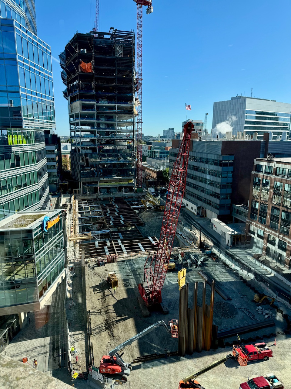

Thanks for the rendering. (Couldn't find mine quick enough). Confirms up/down construction here. Build the slurry walls and sink footings. Then steel can go up while you simultaneously dig out the dirt and build the garage downward, with the slurry walls and footings supporting the steel structure. The Akamai building was put up the same way.
