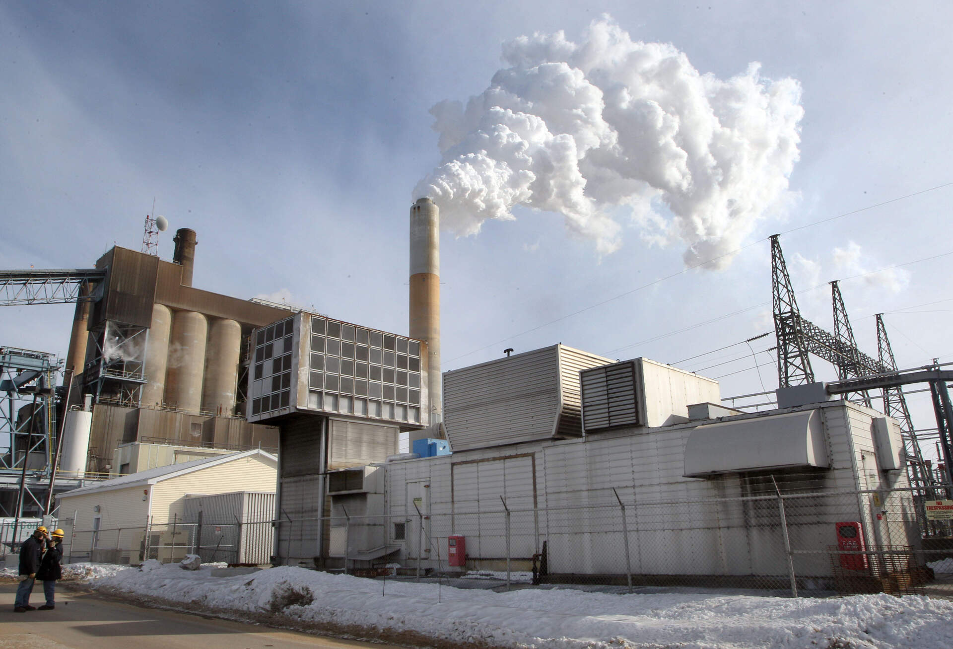

In other power grid news, the last NE Coal plants now officially have shutdown dates - Merrimack will close no later than Jun 1 2028 and the Schiller Plant will end its use of its coal boilers by the end of 2025 - They'll become solar anad battery parks.
