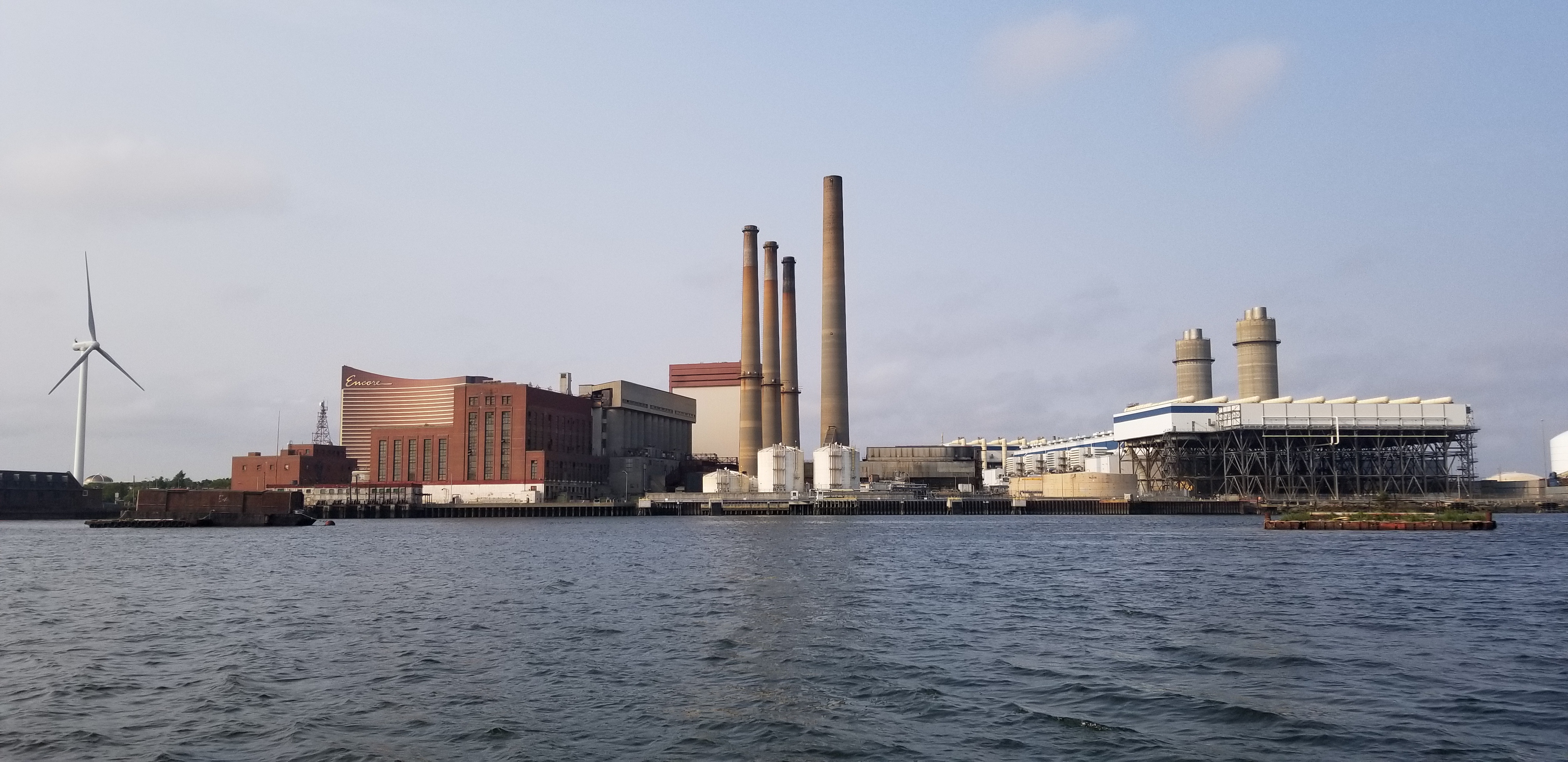

Eversource today purchased the remaining Mystic Station site for $70M including Units 8&9, but not including the LNG terminal. While the article notes 8&9 will likely be demolished, it likely indicates that this site will remain power infrastructure for the foreseeable future, though Mayor DeMaria is apparently already opposed.
Eversource is already in active conversation with Jupiter on building the battery farm. This is a strategic move and not the worst from a grid reliability standpoint. Still sucks to give up waterfront property, but the site isn't a bad investment for a utility in transition. As an IOU in a deregulated state it can't bid into markets, so the plant won't operate.

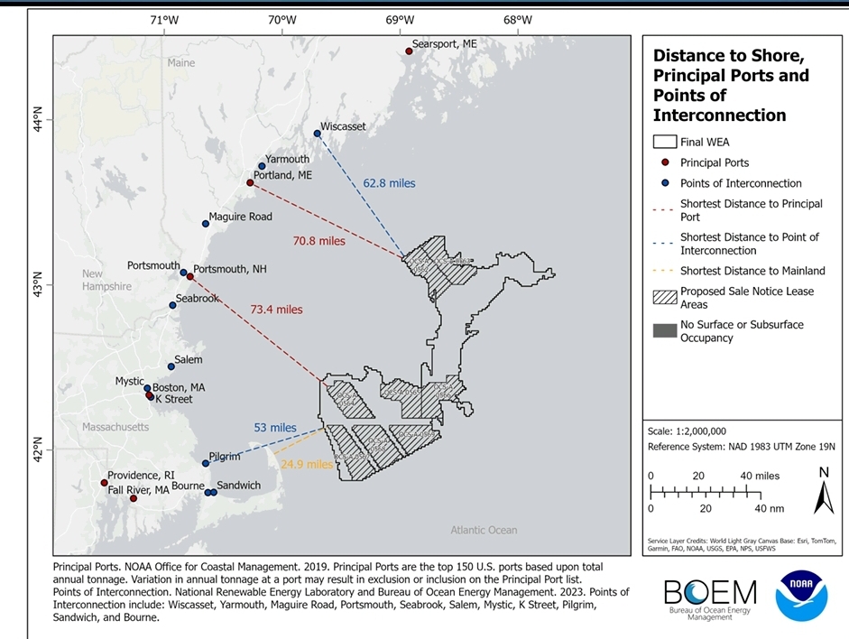

Given the strong grid interconnection, this is a great location to land future offshore wind power transmission cables. The more offshore wind we build, the more interconnect points we will need. New Bedford and Salem are great, but not enough grid interconnect capacity for all the wind power that is on the drawing board.
Mystic is a 2 GW interconnect point. New Bedford (Brayton Point) is only 1.5 GW. Salem is less than a GW.
Honestly I'm not too sure. Mystic would most likely be a potential landing point for the newest offshore lease areas in the Gulf of Maine, which had its first leases awarded by BOEM in October, but there are some notable obstacles around here which to me means it would be a very long term play.

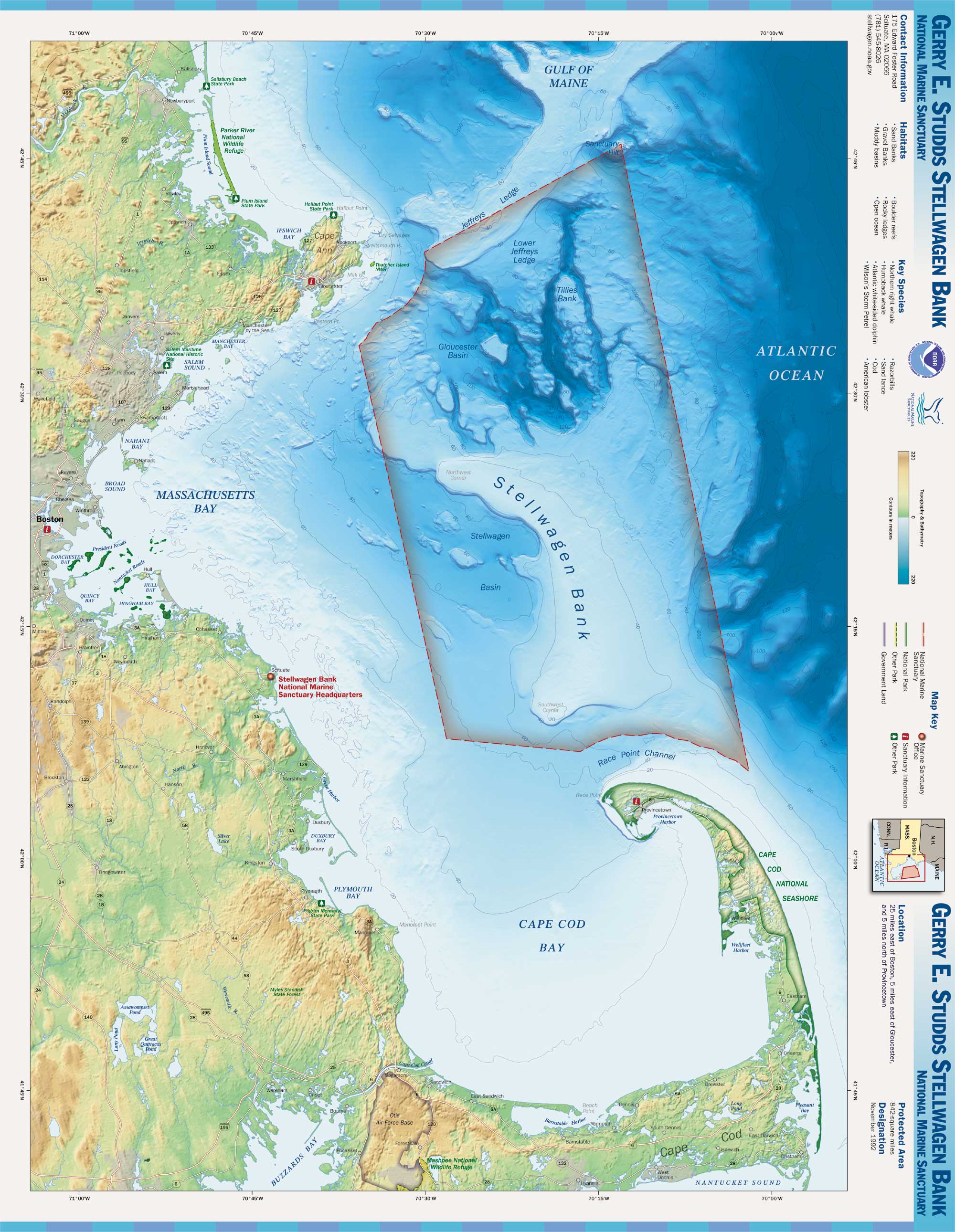

Firstly, there is the fairly major issue of the Stellwagen Bank. Not only is it a national marine sanctuary that may not be possible or prudent to law cable through, it also presents some challenging geography. You could go around it, but that presents other options.
Unlike the south shore, there are more landing point opportunities around here, that may well prove simpler than Mystic - the former Pilgrim and Maine Yankee nuclear stations, the Wyman plant, Schiller Station ... Those together have 2.2GW of interconnect capacity based on their nameplates. Granted, the lease areas they announced in October have a total potential of 6.8GW, and the total area 15GW, but there's also several currently operating stations that could be future landing opportunities.
Mystic is the single largest coastal interconnect point in the region. The capacity planned offshore is going to need that interconnection point (at some point). Routing around the Stellwagen Bank is necessary, but not impossible. (I also grant it is not going to be anyone's first choice for landing offshore power, because of the cable routing complexity -- but the capacity will eventually get used. If you think accessing Mystic is hard, try getting a de novo major interconnect site permitted on the land side.)
