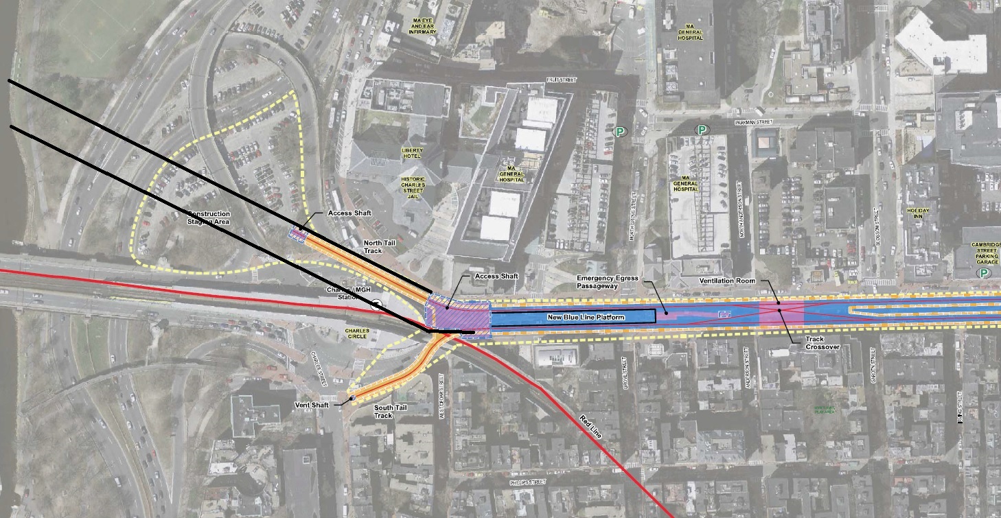

Extending Blue past Charles/MGH is def crazy. Is there tunnel room to extend Blue just to Kendall? I am guessing no but thought I would ask.
Placement of the Red viaduct pilings means the Blue platform will be a wedge shape with single tail tracks forking off in both directions around Charles Circle: one tail dead-ending in front of "Hotel ex-Jail" and the other at the corner of Charles St. in front of CVS. Meaning extension either banging a left under Storrow or banging a right under Embankment is fully feasible. That's accomplished 1 of 2 ways:
  1. Double-wideing the tail track for the chosen extension direction to 2 tracks and adding a side platform to complement the wedge, then downgrading the other tail to pocket storage and short-turn abort. Advantage for straighter trajectory and ability to accommodate short-turns, disadvantage for modding the station into a messier-overall platform setup and the need to reopen a few feet of completed tunnel (only in immediate Charles Circle, west of Lindall Pl.) for widening.
  2. Extending 1 tail track in the straightest prevailing direction of extension, then wrapping the other all the way around in a near-loop behind the first set of Longfellow salt-n'-pepper towers at nearest available safe underpin point. Advantage for keeping the platform entirely stet, no new construction touches to any completed Red-Blue tunneling, and possible ability to throw down switches where the tracks meet on the other side of the circle to (a little less fluidly than #1 ) accommodate short-turns in a big de facto loop back to the platform. Disadvantage of the big loop-around being a bit slower and becoming the #2 ruling Blue curve after State (though that only matters if you foresee long-distance running past here).
No bias in east vs. west directions...both are equally feasible. Jumping across the Charles for Ari's Volpe basement plan would be happening down by Ebersol Field to line up with with the other side, so that's a "bang a right" scenario. Kenmore under the Storrow trade-in set of circumstances is the prevailing "bang a left" option. Of the construction methods, I think #2 is probably most palatable for the lower impacts as the 1-track distended loop-around is only going to temp tear up some low-use parkland that's already been torn up and replanted once for Longfellow construction staging.
The problem with "Blue to Volpe Basement" staging is...Volpe Basement. Redev over there is happening so fast there's going to be no insertion point left that isn't blocked by new building massing. Ari's scheme had some logic on the demand side, but did not take into account that time isn't standing still on land availability (in addition to being mum about the above-and-beyonds of doing this vs. the surface Urban Ring). That's mainly where it gets ruled infeasible. It's inconceivable that there'll be an open path left in 15 years, and since no one has ever formally pitched this as an alternative to the UR nobody redevving Volpe has ever been forced to consider the implications of reserving a ROW through their massing. And why should they have when the Urban Ring has gotten all the data backing to-date saying it's plenty good enough transit augmentation to make their employment center the richest it can be.
As described before, the only not-crazy scheme is IF we come to a regional consensus on tearing down the Pike-redundant Kenmore-Charles Storrow midsection in favor of reclaiming parkland, and IF the terms of engagement for that decision is a transit trade-in capable of moving equal number of people. In which case the EB carriageway roadpack and Back St. retaining wall can frame a shallow box tunnel sticking 2-5 ft. above ground level akin to the bit of Green Line tunnel at Hynes Station that's higher-elevation than the Pike; the tunnel can get covered over with dirt and act as slightly enhanced passive flood berm for the Back Bay street grid; 3-lane Storrow WB carriageway can be turned into a 2-lane slow-speed park access road; and Kenmore can be reached via diagonal-direction shield-under of Muddy River + cut-and-cover on Beacon + narrow-angle Brookline Ave. underpin of GL-Kenmore with tail tracks aligned to Brookline Ave. or bang-a-right under B&A for infinite-possibility 100-year future-proofing. But this ONLY goes on the board IF we first reach the consensus on parkway diet, and its momentum is entirely driven by the "equal or better" trade-in requirement. No other circumstance will put it on the board, and until the Storrow debate reaches any sort of cresting momentum (which it has not yet) this one is out-of-sight/out-of-mind and Charles is the only thing we care about. Further, any possibilities past Kenmore would be out-of-sight/out-of-mind until that extension is complete (IF and ONLY if the Storrow debate that comes first leads there), simply because the trade-in clause would be constrained to the same project area as the Storrow teardown and purposefully would not encompass any outside considerations. So it's very discretely chunked even in terms of "how far past Charles?" should controlling circumstances put it on the board in the first place. Unlike other imagination doodles, this one is very constrained in the where/when/how of what goes up for consideration at what time, so it's important to preach discipline in how far we're getting ahead of ourselves. Even the sequence of events that puts Kenmore up for debate is wholly unlike the normal process of hashing through those debates on all other linear extensions in the region.

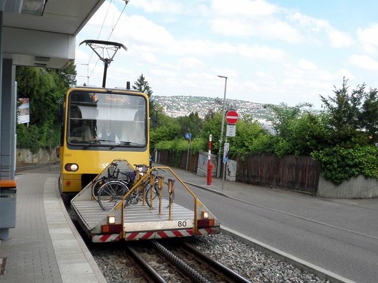

The light rail system in Stuttgart, Germany, uses these things to allow commuters to take their bikes on board:
If we could work out the obvious switch-picking problem, could something like it work on the Green Line?

That German pushcart example...that's the Stuggart Rack Railway funicular line, not their regular LRT system. The Rack Railway is a tourist attraction transporting visitors up and down a mountain, not a mainstream transit flavor. The wagon is anchored to the center rack rail, and because of the tourist attraction holds many more bikes than you'd ever see on a standard transit vehicle. Such a setup is illegal and impossible on any regular LRT setup, because a free-movement trailer that lightweight can derail on something as small as one rock of trackbed ballast sitting on the railhead. For example, when the Green Line work shift has to task a Type 7 with towing a flatcar to a work site, it runs at severely restricted speed...and that's with a trailer that weighs 1-2 tons empty (though still an order of magnitude less than the trolley itself). The only place in New England where you could run a wagon contraption like that is Mt. Washington Cog Railway with its similar gear-toothed rack rail.
Further, while buses have long been standard-issue ordered with fold-out racks for 2-4 bikes attached to their front bumpers, such an easy solution is impossible with trains that couple together. You couldn't have one of those fold-out racks unlocked for business sitting on the leading end of a Green Line train because of rescue-tow contingencies should the train get disabled. Exterior solutions are practically verboten because trailers are no-go, front/rear racks are no-go, and side racks are obvious no-go for tunnel clearances. But then again...absolutely no need to overthink the exterior solutions when every single wheelchair berth inside every single vehicle is a blank canvas for doing up any number of $cheap$ and low-profile combo rack solutions.
