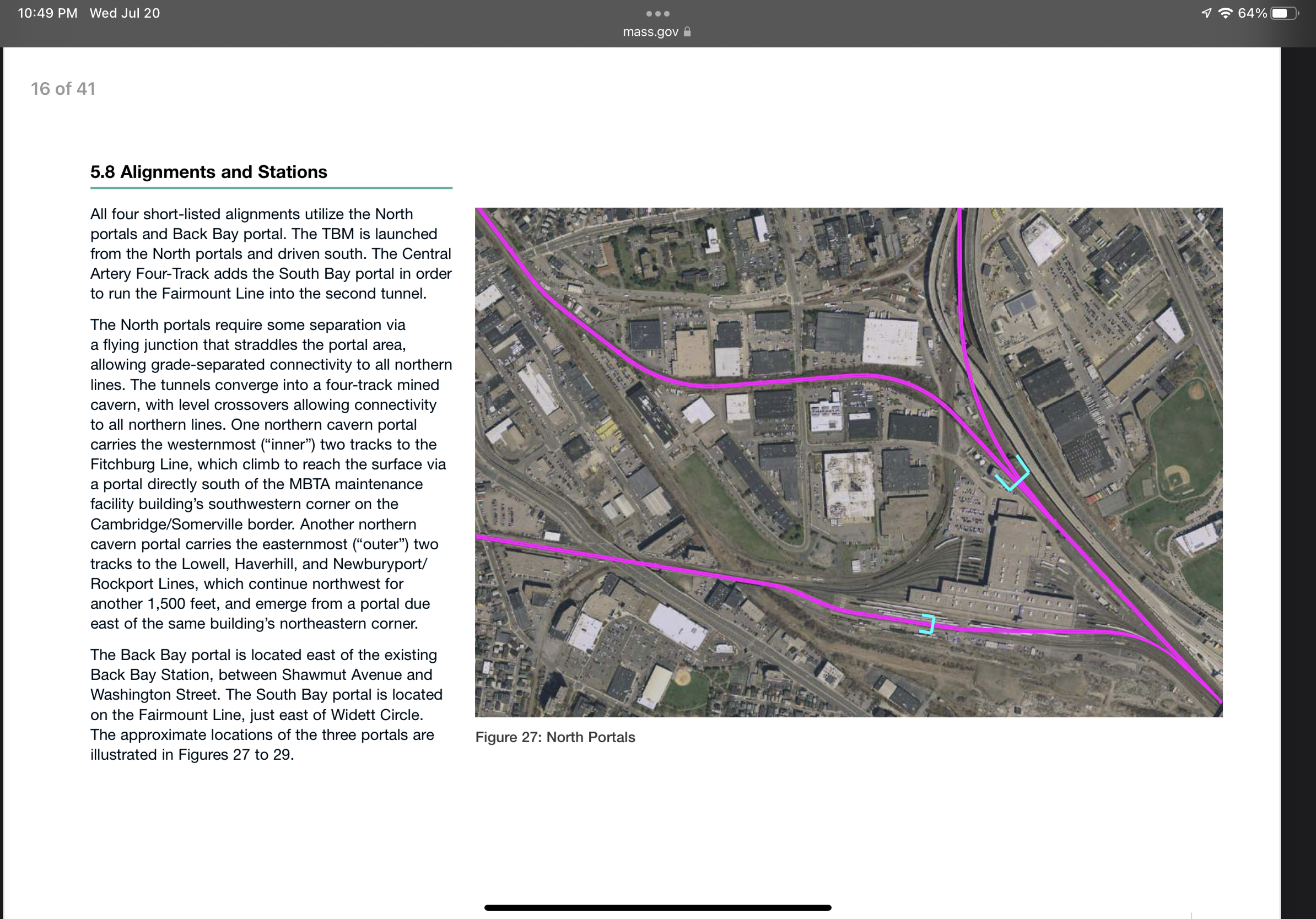

$1 million for NSRL design study in latest transportation bond bill. Anyone know what this study would uncover that previous studies haven’t? Or is it just a chance to un-sandbag the previous study?
I’m pretty sure the last study proposed the Northside portal to be where Cambridge Crossing is now, so I’m curious where the new proposed portal placement would be.
Thought the portals were supposed to be in the vicinity of the Engine Terminal near the Fitchburg split, though there've been eight million proposals with different levels of sandbaggery so I don't know specifically where that came from.
You’re right, on second thought I might be recalling the idea of using CX as a staging area. Maybe they could use a lot in Brickbottom. Since the name of the last study was ”NSRL reassessment“ maybe they’ll call this one the “rereassessment”.
