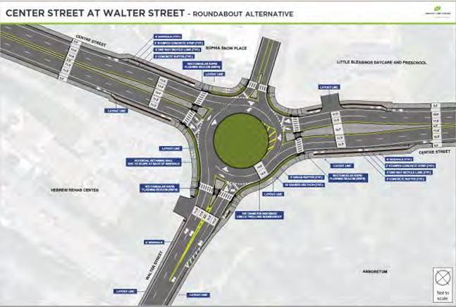

[T]hey could reduce the lane width, remove a lane, or add a rotary (which they claim they cant do, but any European country could easily fit a rotary into this space).
It's interesting that they are now saying this, because a rotary was one of the three initial design alternatives back in 2020:
FYI, for MassDOT reviewed projects that involve potential signalized intersections, the state often requires a roundabout alternative analysis. There pros and cons to be weighed in doing so. Limiting factors typically include available real estate (right-of-way), site grading and design/construction costs.
And the warrant analysis for proposed traffic signals are explicitly laid out in the MUTCD. You have to meet a specific criteria.
All I can say is, the criteria are wrong. In the UK, this would be a rotary. This intersection is scary and dangerous right now, because cars drive 50 mph through it. It's also high volume and is a major left turn need which adds additional reasons why a rotary would work best. Adding a stoplight is going to cause horrendous backups for the left turn onto Walter during rush hour, and otherwise only going to cause drivers to floor it when the lights are green.
The goal of every single traffic project should not be to make driving difficult, or to make any form of movement stop-start. It should be to make movements slow and smooth, especially driving. Rotaries do this; lights do not.
Building on his point, MassDOT's intersection control evaluation (ICE) process favors roundabouts heavily. They will default to it whenever possible precisely because they agree with you. One can take issue with the criteria, but not the intent.
