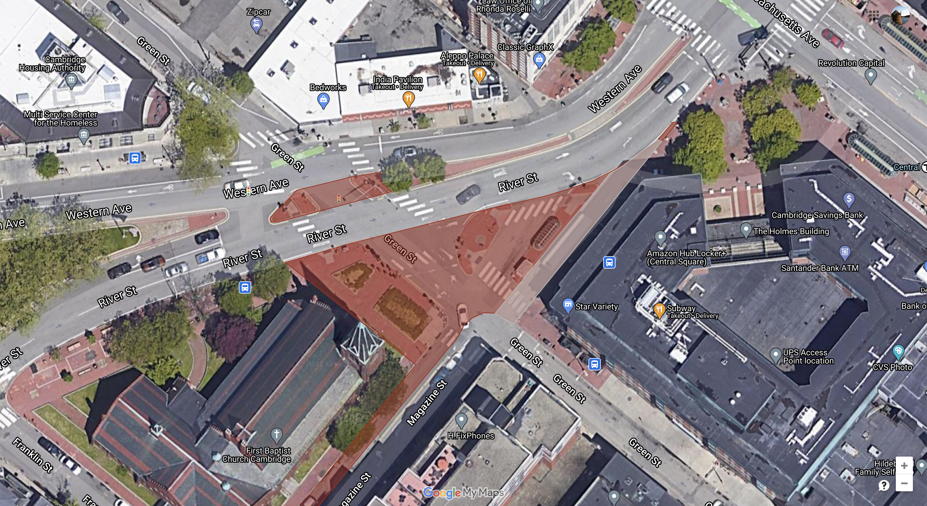

But perhaps a more modest proposal like this, where a portion of Green and Magazine are given over to form a sizable plaza, could produce similar benefits while keeping the major through streets open. The northernmost block of Magazine would have street parking removed, but continue to allow two way traffic. Westbound Green traffic would turn south and northbound Magazine traffic would be restricted to MBTA busses. The current bus stop would continue to exist, but would be raised to the same level as the sidewalk, so that the plaza feels continuous. Also, the islands between Western and River could be connected to offer a bit better pedestrian connectivity, but this is probably optional.
For this to be successful, I think the city would want to push the property fronting the new plaza to install more active uses on the ground floor (currently Amazon lockers, an eye doctor, and a convenience store). Outdoor dining could definitely be a success here.

The one problem I see with this layout is that currently WB Mass Ave traffic wishing to turn left onto River Street uses Pearl and Green Streets . If Green Street is blocked off then that left turn would need to be made in the intersection of Mass Ave and River Street, a tight area and requiring an additional traffic light phase for a left turn.
Also, Isn't there substantial bus boarding on Green there? I think that is an important layover point for a lot of Central Square buses.

The city is considering something similar, though, not as expansive for that part of Central Square. https://storymaps.arcgis.com/stories/239734a5042d45d693c18bab6f7f60b6
Restricted traffic on the short block between Magazine and River Street with one-way traffic on Magazine Street from Green to Franklin.
Woah, awesome, I had no idea this River Street redesign was in the works. Fun to discover that something resembling your Google Maps sketches is in fact just months away from reality.
Great to see that the entirety of River Street is getting a bus lane and protected bike lane. Kudos to the team behind that for being able to find the space on a pretty narrow street.
I still think the Carl Barron Plaza redesign would be greatly benefitted by extending it all the way to the First Baptist Church. Busses on Green St that are turning left onto Western Ave could instead turn left on Magazine St, and get over to Western via a redirected Auburn St. With that change, I don't think there are any other blockers preventing a much larger plaza. Still, the current redesign is a considerable upgrade from the status quo.
The concern I have about extending the Carl Barron Plaza is fire engine and bus access. Green Street is an important tie-through for these.
Maybe they could raise it and blend it into the plaza? Bus traffic might be heavy enough that it wouldn't typically be empty, though.
buses also need a curb to load and unload passengers - in normal times those bus stops are pretty busy.

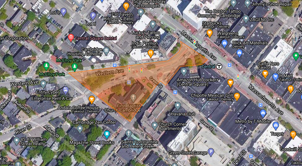

All quite true. So taking all factors, variables, criteria, and stakeholders into consideration, for the triangular wedge of land bounded by Western Ave, Auburn St., and Magazine, with the apex at the quadruple Western/River/Magazine/Mass. Ave junction--with Carl Barron Plaza included at its northeastern edge.... what should be the relative spending allocations/ratios in terms of social services interventions vs. street/plaza reconstruction/renovation, over the next 0-X years?
It's a pretty compact swatch of land--just over 4.5 acres. Carl Barron Plaza is only 6,700 sq.-ft.
