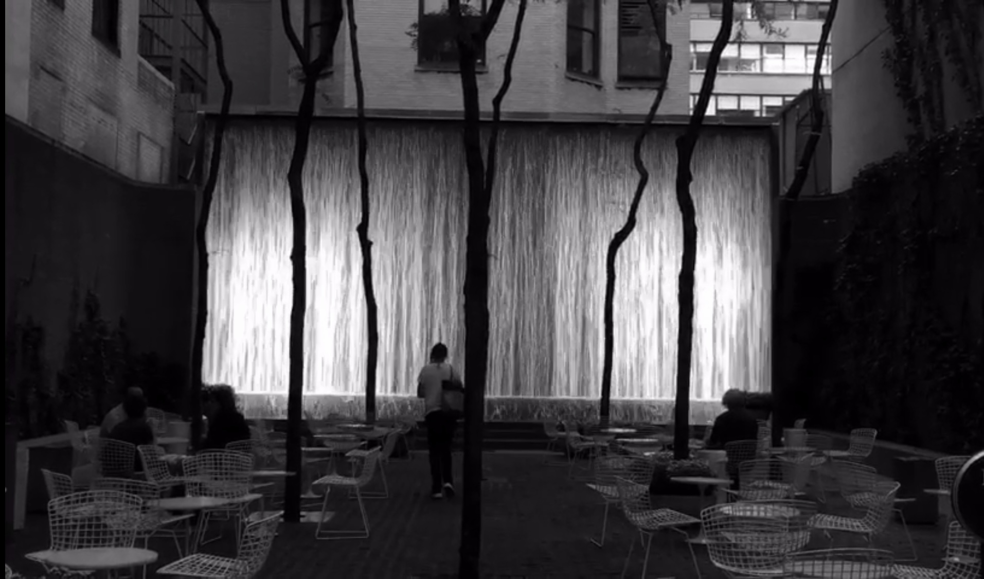

looks great... Waterfall would add additional essence...

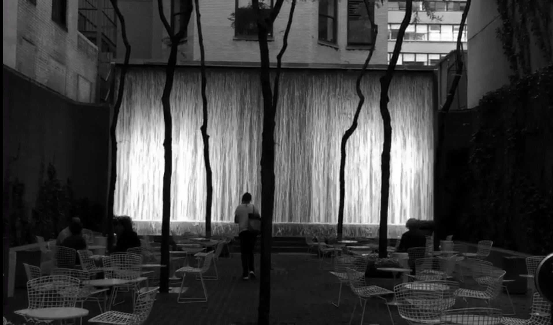

Future Home of 200 Federal Street - Pre-Construction by Corey Templeton, on FlickrBeautiful! What a lovely picture. Thank you for sharing this! ~ CCI love Paley Park in NYC. This first time I saw it 5 years ago I couldn’t stop thinking how perfect a waterwall feature would be for Portland. I wish you good luck and hope you make this happen. View attachment 11581

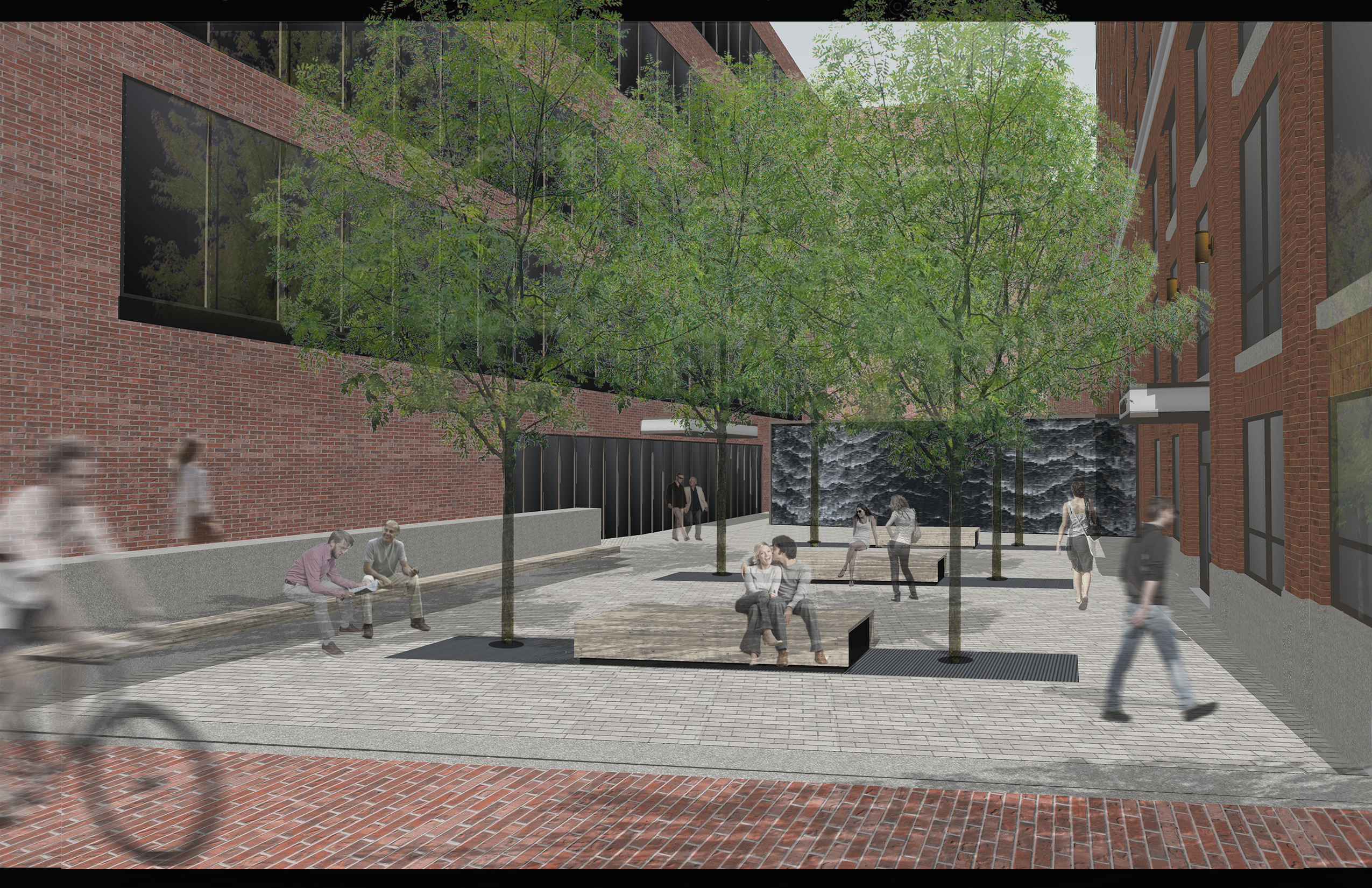

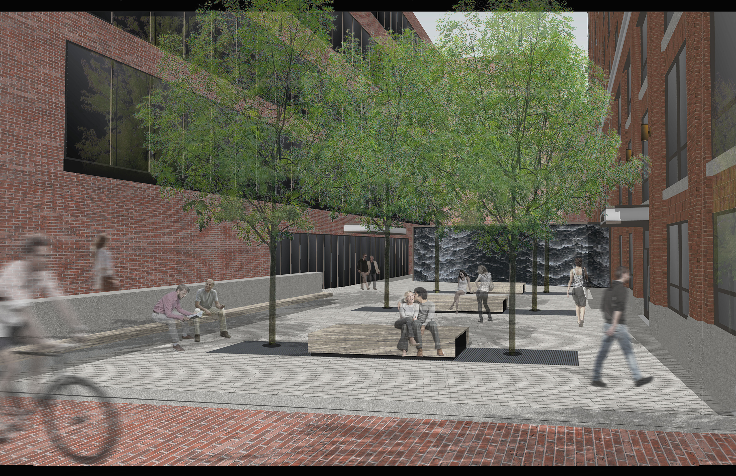

Thank you! The trim is actually a champagne color...I think this is meant to be an evening reflection which is why it’s kinda blue. Have a few more but we are tweaking! ~CLove the brick color, very similar to the Canal Plaza buildings. The blue trim really pops, more photos Catherine![]()
View attachment 12211We are working on the pocket park after feedback from planning board. They didn’t like our “desire lines” - new term for me. Having a bit of a philosophical difference of whether park should be a pass through with direct path across it to the post office door or a prioritize seating. I’m pushing to prioritize seating.
Thank you!Really liking these new renderings. What's going on to the right of the entrance on Federal St? In earlier renderings it was windows and a large maintenance door now it looks like brick and a couple of man doors.
Definitely prioritize the seating - I wonder how much that entrance will be used once the building is in and parking is less convenient.
Moveable cafe and tables are part of plan and need to be dropped back in. What we did was try to create the desire line visually by removing the bench in front of door but didn’t feel like we need a direct walking path straight to the door - they requested we remove the middle bench but I feel its small enough to meander. The purpose is to meander! Slow it down a bit. ~CWhat about a "yes, and..." rather than an "either or..."? Seems like one could prioritize seating AND have clear 'desire lines' thru the space by incorporating more small cafe tables and chairs, which are more permeable to walk thru. Cafe tables and chairs offer many more seating arrangements than long, linear, fixed stone benches, and can't be used as a skateboard play-set when not occupied. People are more drawn to spaces with tables and chairs because they can eat or work on a laptop, etc. If park users can move the furniture around a bit, we really find out what the true desire lines are.
But now I’m thinking maybe we should make it all cafe tables in chairs....good food for thought. ~CMoveable cafe and tables are part of plan and need to be dropped back in. What we did was try to create the desire line visually by removing the bench in front of door but didn’t feel like we need a direct walking path straight to the door - they requested we remove the middle bench but I feel its small enough to meander. The purpose is to meander! Slow it down a bit. ~C
doors you see are to bike room
