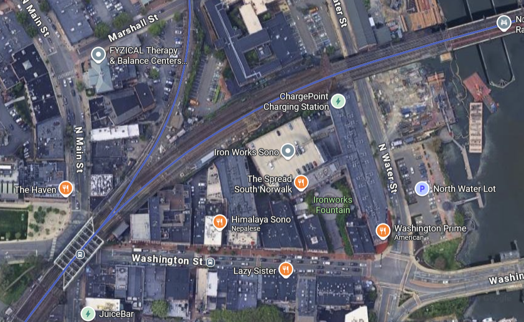

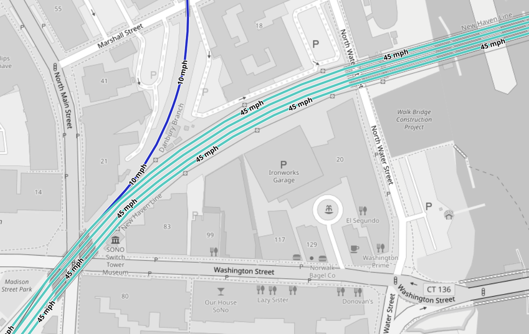

That immediate adjacent curve in/out of South Norwalk station is 45 MPH-restricted in a 70 MPH zone, so eastbound trains will be going no faster and the signal system will be automatically slowing westbound trains from to 45 while they're in-process of going over the bridge. Since the curve is in an extremely built-up area, there's no way of easing it to allow higher speeds. Therefore it would've been a waste to do a bridge design speed higher than that.
Looking at the 45 MPH curve just west of the Walk Bridge, the existing geometry seems like it could allow higher speeds. Let me start with a caveat: I did not measure this curve to determine the exact geometry, so this is mostly speculation. But the current geometry appears roughly as sharp as existing 70 MPH curves. Also, the curve can be extended over a newly rebuilt Walk Bridge to further smooth it out and raise speeds. That adjustment would require shifting the current 45 MPH track a smidge to the south, but as you can see below, that is almost entirely industrial land or part of the existing ROW. I have also been given the impression that Metro-North does not superelevate their tracks quite as much as they could, but don't know the full implications here.
Part of the reason that MN doesn't superelevate to the full potential is because the track centers are too close together. The Bridgeport-Stratford project is increasing speeds while maintaining the same curve by increasing superelevation, which requires increasing the track spacing(~12.5 to ~14.5ft). In the Norwalk case, its also hard to superelevate tracks in a junction.
