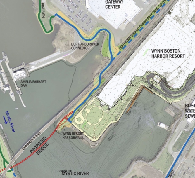

Am I understanding correctly that the proposed landing location for that on the north side of the river is the former commuter rail / freight bridge alignment, and so MassDOT and the MBTA (who are listed on slide 16 as stakeholders involved in this process) have apparently decided that they are committed to never building a replacement commuter rail and freight bridge on the traditional (apparently better) horizontal alignment with the new vertical alignment that removes the need for a movable span, but they didn't bother to explain that decision to the public in slides? I notice they didn't bother to include CSX and Pan Am as stakeholders in this decision. Can we get a statement from the freight railroads about how they feel about closing that option off and how happy they are with the current bridge's alignment?
It's also interesting that they choose not to include the East Coast Greenway Alliance as a stakeholder. I was under the impression that the East Coast Greenway includes the Northern Strand Community Trail, and I don't see any plausible way that the East Coast Greenway routing would not end up including this bridge if it gets built. Of course, their ``Most direct route'' claim wouldn't hold for East Coast Greenway usage (but that's not necessarily a deal breaker; the East Coast Greenway's routing guidelines, last time I could find them on the website, claimed that most direct route explicitly isn't their goal).
And why do they think a Silver Line bridge is more likely than a Green Line bridge to actually get funded and built? (My preference is to get a new commuter rail / freight bridge built on the old horizontal alignment, then reuse the existing commuter rail bridge for Green Line maybe shared with bus and maybe with a bike path on the side.)
Also relevant is F-Line to Dudley's comment at http://www.archboston.org/community/showthread.php?p=229848#post229848
Look at Google Maps. The old Eastern Route drawbridge pilings and alignment are adjacent a couple hundred feet to the south, and there's a MOW spur on the Somerville side that's a remnant of the old ER mainline track. How this would work is you build a new fixed RR bridge on the old approaches, and put the UR on the existing bridge. The existing bridge has those steep grades and superelevated curve on it--mandatory slow zone because of the compromised sightlines, and murder on the locomotive engines (esp. the Everett Terminal freights) that wheeze over the top--because it had to be constructed that way to keep the old drawbridge in-service. The old alignment is WAY better for a non-curved and less speed-restricted bridge for RR service, even at much taller height than the old squat draw. A trolley or bus is much better at handling the grades of the current bridge (which is safely wide enough for buses if they install taller barriers). So...swap 'em. It matches up perfectly with the necessary track alignment for side-by-side RR and BRT/LRT, since the freight turnout to the terminal is on the south side of the ROW. No doubt it's expensive, but it's not totally the apocalypse with the recycled approaches shaving some not-inconsequential EIS pain and suffering off the top.

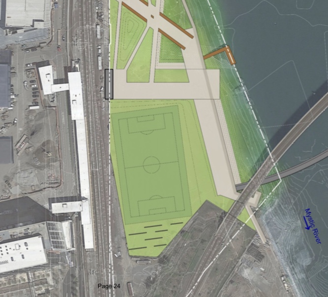

Option A for Draw 7 park looks pretty snazzy. Having a walking path around a soccer field on the water will become a really popular place to walk around for exercise along the new river walk.

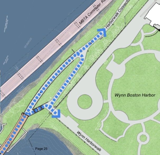

Methinks those renders are underestimating just a tad what wicked steep grades are going to be on that curved section. That's a LOT of elevation change between the slip-under of the Eastern Route bridge near Assembly and the navigation-channel peak. People are starting to kvetch about the Community Path kamikaze flyovers near Lechmere being awfully steep. They might not want to get a load of this until long after they've made peace with the GLX rampage.
