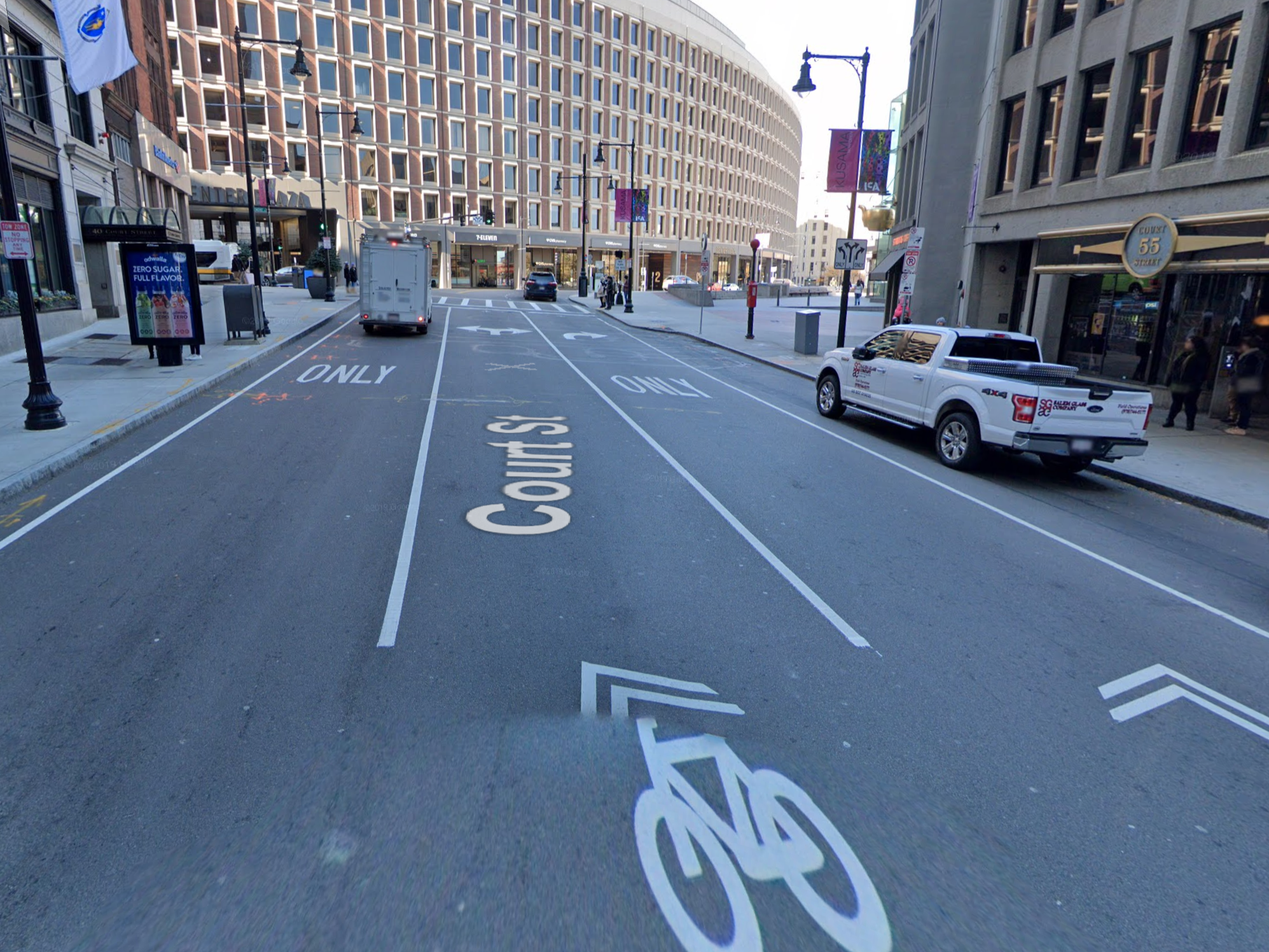

I have yet to understand the logic behind why they removed a quite nice planted median to draw on a giant yellow hatched area... It looked quite nice:
They extended the sidewalks on both sides of Court Street (left and right in your link), and the probably needed to demo everything that was in the median to do so. While the new painted area is roughly the same shape, it's much smaller in size. I agree that it would be great to not have a giant, unused expanse of asphalt though. My guesses as to why:
  • Any type of raised median would likely encourage pedestrians to cross there. Especially given that's where the crosswalks used to be - old habits die hard. Also the signal timing is quite bad for pedestrians and the new crosswalks don't necessarily correlate with pedestrian desire lines. Basically there's plenty of reason for pedestrians to want to cross there, and a raised area would make that more likely to happen.
  • While reconstruction certainly did some good (wider sidewalks, actually accessible crosswalks), it's definitely still not great. Much easier to continue to evolve the design (like with this restriping) if you're only dealing with asphalt.
Totally agree that there's many ways to make the intersection more appealing, but at least they seem to be utilizing some of the flexibility built into the current design?
all correct in the above post. The idea (right or wrong) was to shorten the crossings (through the wider sidewalks) and have 1 stage pedestrian crossings (the previous signal timings was 2 stages to get across, legally). Putting a raised median back in would encourage peds to jaywalk and cross in 2 stages. Of course, this being Boston, people still use the pavement marking gore as their 'protection' and do this anyway.

On the thread topic though, I was out at the intersection we're discussing at Govt Center and they've retuned the signals with a new plan that actually does a pretty good job of reducing delay significantly. By reducing the lanes on Court St they've made it so the through lanes on Cambridge can run at the same time as the turns on Court St, which is one entire less phase in the cycle, it's now just all vehicle movements, then all pedestrian movements. That should reduce delay significantly for crossing Cambridge St on foot (and in the grand scheme of things is actually good for all users including vehicle delay)
