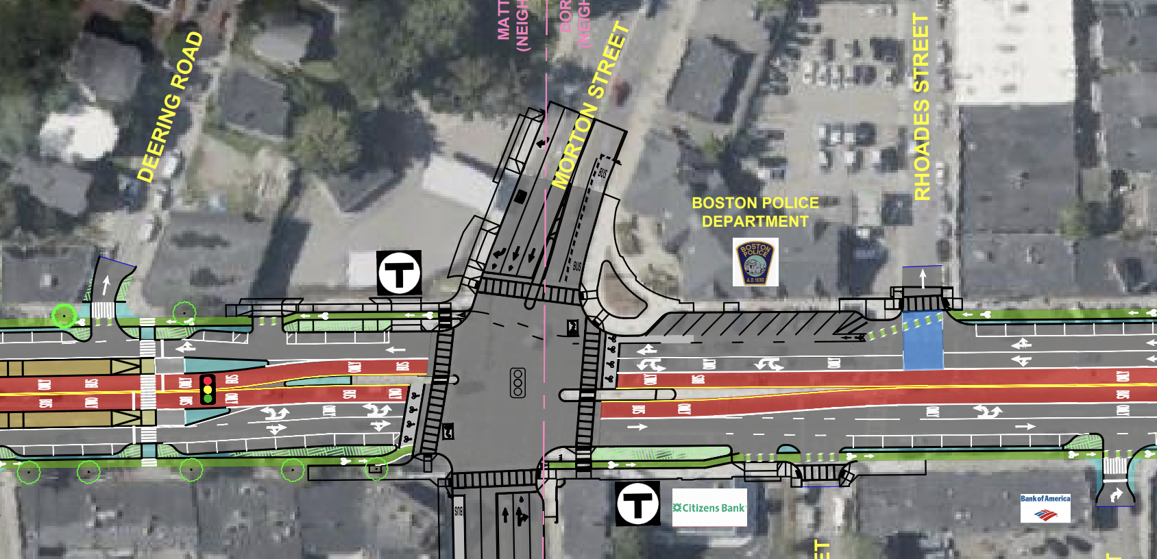

View attachment 57746There's a big dip in bike lane quality where Blue Hill Ave intersects with Morton Street: there are no protected areas to wait for turns, and bike traffic is made to share space with cars throughout the intersection. Also note the parking on the northbound side of the street that will obscure drivers' view of cyclists, and the southbound lane sandwiched between police station parking and moving traffic. It looks like there should be plenty of room here for a real protected intersection.

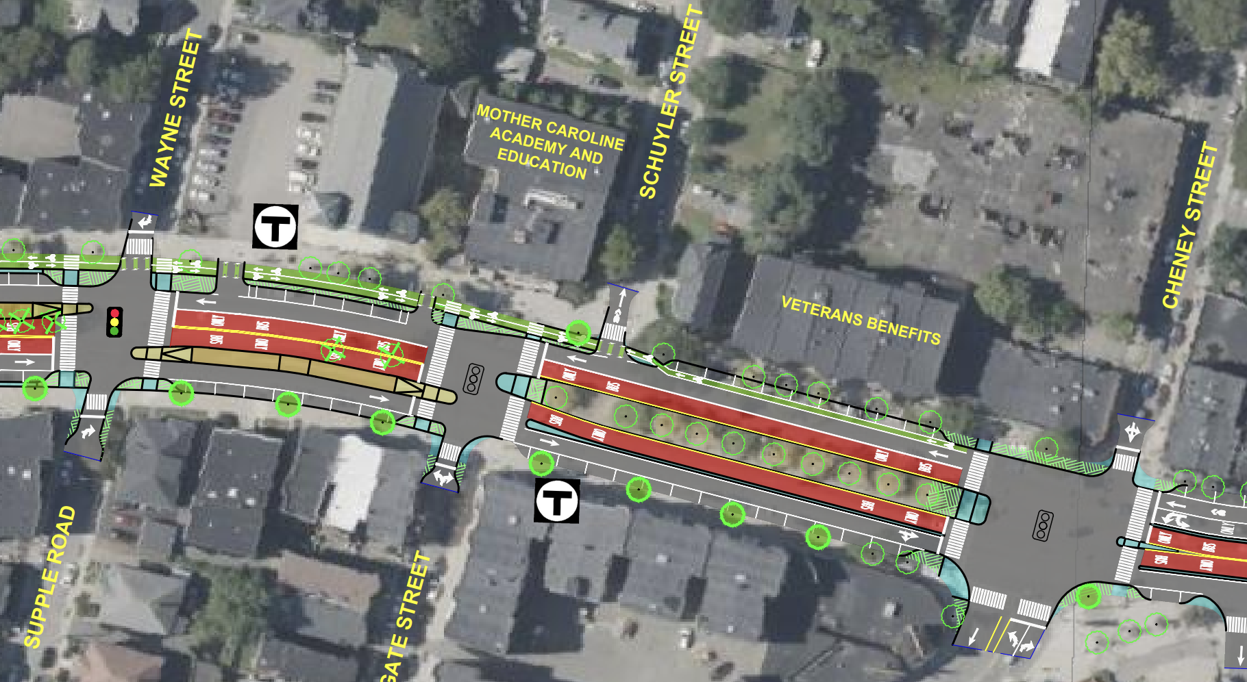

At the northern end of the project area, the northbound bike lane disappears abruptly at Schuyler St, with the bikeway transitioning into a one-way southbound door-zone lane. Without extending the lane to a major intersection it's likely that there will be a gap in bike infrastructure here for decades, without any connection to potential future projects farther north on Warren Street or Blue Hill Ave.

It appears they are not making major modifications to the Morton intersection as it was just reconstructed.
That's probably why they've proposed this design, but it still feels like a missed opportunity though in the middle of such a good project. Seems really shortsighted to rebuild an intersection in the middle of planning the entire corridor rebuild, and then excluding that intersection from any safety improvements in the later plans.

What is the car traffic like for the Morton St/Blue Hills intersection right now? I know that used to spew cars from the Flames/24 Hour Pizza side of Morton St, but with the deconstruction of the Casey overpass it may be less now.
Also, is that 24 Hour Pizza front still on that corner? Always thought it was ballsy to put an obvious front right next to the Police Station.
Morton St should get this treatment (center-running bus lanes, protected bike lanes) next. Then there would be a start to the core of a bus and bike network in Mattapan and Dorchester.
It would be a great candidate for this. It seems like there's some lack of coordination between MassDOT and the city of Boston though.
In the last 5 years, MassDOT spent about $5.7 million on Morton Street from Blue Hill Ave to Harvard St and the intersection with Gallivan Blvd. These projects made marginal improvements to sidewalks, but don't do much for bike infrastructure and are generally still pretty unsafe. Both projects are finished as of 2022 and can be seen on Google Street View.
Judging by the lackluster bike infrastructure at the Morton/Blue Hill intersection in this plan, it seems like the city is reluctant to rip up work that the state recently did. I'm planning on going to the public comment meetings and asking about this.
