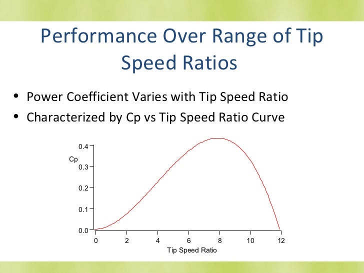

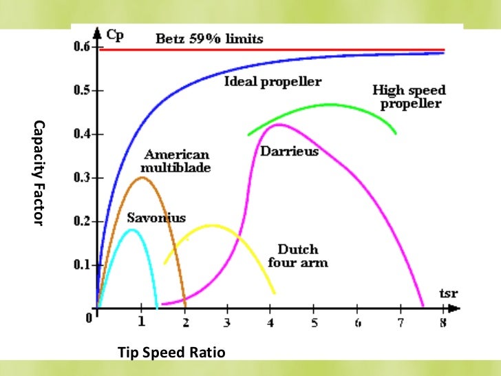

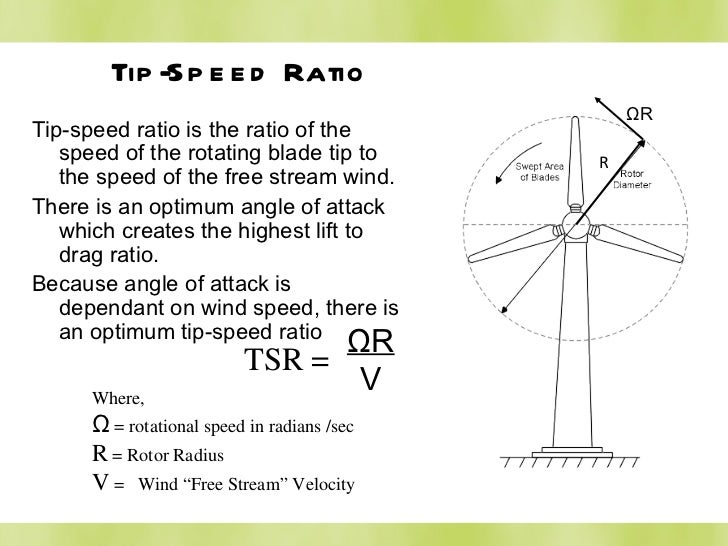

Finally the efficiency is related to optimizing the Tip Speed Ratio [TSR]
see for example
http://www.slideshare.net/Jupiter276/windturbinetechnology-kid-wind
Tip-Speed Ratio == the ratio of the speed of the rotating blade tip to the speed of the free stream wind. For an airfoil [turbine blade] there is an optimum angle of attack which creates the highest lift to drag ratio.
Because angle of attack is dependant on wind speed, there is an optimum tip-speed ratio TSR == optimum = ΩR / V
Where, Ω = rotational speed in radians /sec
R = Rotor Radius
V = Wind “Free Stream” Velocity
