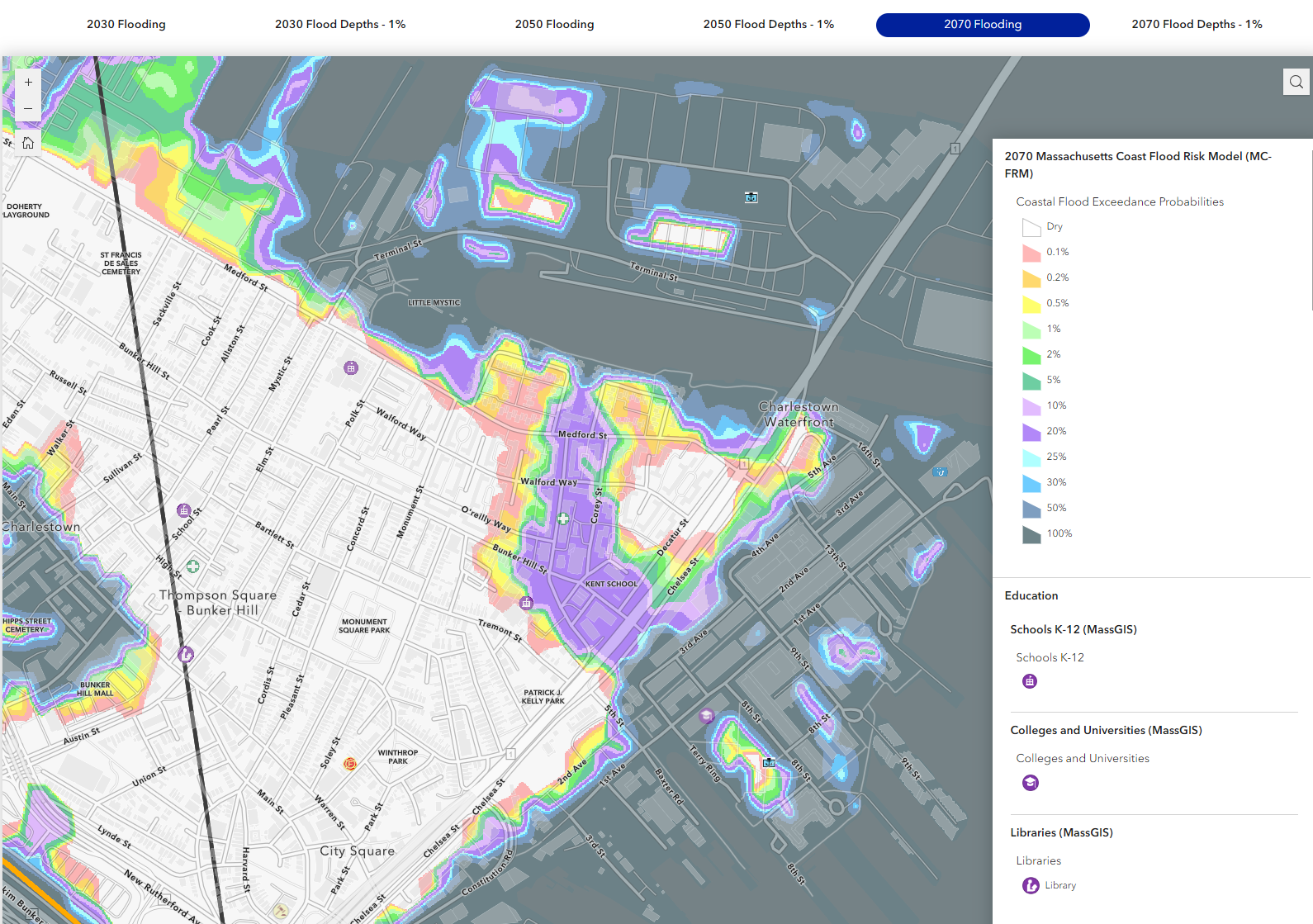

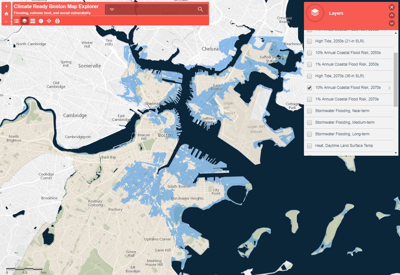

The new redev building going up right now is in a unprotected floodplain with no flood mitigation projects ongoing right now.
thats not accurate at all, as shown by the flood maps. only a small portion of the BH site is even in the 2070 1% flood zone.
not sure if its intentional for a narrative or ignorance but here it is, 2070. most of Charlestown is actually pretty well protected except the neck and the infill areas of the Navy Yard and Marine terminal area.
and if you want to get into more detail:
The state notes a 20% flood risk for the brand new buildings by 2070. Only 45 years away. That map is horrendously overly optimistic. Boston is already enduring steaming Amazon-like summers where overnight lows are 8 - 10 degrees higher then they used to be in the late 1800s, with dews stuck in the 70s (low 20s Celcuis) for weeks on end. Projected active hurricane season this year. Federal elections with a high chance of going south. The T and city budgets going broke. Good luck reducing emissions to get that optimistic scenario for the first map.
A 20% flood risk is a 5 YEAR storm. That is a dangerously high risk of flooding. The new building going up right now is in grave danger in the near future.
