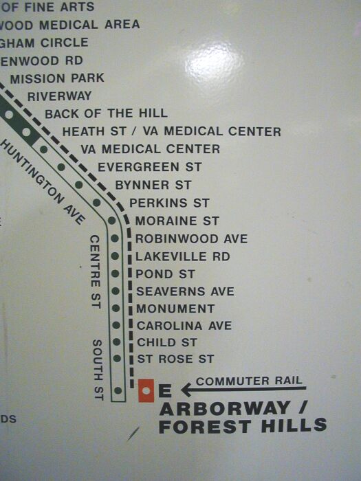

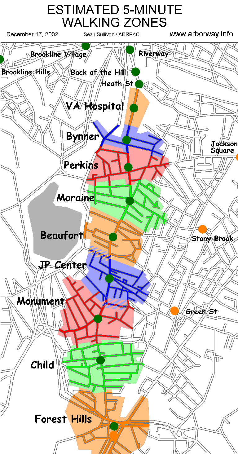

The restoration plan cut the number of past-Heath stops from 14 (pre-1985) to 9 (calculated on 5-minute walk catchment areas). And that did not include likelihood that excessively-packed low ridership stops (and perennial consolidation candidates whenever that subject's officially breached) like Fenwood and Back of the Hill would get whacked at long last and trim the street-running stops to an efficient dozen. The plan included the signal prioritization badly needed (and which STILL hasn't been implemented for the much-overhyped 39 improvements plan). It included corner parking reconfiguration for the curbside stops. It included a revival of the pre-1985 service plan where Heath short-turns doubled up the inner headways during the day and ran deeper inbound to North Station or Lechmere while Forest Hills had lighter headways, less peak vs. off-peak variance, and inbound short-turns as a control for street-running schedule variance impacting the Central Subway (the B still would've been many times a bigger factor for that given the headway disparity vs. the E). It would've turned most likely at GC or Park instead of running all the way to Union Sq. like Heath is scheduled to. And this is a place where the D-to-E connector and a Brookline Village short-turn replacing Heath could've accentuated the difference further in inner vs. outer service patterns.
Say what you will about the general wisdom of it...those were substantive project design elements directly addressing post-1985 changes on the corridor, backed by data collection and projections. Given that the 39 has had the post-E cancellation improvements plan delayed, delayed, delayed and whittled back to ever more negligible impact...the gap between the restoration plan's substantive justification and the F.U.D.-spreading officials' substantiation is widening. The kindest thing you can say is that they get a very incomplete grade. We don't have the full picture mode-vs.-mode until they start providing more proof. Especially on stuff like making the BTD enforce its own damn parking rules, because that kills the 39 today and un-does most of the benefits of the as-yet-unimplemented improvements. After 25 years of this avoidance game on their part, it's pretty clear they seem to prefer the freedom of never having to substantiate their inaction.
