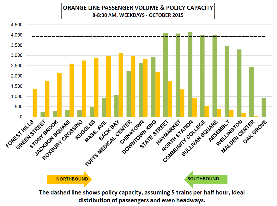

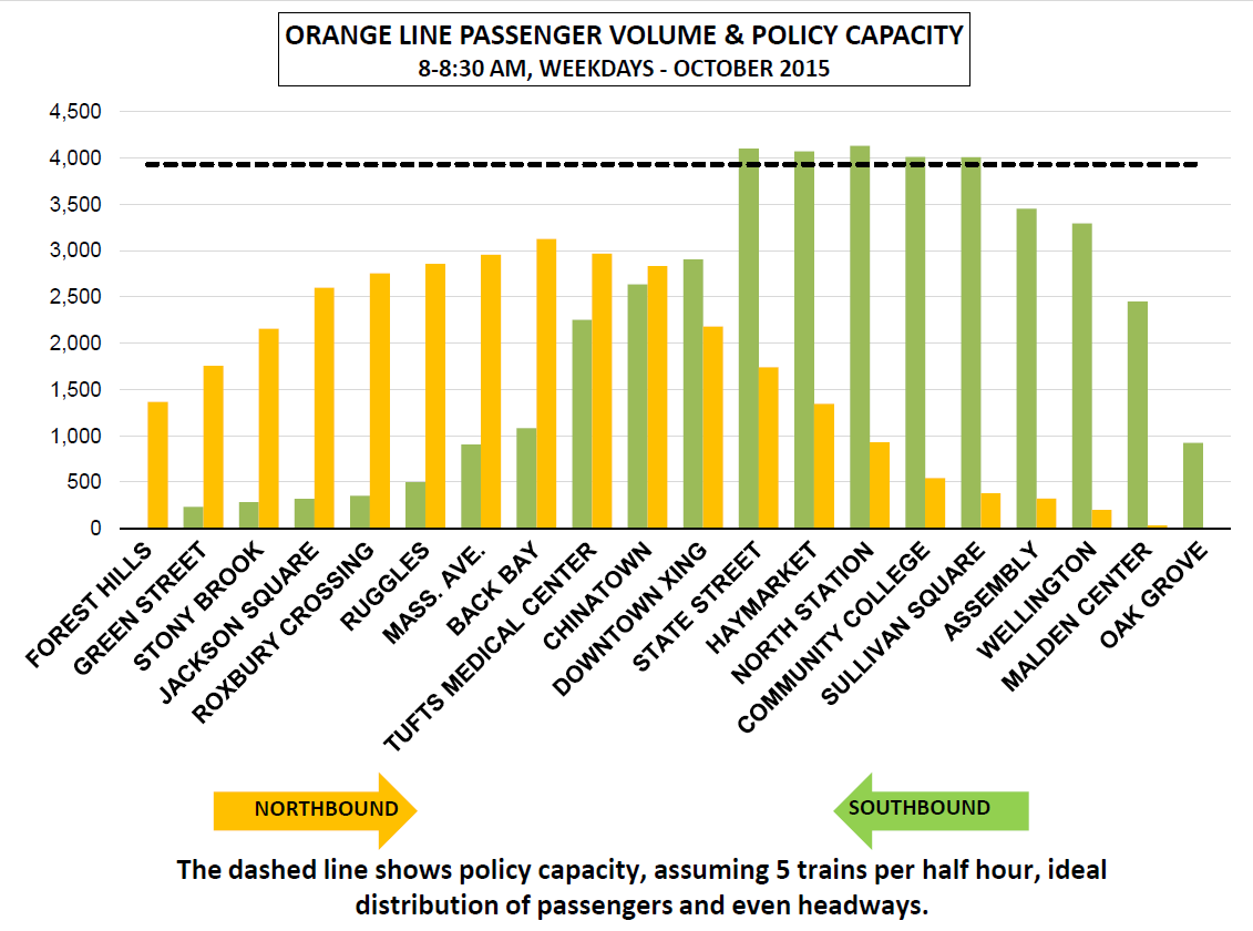

This MBTA chart (albeit 5yrs old) shows ridership patterns on the OL. MC is well before peak ridership: full trains start at Sullivan. So, Sullivan is fed by 12 bus routes. Three go by Sweetser Cir, where there would assumedly be a station. So, most of that ridership is now on Chelsea OL. Three go Downtown. Four of the remaining cross the new GLX. One comes within two blocks. One would not be affected. Wellington feeds seven routes, five of which also go to Sweetser. And ridership is not equally distributed: four of the most traveled go through Sweetser. Three min frequency would double capacity to 16000 ph. So capacity to OG would remain the same as now, as would frequency. Even 4 min frequency would probably provide sufficient capacity, as ridership north of Sullivan will drop, but frequency would drop to eight min. If anything, with time, the Chelsea branch might exceed the OG.
Also, if GL to Sullivan were implemented, a significant number of pax would detrain from OL

So, by your own chart, MC already matches almost the entire southern end of Orange, and that's 5 year old data. I'd love to have more up to date data, but anecdotally, ridership levels weren't exactly dropping prior to COVID. Add to that the eventual extension of Orange to Reading in an NSRL (or NSEWRL) world due to the increasing difficulty of running that as a CR branch (adding more ridership on what's currently your Oak Grove branch), and things start getting dicey. Presumably the state would find a way to shiv in a PnR stop where the line crosses 128, netting additional ridership.
You've nicely demonstrated a compelling need for Rapid Transit heading East from Sullivan (hence the Urban Ring). I agree with that need. You have not demonstrated a need for that to be the heavy rail OL vs the Light Rail GL, imo.
