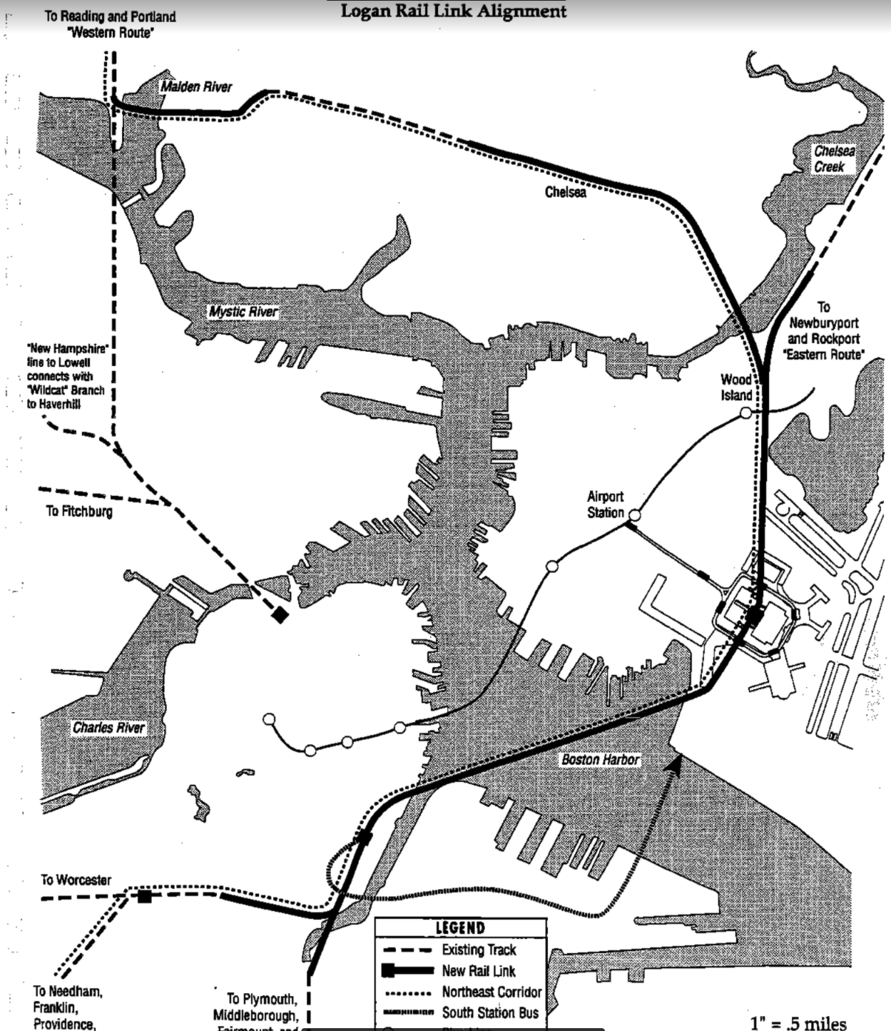

I've been researching and idly wondering about ways to reimagine the rail network in Greater Boston for over 20 years now, and never, not once, not even for the briefest moment did this idea ever cross my mind:
I mean, talk about crazy transit pitches! Crossing over through Chelsea and adding an Amtrak-only hookback (that surely would've have molasses-like speed restrictions) at Wellington in order to send the future-Downeaster up the single track along the Orange Line to the Reading Line? That's nuts. I mean, I love it for its imaginativeness, and I think it's worthwhile to think about – I'm always in favor of considering ideas that force us to look at things from a new perspective.
But to put it bluntly, that shit is wild.

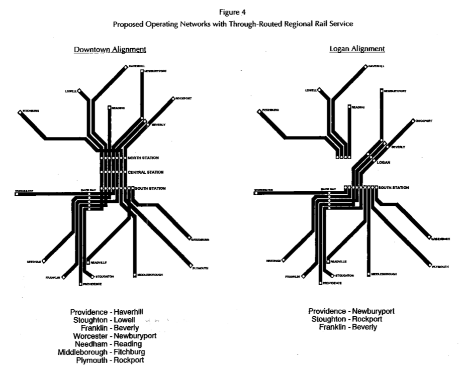

Also, on the more generic note of a cross-harbor tunnel: honestly I think this diagram sums up my problem with it very succinctly:
A downtown alignment (yes, with four tracks) allows you to unify and balance the whole system. (Yes, with a handwavy asterisk next to the Old Colony Division, but that's neither here nor there.) Swapping out a second set of downtown tracks for a cross-harbor alignment shunts those trains over to the Eastern Route, which is important, but definitely doesn't merit half of the traffic from the southside.
Plus, and I cannot emphasize this enough -- the current route from Winthrop Avenue to North Station -- with trundeling diesel, low-level boarding at Chelsea, and slowed terminal approach into North Station... that current route takes something like 15 minutes to get downtown. If you -- somehow -- managed to fly a train between Winthrop Ave and South Station at 45 mph (non-stop)... congrats, under that scenario, you've shaved the journey down by a whopping 9 minutes. Add in your dwell time at Airport Station, and you're probably looking at a 7 minute savings. There simply aren't huge time-savings to be had here.

Three comments:
The diagram you have posted is NOT what I have proposed.
The "second subway" will still exist
Yes, the tubes will be somewhat imbalanced but unless maximum throughput of more than 24tph to Lowell/Haverhill and Fitchburg is needed, it makes little difference where the second tunnel is.

God what a shit sandwich Downeaster routing that is. Single-track bottleneck and the grade crossing hell all the same with curves-FTW. On detour days for GLX construction when the DE is punted to the Western Route it only ends up making par time to the NH Main by going completely nonstop North Station-Haverhill. It'd almost be faster under this bizarro-tunnel alternate universe to go slower first by backtracking even further to the Innerbelt connector then speeding up the Lowell Line to Wilmington to 90 MPH to ram it brute-force back to par rather than trying to make lemonade out of the Reading Line's numerous performance deficiencies. At least that way it wouldn't be a such a dispatching nightmare, though it would take as long on the clock to get between Boston and Somerville on that circuitous meander as it would Somerville-Wilmington on the main routing.
Seems awfully self-evident why this "DRAFT" study never advanced to a revision round. Bonkers doesn't begin to describe. Curious as to who scratched who's back in the Legislature to even fund it in the first place, because it had to have taken a curious set of circumstances to light a couple bales of cash on fire for such a naff-by-design prospect. Somewhere deep in the Legislative record there's a fun throwaway story of political sausage-making telling the tale of how this one briefly came to pass.

So, actually, a harbor RR tunnel WAS studied in 1994 https://drive.google.com/file/d/1SfOmrQ-DMgM94NRvv3MtVTR0mV5vHOX2/view?usp=drivesdk
I do not just conjure these things up. Again, I ,and others I collaborate with, do research.
We analyze population data. We analyze traffic patterns. We analyze job density data.

I realize that isn't what you proposed, and I apologize that I wasn't clearer. My point is that a cross-harbor tunnel maxes out at serving the Eastern Route -- a second downtown tunnel can serve all routes.
I agree, the second subway would exist, but in significantly diluted form. And it's not just a matter of 24tph (and honestly I'm not even interrogating that number right now, I'm just echoing it back for conversation's sake) to Fitchburg/Lowell/Haverhill -- it's a matter of 24tph to the northern end of the Financial District and to the West End. And likewise from those places to Back Bay and Longwood.
I appreciate that you see value in a cross-harbor tunnel; in a build-everything future, yes, I can see some utility. But short of that, I'm personally unconvinced, but I appreciate you taking the time to engage about it.
And -- just to be clear -- my delight at the study you've posted is genuine. I think the ideas are crazy, but I love coming across crazy ideas like this. So, you have my heartfelt thanks for sharing this strange little nugget of Boston transportation history.

And also, I am sorry if my comment on "the diagram" was confusing. I referred to "Figure 4" the diagram of possible routing which did not show any connection with Fitchburg, Lowell etc.

Okay so I stepped away from the discussion for a bit, and while you and I clearly disagree, we at least are doing so civilly. But F-Line is right. You've claimed that the existence of this cross-harbor study was some sort of vindication of following the data (nevermind the fact that studies are done to determine if there's actual demand or cost basis to do so, and are not proof of such owing only to the fact that a study was done), but then have conveniently ignored the study's own words indicating that it was done to study an alternate routing for Amtrak to head north. It wasn't done to give the Eastern direct access to South Station, or to give westward lines access to the Airport. Those are nice side benefits which justify the existence of the crossing on the margins, but based on the details provided in that 94 study, Amtrak access to Logan was the point of bothering to route that way.
So yes, a cross-harbor study was done, but under a totally different premise than the one you're advancing (and the study evaluated ridership accordingly). There are some decent takeaways from the study, but it's zero indication that there is, or ever was, a particular political or local appetite for connecting the Eastern to South Station directly (skipping North Station). It only proves that someone somewhere had a bright (possibly drug- or alcohol-fueled) idea to try to run Amtrak around the horn in the weirdest routing possible to head north to Maine. And as @Riverside says, bless you for finding that study. Regardless of the primary discussion we're having, the whole notion of running the Downeaster or an NE Regional around the horn and up the Western is so delightfully weird that it will have me chuckling for a week.
