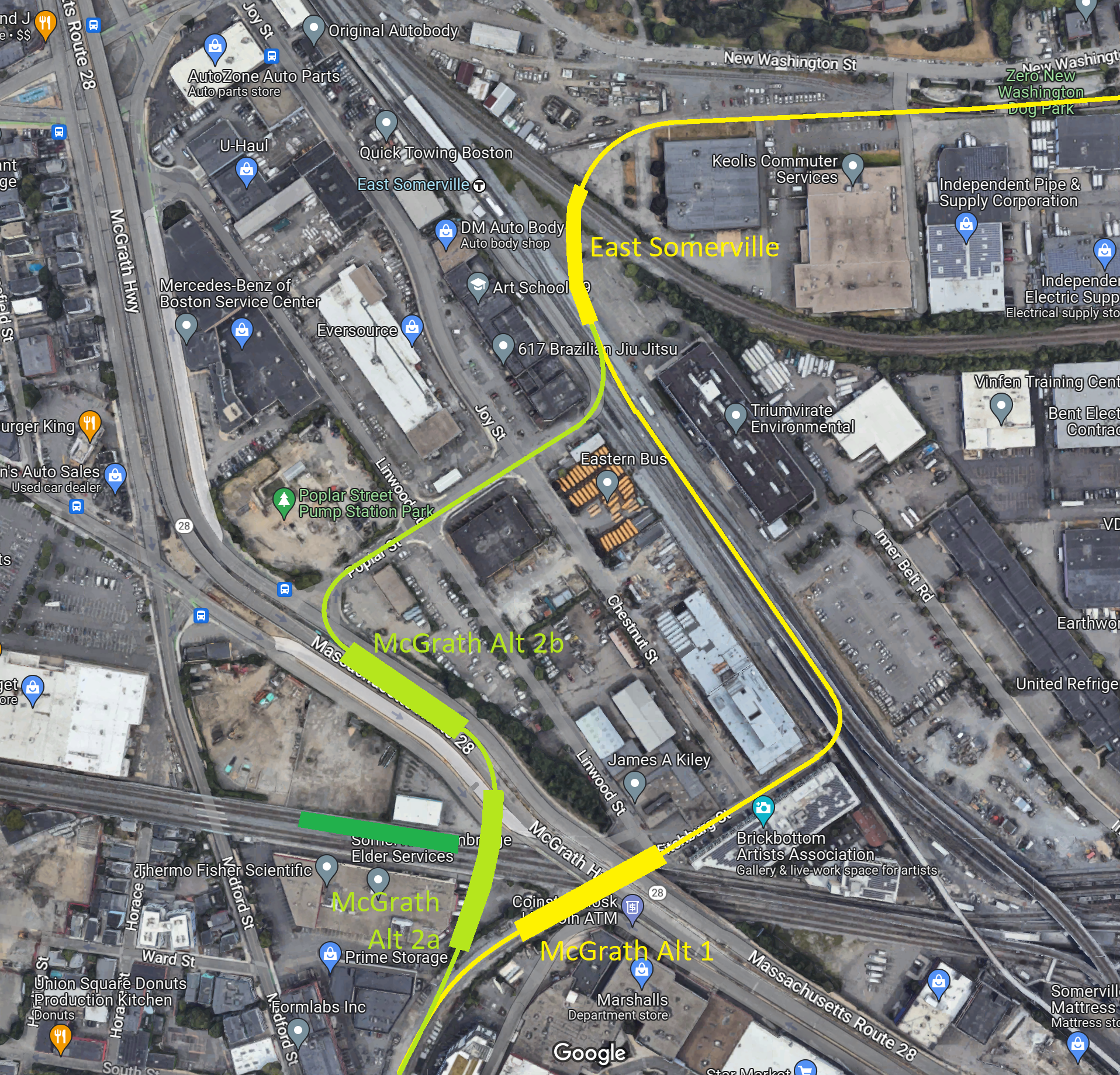

Let’s suppose for a minute that we add an infill on the Union Branch between McGrath Highway and Medford St. This would provide a Union-Gold transfer point that is easier to access from Kendall (Grand Junction) than a transfer at Union would be. (Not to say it would be easy, just easier.) I’m gonna call this station “McGrath” for the moment.

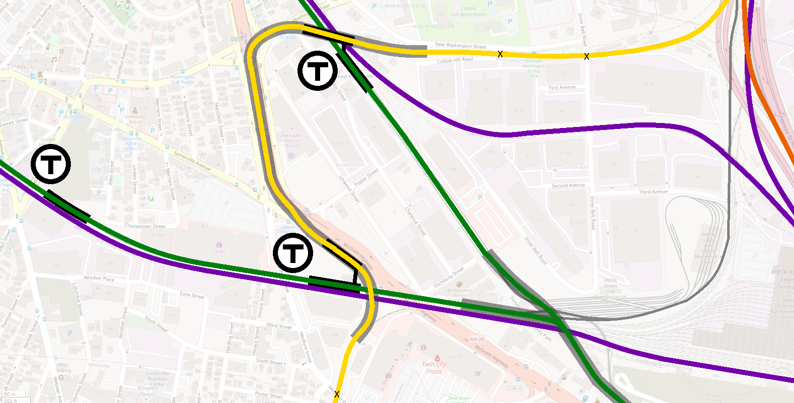

So then we need to find a path that goes Sullivan <> East Somerville <> McGrath <> Kendall. And that… that might be doable.
Sullivan <> East Somerville is sorta straightforward. Washington St itself would require a subway or el, but New Washington St just to the south already has a freight rail track running along it, with potentially as few as two grade crossings and enough space between buildings to create a dedicated two-track surface ROW.
From the other direction, Kendall to McGrath Station should be relatively straightforward: tracks rise up from the Grand Junction ROW on to a viaduct that crosses over the Union Branch, putting an elevated platform perpendicular on the northern side of the Green Line above Somerville Ave Extension.
Getting from McGrath Station to East Somerville is hairier, but… well, there already is an elevated structure traversing most of that distance: McGrath Highway itself. If McGrath can be put on a road diet and dropped to surface level, and the elevated decking turned over to LRT, then you can have an el that isn’t any closer to houses/business than the current state.
Then you need to get between the McGrath Highway viaduct and the surface ROW on New Washington. This would require about 1000 feet of a greenfield elevated, either over Washington St proper, or over the adjacent lots (presumably purchased by the Commonwealth), with an elevated station above/above-and-north-of the current East Somerville station.
And… there you go. A Kendall <> Sullivan LRT line that provides transfers to both branches of the Green Line, and which serves actual neighborhoods instead of a no-man’s-land of maintenance facilities.

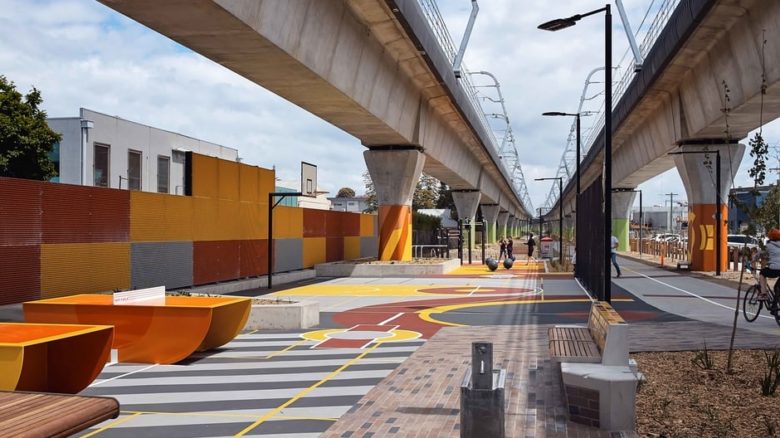

One thought: The grade crossings on New Washington could be eliminated by extending the elevated structure for the Gold Line over those crossings.
