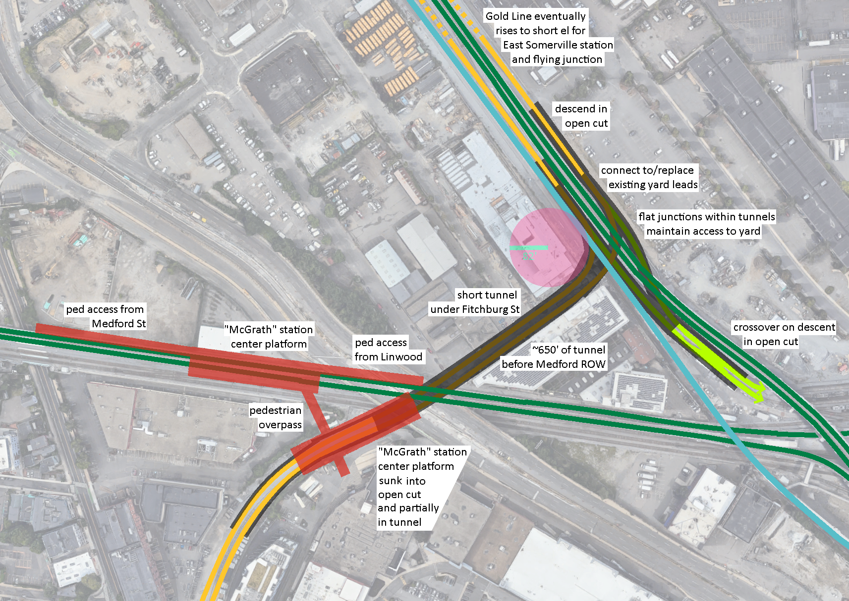

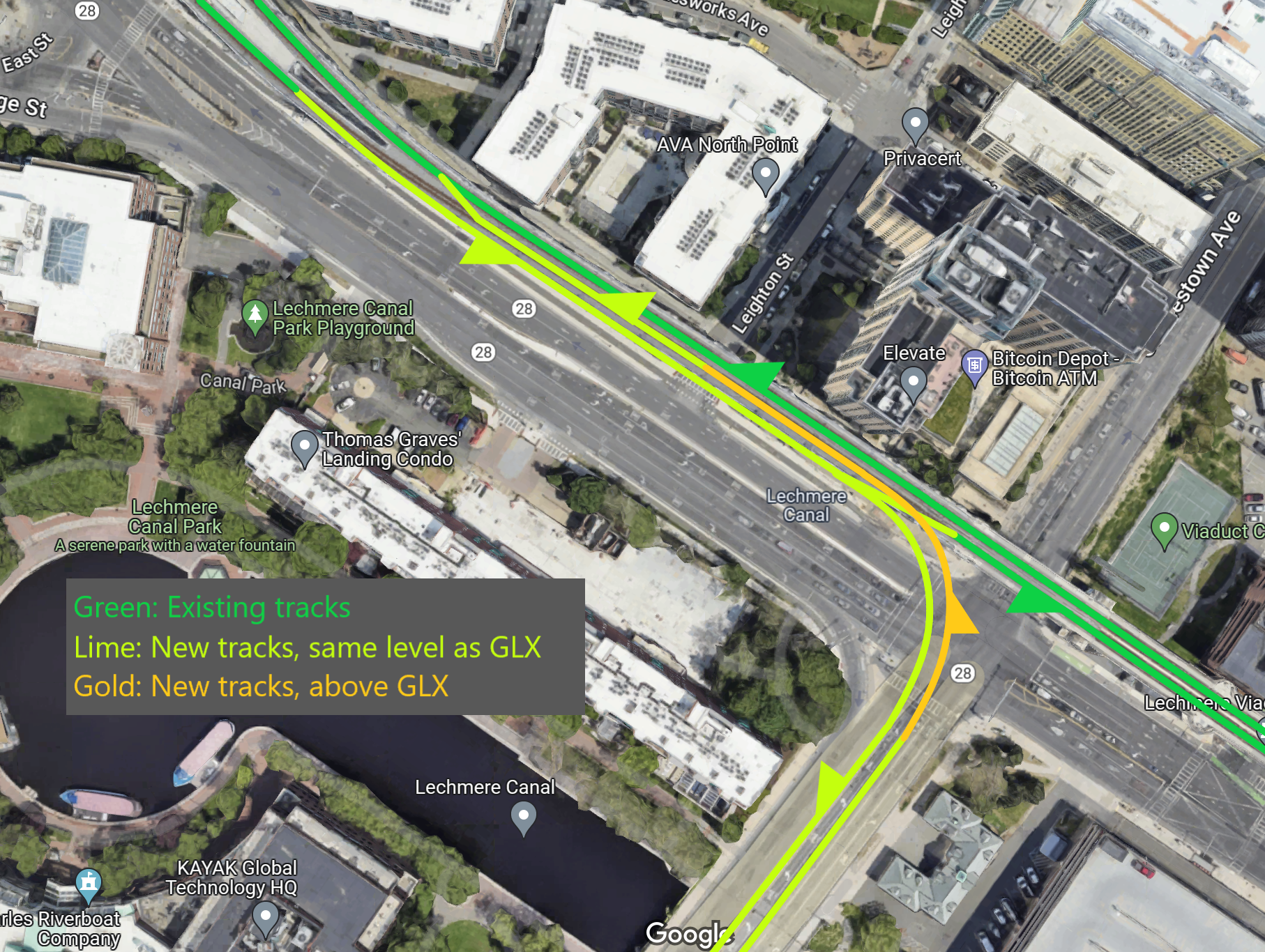

I double checked the support pillars, and mapped them below:Coming back to this silliness, and partially inspired by an alternative @Teban54 put forward here, I've been noodling around with using a short tunnel under Fitchburg St to connect the Grand Junction line with the Medford Branch's yard leads, from which a flying junction could then grab the New Washington St alignment described above.
The two things that terrify me about this version of the silly idea:
- The silliness that would be needed to maintain the yard connections
- Tunneling under Squires Bridge, particularly trying to thread a needle between the support pillars -- I think there's a path but...
One sub-option would be to run the new line up Rutherford Ave instead of next to the OL, and provide a station on Rutherford Ave just west of Austin St to provide part of Charlestown with walkable access.Anyway, the point of revisiting this discussion is that I wanted to consider yet another alternative Urban Ring routing between Sullivan and Kendall.
So far, we have:

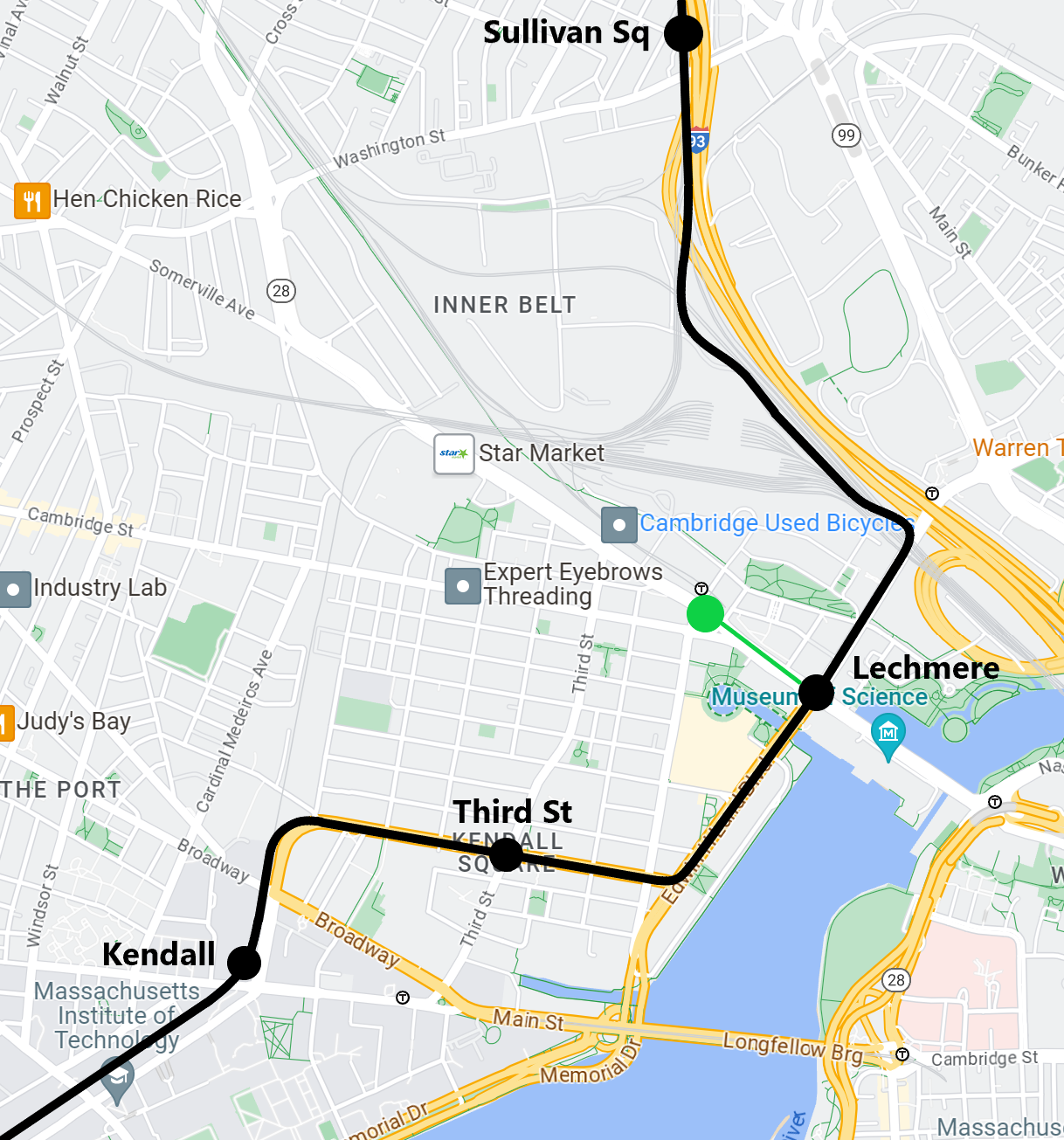

But here's another thought. I know it's probably a bad proposal - and I'm ready for people to call it as such - but:
- The traditional routing, via Grand Junction and Green Line Maintenance Facility (GLMF)
- Need a way to go across Squires Bridge and GLMF
- Many proposals, such as this one from Riverside (I may add more proposals to this post later)
- @Riverside 's alternative routing, via East Somerville and an infill interchange with the Union Square branch
High-level description:
The primary goal and motivation: Connect Urban Ring to the Lechmere area.
- From Grand Junction, turn to Binney St and then Edwin H Land Blvd, where trains run either in a viaduct or on the surface (with dedicated ROWs from a road diet)
- Build "Lechmere" station at the intersection with GLX, with a long out-of-station transfer (900')
- Turn towards Commuter Rail ROW near Gilmore Bridge, and get to Sullivan using a combination of non-revenue tracks and/or viaducts
Other benefits:
- Of course, what we hope is a connection to both GLX branches. This is important for Urban Ring, but the GLMF alignment makes it impossible. The East Somerville alignment achieves this, but requires two close stops on Urban Ring and an infill on the Union Square branch.
- However, let's be real: Even in my proposal, the transfer to GL Lechmere is very far. At 900', it's longer than the State walkway (about 700' from my best guess), and on par with a would-be walkway from Copley to Back Bay (860'). It's also very challenging to build a transfer behind "paid" areas.
- But there's another benefit: Serving the developments around Lechmere. There are already many residential and office buildings, with likely more to come thanks to GLX. It's as much of a destination node as a transfer node.
Obviously, there are significant drawbacks:
- Bringing rail to overly wide streets. Binney St and Land Blvd are both too wide and unfriendly to pedestrians by Cambridge standards, and putting rail either above or along them is a good opportunity to redesign them into urban boulevards.
- My preference is a viaduct along the entire stretch, but obviously that would greatly increase the cost, so surface running is also an alternative. Fortunately, both roads definitely have room for transit lanes, but I'm concerned with the number of crossings on Binney St (and the expected amount of pedestrians).
- Taking away lanes from Gilmore Bridge may be hard due to its traffic volumes, but in the Silver Line Extension Alternatives Analysis, Alt 5 runs via Gilmore Bridge and "almost the entirety of this alternative would operate on dedicated bus lanes". So it's not without precedent.
- A station at Binney/Third to serve the northern part of Kendall, massively increasing catchment. Binney St hosts many labs and offices, which is partially why EZ-Ride goes there, and is also much closer to the apartments in East Cambridge.
- Avoids any tunneling, since both the GLMF and East Somerville alignments will likely require a short tunnel (and the former needs to cut through Brickbottom Junction).
- However, the potential need for viaducts may make this point moot.
More edits coming later.
- Longest route and traveling time.It also has the greatest number of grade crossings by far.
- GLMF: 1.92 miles from Sullivan to Main St, 4 grade crossings north of Main St (some of them can be eliminated with a viaduct in East Cambridge)
- East Somerville: 2.00 miles, 5 grade crossings (via Fitchburg St tunnel)
- Land & Binney: 2.41 miles, surface running has 8 grade crossings
- 2 other intersections do not allow either cars or pedestrians to cross today (Binney/5th and Land/Rogers), but may need to be brought back if we're talking about an urban transformation
- A long viaduct can possibly bypass all of these
- (Potential) lack of cost savings from using existing railroad ROWs. That's the reason why GLMF is the standard for Urban Ring crayon proposals in the first place. My proposal basically requires greenfield ROW from Gilmore Bridge all the way to Kendall.
- Lack of track connection to Green Line (revenue or non-revenue). This can introduce operational challenges, and make a phased build less plausible.
- Potential opposition to viaducts from condos along Land Blvd.
That's an interesting choice too! My concern would be how you get back to the Eastern Route ROW, and how you place a Sullivan station that still has good transfers to the Orange Line.One sub-option would be to run the new line up Rutherford Ave instead of next to the OL, and provide a station on Rutherford Ave just west of Austin St to provide part of Charlestown with walkable access.
I'll just throw my hat in the ring here and say I'm not sure an urban ring route should be trying to string together random bits of surface ROWs through the city, I think they're too limiting in this case. I'd say an ring line should look like Copenhagen's M3/M4, with a fully bored underground route running small automated trains at high frequencies, since the line would be used for a lot of smaller journeys involving transfers, so minimizing the amount of time spent waiting for a train is more important here than aiming for full RL/OL sized trains. Given the size of the project, the fixed costs of a bored tunnel such as the TBM(s) required don't impact the cost per mile nearly as much, and the freedom of a bored route deeper underground allows for a good chunk of the soil/utilities problems immediate underneath the streets to be bypassed, and gives flexibility for deciding a route.That's an interesting choice too! My concern would be how you get back to the Eastern Route ROW, and how you place a Sullivan station that still has good transfers to the Orange Line.
Once you get on Rutherford, there's not really a good place to merge back to OL until Sullivan itself. Depending on alignment, your station at Sullivan can possibly end up being too far from OL. A surface-running route may also take too much time through the many intersections there (especially given the number of potential grade crossings it already has south of Lechmere).
North of Sullivan, there's no room to expand the ROW east of the Rockburyport tracks, as they're adjacent to Sherman St and this building. So you need to either move OL and Rockburyport tracks west to take over the current GJ ROW, or have Urban Ring cross over to the west only to cross OL again immediately after. Another option is to run on Alford St and Lower Broadway, but it faces similar challenges with ROW, grade separation and Sullivan station placement, if not worse.
Well, to be honest, I'm a fan of TBM tunnels for the most part. But the reasons why most people here don't suggest a fully TBM-ed Urban Ring are:I'll just throw my hat in the ring here and say I'm not sure an urban ring route should be trying to string together random bits of surface ROWs through the city, I think they're too limiting in this case. I'd say an ring line should look like Copenhagen's M3/M4, with a fully bored underground route running small automated trains at high frequencies, since the line would be used for a lot of smaller journeys involving transfers, so minimizing the amount of time spent waiting for a train is more important here than aiming for full RL/OL sized trains. Given the size of the project, the fixed costs of a bored tunnel such as the TBM(s) required don't impact the cost per mile nearly as much, and the freedom of a bored route deeper underground allows for a good chunk of the soil/utilities problems immediate underneath the streets to be bypassed, and gives flexibility for deciding a route.

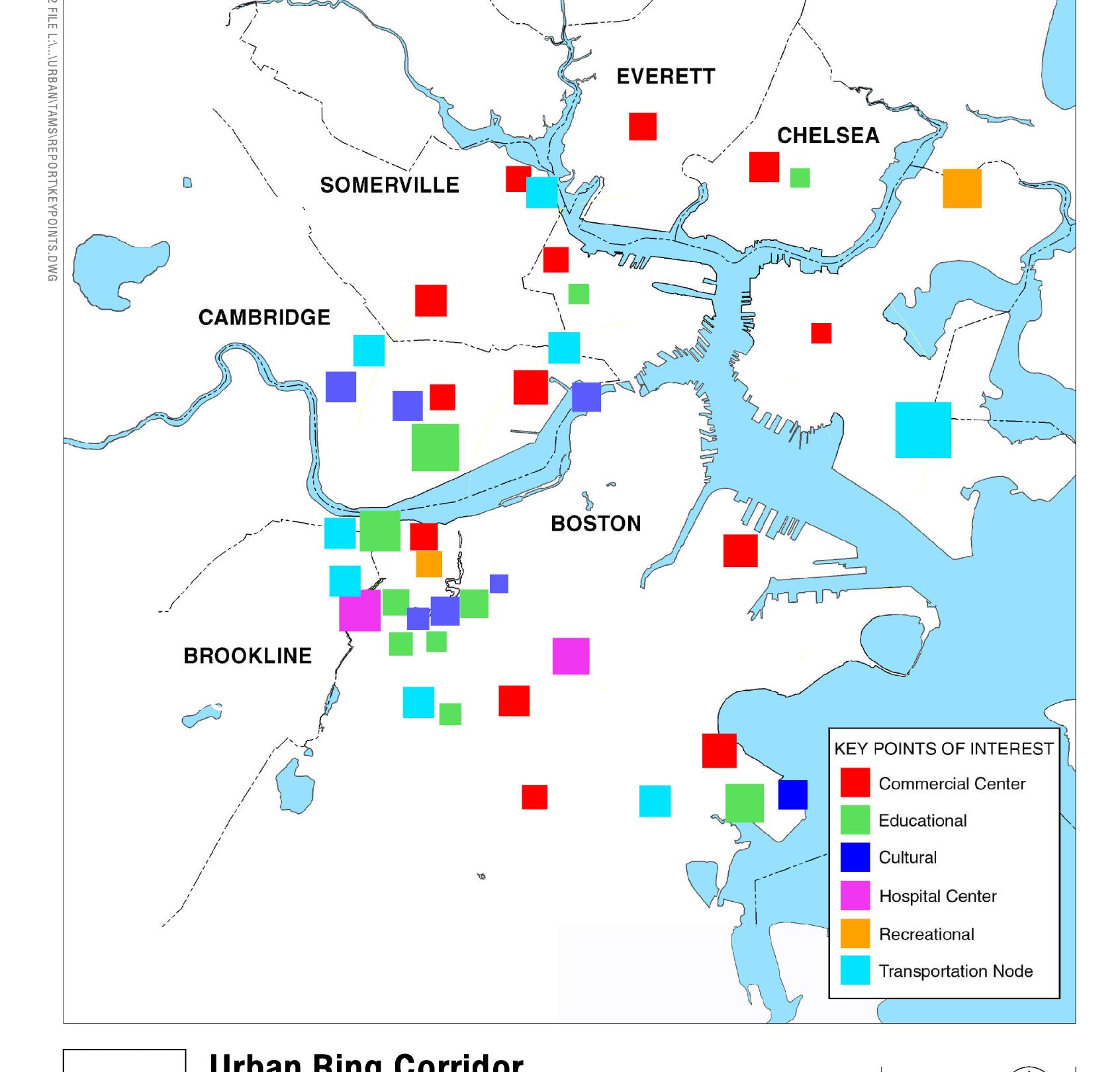

Is it really the ideal urban ring route? Going a bit further out, more following the 66 route, could allow for areas like Allston to be included. And then there's the Grand Junction. Everyone always likes to dream about rapid transit over it, but what would that look like? Obviously the line would need to be double tracked and grade-seperated, most likely in the form of trenching it given that it passes under/through some buildings, and new stations would need to be built underground in a way that avoids demolishing a bunch of buildings on the surface, likely somewhat deep. By the time we're this far, why are we even using the Grand Junction in the first place? Why burden the construction of the project by forcing it along a route that frankly isn't even that good when we're basically building 80% of a bored tunnel subway anyways? I will say though, once you reach Sullivan the argument for popping above ground to cross the Mystic into Everett or Chelsea is much stronger, and given that the best route through Everett would be right under Broadway, if that can be done cut and cover that's obviously a nice bonus.
- Existing railroad ROWs for the northern half from BL Airport to BU Bridge, via Eastern Route and Grand Junction, which also forms the ideal route for northern Urban Ring
- Current grade crossings on Eastern Route can be eliminated, will need to be for 15-min Regional Rail frequencies, and IIRC there are actual plans for them
Lots of the urban ring would be challenging from a flood perspective, especially the portion near the airport. But as I said, I think a tunnel across the river makes more sense anyways, and it seems that avoids most of the immediate problems.
- Crossing Kendall and Red Line, where @F-Line to Dudley has repeatedly said that a tunnel under RL will likely be very costly due to flooding mitigations (unless you tunnel all the way across the Charles towards BU, I think)
I'll just be blunt here, I think that's a stupid assumption. Orbital light rail often suffers from its own success, with the inherently limited capacity of tram-like vehicles hamstringing rapid transit service. Look no further than the GL today to see why that's a problem. Not to mention that grade separation will be necessary, across the entire route, for headways to be short, consistent, and generally well suited for the service provided. That's the hard part of building any transit, and the only reason why light-rail should be considered in this context (IMO) is to allow for at-grade street/median running and local service, neither of which suit a subway line and would severely constrain any conversion attempts in the future. If we're already building a new right-of-way, let's run a metro or light-metro on it.FYI, I think the default assumption here is for Urban Ring to be built (or at least start off) as light rail with short headways, instead of heavy rail.
What about the rail ROW's compromises the routing??? The UR was subject to a Major Investment Study that ID'd the stops that would haul in the most ridership and capture the most transfers from other modes, and that study did not leave any huge catchments on the table. You're going to have to square your preference for an off-ROW routing with the MIS results. This isn't crayon vs. crayon; there's meaty study results informing the routing choice, and a large consensus on the general routing vis-a-vis stop selection.Any urban ring project will need substantial cost control measures implemented, regardless of the tunneling method, and any urban ring project will be extremely expensive just because of the scale. With that along with the importance of the project in mind, I do not think that design decisions should immediately compromise on the route because of cost concerns. The route should make the most important connections, and if there's existing infrastructure to use then that's a nice bonus, not a prerequisite.
Again...the 66 didn't chunk out in the MIS to the mega ridership nodes that following the rail ROW's did. If you want that as an alternative, you have to show the math on the cost-benefit.Is it really the ideal urban ring route? Going a bit further out, more following the 66 route, could allow for areas like Allston to be included. And then there's the Grand Junction. Everyone always likes to dream about rapid transit over it, but what would that look like? Obviously the line would need to be double tracked and grade-seperated, most likely in the form of trenching it given that it passes under/through some buildings, and new stations would need to be built underground in a way that avoids demolishing a bunch of buildings on the surface, likely somewhat deep. By the time we're this far, why are we even using the Grand Junction in the first place? Why burden the construction of the project by forcing it along a route that frankly isn't even that good when we're basically building 80% of a bored tunnel subway anyways? I will say though, once you reach Sullivan the argument for popping above ground to cross the Mystic into Everett or Chelsea is much stronger, and given that the best route through Everett would be right under Broadway, if that can be done cut and cover that's obviously a nice bonus.
HRT doesn't do branching as well as LRT does, and the MIS-studied Urban Ring did have 2 branches: a Harvard Square spur off the BU Bridge junction and a JFK/UMass spur off of Nubian Sq. The patterns would be mixed and overlapping to capture the full spectrum of destination pairs. It's not intended as a uni-line route, because hardly anyone is going to be riding it from end-to-end; the destination pairs take big dumps at roughly the quadrant points on the map. For mixing and matching it's hard to do better than flexible LRT. We've spent pages and pages in the Green Line Reconfig thread putting those patterns into a blender and interfacing them with a capacity-expanded, double-trunked greater Green Line. The possibilities are almost endless on that mode.I'll just be blunt here, I think that's a stupid assumption. Orbital light rail often suffers from its own success, with the inherently limited capacity of tram-like vehicles hamstringing rapid transit service. Look no further than the GL today to see why that's a problem. Not to mention that grade separation will be necessary, across the entire route, for headways to be short, consistent, and generally well suited for the service provided. That's the hard part of building any transit, and the only reason why light-rail should be considered in this context (IMO) is to allow for at-grade street/median running and local service, neither of which suit a subway line and would severely constrain any conversion attempts in the future. If we're already building a new right-of-way, let's run a metro or light-metro on it.
The two bolded parts are not equivalent. A double-tracked and completely grade-separated ROW can run service just as effectively regardless of whether it's at the surface, in a subway (C&C or TBM), or in an elevated structure like these.And then there's the Grand Junction. Everyone always likes to dream about rapid transit over it, but what would that look like? Obviously the line would need to be double tracked and grade-seperated, most likely in the form of trenching it given that it passes under/through some buildings, and new stations would need to be built underground in a way that avoids demolishing a bunch of buildings on the surface, likely somewhat deep. By the time we're this far, why are we even using the Grand Junction in the first place? Why burden the construction of the project by forcing it along a route that frankly isn't even that good when we're basically building 80% of a bored tunnel subway anyways?
Most Urban Ring proposals that use Grand Junction - both crayons and the official Urban Ring study - do have a spur from Harvard that goes south to meet the ring, most frequently via West Station. That can take care of Allston with simple changes.Is it really the ideal urban ring route? Going a bit further out, more following the 66 route, could allow for areas like Allston to be included.
The problem isn't tunneling under the river, it's tunneling under the old Red Line tunnel in a flood-prone area that Kendall is.Lots of the urban ring would be challenging from a flood perspective, especially the portion near the airport. But as I said, I think a tunnel across the river makes more sense anyways, and it seems that avoids most of the immediate problems.
You might be misinterpreting what I implied by Urban Ring being light rail. I was saying most people imagine it will use light rail vehicles akin to GL Type 10s. I was not saying most people want Urban Ring to be a glorified streetcar route running in street medians like the B, C and E branches are.I'll just be blunt here, I think that's a stupid assumption. Orbital light rail often suffers from its own success, with the inherently limited capacity of tram-like vehicles hamstringing rapid transit service. Look no further than the GL today to see why that's a problem. Not to mention that grade separation will be necessary, across the entire route, for headways to be short, consistent, and generally well suited for the service provided. That's the hard part of building any transit, and the only reason why light-rail should be considered in this context (IMO) is to allow for at-grade street/median running and local service, neither of which suit a subway line and would severely constrain any conversion attempts in the future. If we're already building a new right-of-way, let's run a metro or light-metro on it.
The route is only the best if you do what (it seems as far as I can tell) the study did and ignore places like Coolidge Corner, Brookline Village, Brighton, Cambridgeport, etc. If we don't ignore those places, I'd be quite surprise if the answer is exactly the same. The other thing to consider is that the study really focused on BRT as the mode choice, because 2000s. (And it still wasn't cheap) If we don't make that assumption right out of the gate, some of the design choices make way less sense, like essentially paralleling the OL between Community College and Wellington, and some extra squiggly and double-backed service patterns to Union Sq. (Also, most of the "BRT" they propose runs in mixed traffic, which then makes it not BRT. Like I said, 2000s things.)What about the rail ROW's compromises the routing??? The UR was subject to a Major Investment Study that ID'd the stops that would haul in the most ridership and capture the most transfers from other modes, and that study did not leave any huge catchments on the table. You're going to have to square your preference for an off-ROW routing with the MIS results. This isn't crayon vs. crayon; there's meaty study results informing the routing choice, and a large consensus on the general routing vis-a-vis stop selection.
And? We're not trying to build a city-wide tram network here, we're trying to build an orbital line. The first one would definitely be nice, but it's not the priority here. This image from the MIS study shows quite nicely I think that you do not need much branching to hit basically all the major points of interest.HRT doesn't do branching as well as LRT does, and the MIS-studied Urban Ring did have 2 branches: a Harvard Square spur off the BU Bridge junction and a JFK/UMass spur off of Nubian Sq. The patterns would be mixed and overlapping to capture the full spectrum of destination pairs. It's not intended as a uni-line route, because hardly anyone is going to be riding it from end-to-end; the destination pairs take big dumps at roughly the quadrant points on the map. For mixing and matching it's hard to do better than flexible LRT. We've spent pages and pages in the Green Line Reconfig thread putting those patterns into a blender and interfacing them with a capacity-expanded, double-trunked greater Green Line. The possibilities are almost endless on that mode.
