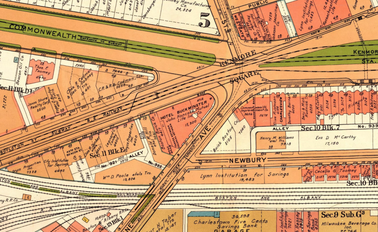

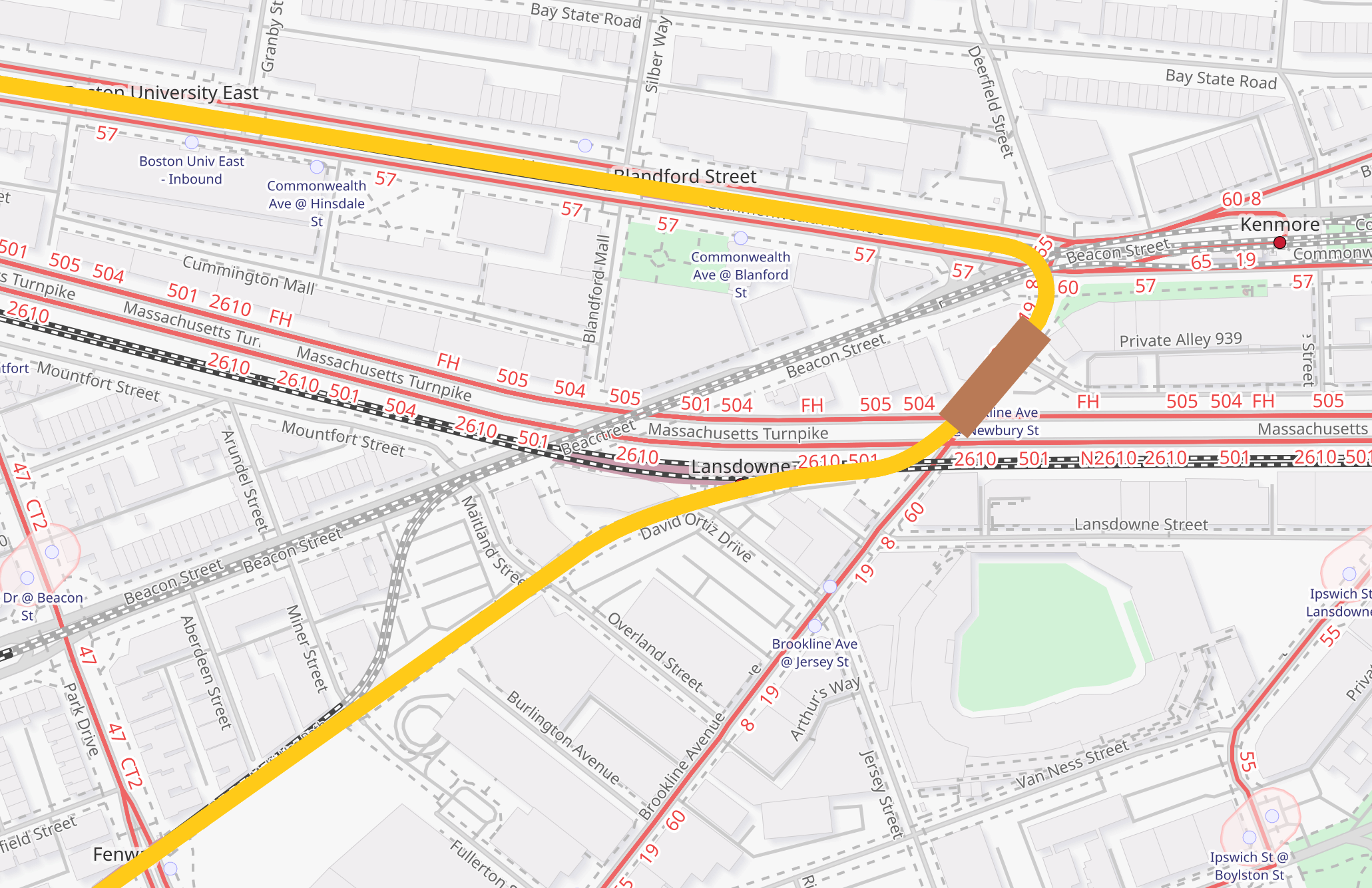

Also of mid concern is the curve through Kenmore Square -- again, some question about the substrate, and some question about how quickly the Beacon St Subway descends after the flying junction and in turn how deep and how quick the new subway would need to drop to dig underneath it

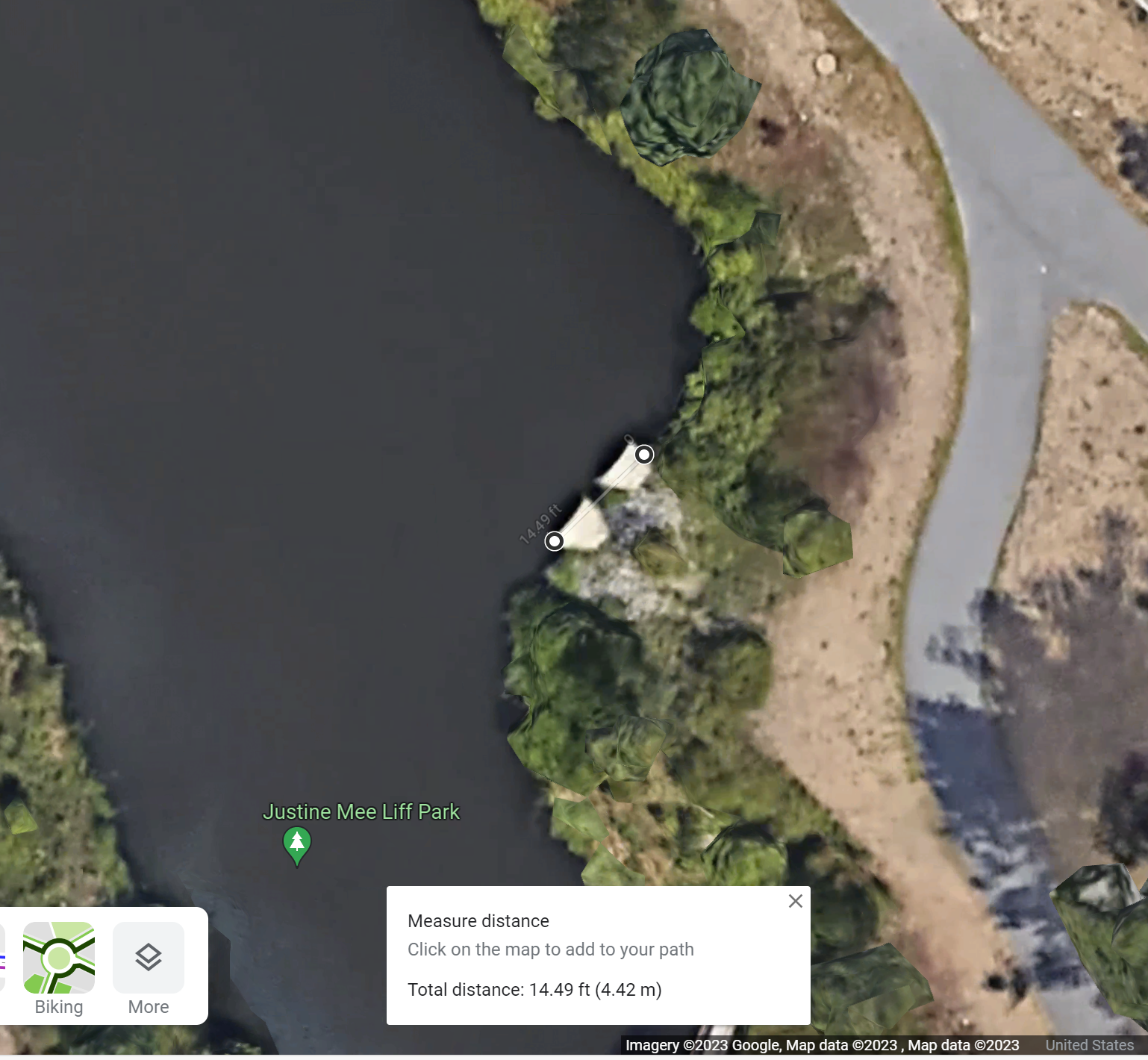

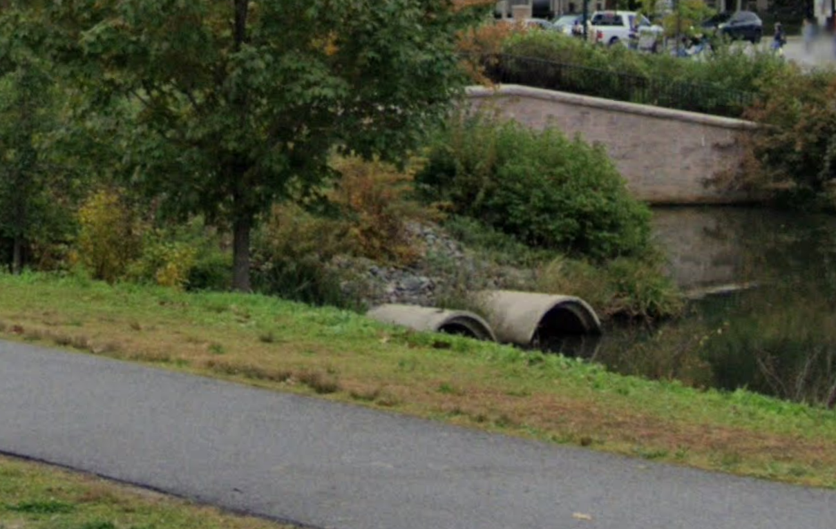

Most Concern: the stretch along Brookline Ave, which looks so tempting -- barely 500 feet, linking together two relatively clean ROWs. But to me it was the most mysterious and therefore concerning, so I went looking at the glorious tome that is the 1938 Bromley Atlas, where I found:
There, in tiny letters, we can see the label of the Muddy River Conduit (described in greater detail here). So, does that kill the plan dead? No idea -- maybe it's possible to integrate the conduit into the subway or something, I dunno. But, in my eyes at least, that seems like the main question mark for this otherwise very promising proposal.

Hmm. I have no idea about the depth and width of the Muddy River Conduit, but the beginning of the conduit - the gate house in Muddy River near Park Dr - can be seen on satellite and street view. There are two pipes there that don't seem too big, about 15 ft wide combined:
If the conduit is indeed like this at the Brookline Ave section, and the road has no other utilities underneath (which admittedly is a big question mark), then it doesn't look like a death sentence. Looks like it should be relatively easy to reposition the pipes and make way for the subway and stations.
I'm not sure whether the conduit is above or below the B/C flyover, but even if it's below, it still seems plausible for the Urban Ring subway to go underneath it. (The subway will need to start its descent at Comm Ave, but there's plenty of space for that.) Or move the conduit below the subway. Or stack the tracks and platforms so that the station can be fit in one side of the conduit, possibly requiring the pipes to be shifted horizontally.
