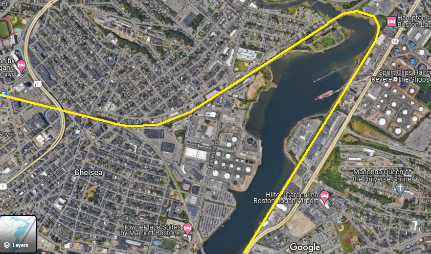

Yes, say you cross Chelsea Creek with a movable bridge where the deck is usually 60' AMSL and raises to 175' for openings. For most vessels the LRT bridge would remain fixed and the Chelsea Street bridge would open, except for the tallest ones where the tankers need the full clearance. Sort of like how the Lechmere Viaduct crosses over anything that needs the other bridges to open (and how I assume it used to work when it was a functional movable bridge). As the fact sheet says, most of the tugs pass before the bridge has even reached its full height. As you can see in these photos I saw on UHub/Mastodon the other day, the tugs are substantially shorter than the tankers. I have no idea about the barges, and I admit that I know very little about maritime stuff in general.
I'm not sure how tall 1A is around the Neptune Road crossing, but if you're already elevated there might be clearance to snake over it even though it's right at the 33L centerline.

But what I'm mostly missing is why you wouldn't just put a tunnel under Chelsea Creek? That doesn't even seem like a "crazy" transit pitch. That's just what you'd do if you built an Urban Ring. My guess is you'd do an immersed tube tunnel, like they did for the Pike and Silver Line across Fort Point Channel. Chelsea Creek is even a little narrower with far less existing infrastructure around. There are plenty of sites along the creek to potentially build the tubes. How is this even a questions for a "crazy" transit pitch?
I think everyone agrees that a tunnel under Chelsea Creek can certainly work in a world with unlimited budget. However, it circles back to the question I just asked above: cost-benefit analysis.
While "cost of 170' bridge vs. tunnel" is a separate question, regardless of the method of grade-separation, it needs to have enough usage to justify it. Which is exactly my original point: I'm not saying it doesn't have merit or isn't worthwhile enough (it can absolutely turn out to be), but the benefits of a grade-separated Urban Ring route to Day Square may be far smaller than it might seem on first glance. And as @JeffDowntown seemingly implied, the cost of such a tunnel may also be used for a more direct Sullivan-Day Square (or Maverick) connection via Charlestown, which brings more benefits to riders doing OL-Airport, GLX-Airport etc, and is equally capable of being extended to Central Parking or Logan Terminals.
