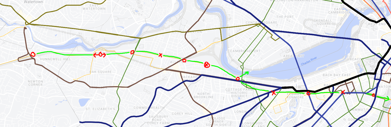

The 1945 expansion map had the B&A rapid transit line doing stops at Broadway (South Cove-ish), Trinity Place (Back Bay-ish), Cottage Farm, Allston, Brighton, Faneuil, and Newton Corner. The pronounced gap between Back Bay and Cottage Farm was probably ripe for an extra stop near Kenmore, but there was a small freight yard at the former junction with the Highland Branch so siting of a Landsdowne analogue was uncertain at the time. Except for Broadway those were the B&A station locations verbatim.Somehow my Allston-Brighton I-90 corridor map got mentioned here. Anyhow, moving the thread here since it's more suited to this purpose.
The ROW within Newton Corner would have an issue of how many stops are needed to adequtely serve the entire corridor.

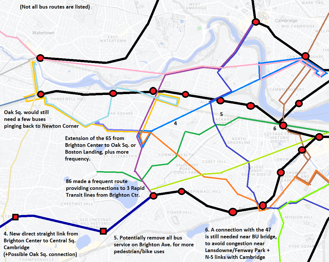

The Boston Landing and the proposed Beacon Yard stations have poor connectivity to existing bus routes, although they are located in areas that may be easier for TOD. Lansdowne is halfway between Kenmore and the D's Fenway station, but it's utility is limited without NSRL and low frequency/connections (see the GL operator's comments).
If stops are added along all potential nodes for demand within the corridor, without removing existing stations, it would result in a total of 10 stations in between Newton Corner and South Station, with some stops quite close to one another, especially around Allston. At this point, I'd be going full "god mode sandbox" and not "crazy transit pitch".
Origin Station Destination Station Walk time (minutes) Comments Connections at Origin Station Newton Corner West Brighton/Charles River Loop 29 min 33 if the station is located on Parsons St. instead of Brooks St. 57/553/554/556/558 - Newton Corner West Brighton/Charles River Loop Brighton Depot 23 min 16 if using Parsons St. location. 64 - Oak Sq Brighton Depot Boston Landing 14 min Quite close stop spacing, especially for RUR, and quite tucked in if it were a god mode sandbox HRT line. 64/86 - Brighton Depot Boston Landing Allston Depot 11 min Stop spacing is too close. However, it Boston Landing were skipped, it would be a 25 minute walk to get to Brighton Depot from Allston Depot, meaning the Boston Landing TOD would have poor connectivity with a 13 minute walk to get to either station. 64 Boston Landing - lengthy detour (not useful) Allston Depot Beacon Yards/West Station 13 min Better connections with the 66 and 64 bus. 66/64 - Allston Depot Beacon Yards/West Station Cottage Farm/BU West/BU Bridge 9 - 11 min Excessively close stop spacing for RUR and probably HRT too. May be better if the station is shifted ever so slightly east to balance the distance to BU Bridge. The area around the BU Bridge is in the throat, so space is probably too tight for a station, bridge, railway junction, and highway. no bus connections Cottage Farm/BU West/BU Bridge Lansdowne 20 min Seems reasonable, most of BU is covered by one of the two's walksheds. 47/57 - BU West, Grand Junction Railway to Cambridge (railway junction) Lansdowne Hynes Convention Center/Mass Ave. (I-90-B&A station) 17 min I'm going full "god mode sandbox" here. For a "Green Line relief valve", I much prefer a routing to Back Bay station, as Storrow Drive, while Storrow's ROW could be repurposed, the walkshed of Storrow just sucks with half of it being water, plus Back Bay provides connections from west to south. 60/65/8/19 - Lansdowne, 6 minute walk to Kenmore Station or GL D Branch (Fenway) Hynes Convention Center/Mass Ave. (I-90-B&A station) Back Bay Station 16 min "Green Line relief valve" (ditto) 1/GL B/C/D - Hynes Convention Center, Back Bay Station South Cove (Washington St.) 16 min Mostly to provide service to Chinatown and South End, and a more direct connection to the Silver Line and points south from the west. Primarily rationale and my ideal "god mode sandbox's Green Line relief valve". OL, Commuter Rail, Amtrak - Back Bay Station South Cove (Washington St.) South Station 19 min Overlaps with SL4 SL4/SL5/9 - South Cove & Herald St. & Washington St.
If all of the stops are used as actual stops (with about 1.65 - 2 mins per stop), Such a trip from Newton Corner to South Station would take about 19 - 22 minutes. A trip from Newton Corner to Back Bay would take 16 - 17 minutes, a transfer to OL to continue downtown, would be 29 minutes (7 mi/11.3 km) from Newton Corner including transfer time at Back Bay. Such a travel time and trip length would be more suitable for LRT or HRT, and such stop spacing could allow for a reduction of bus routes in the area, as most of the utlity of the bus routes would be covered by such line, but RUR would not suffice.
So my thoughts are, how many stops are needed between Newton Corner and South Station, and what would be appropiate travel times to Back Bay, South Station, and DTX, from Newton Corner?
I think the only way you could mount this as rapid transit is if a Blue Line extension from Charles MGH to Kenmore went along a torn-down Storrow Drive, then banged a right at the B&A at Brookline Avenue in a subway to pick up all the stops Cottage Farm thru Newton Corner...then probably turn under Galen St. to Watertown. You definitely can't do that many stations on RR. The need for 1 set of crossovers every 2 stations to mix expresses with locals places an upper limit on how many stops you can cram in before the whole works on the B&A slows down to a crawl. You're probably only looking at Newton Corner as an infill all the way out to 128...*maybe* Faneuil, but that might even be pushing it.
