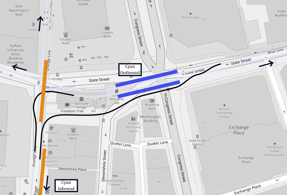

hello, had an idea for a blue-orange line junction at state
i wanted to understand the doability of this junction before i spend time exploring possible service patterns so i came to you all
heres my very basic mockup of how the junction could theoretically work
"cyan" is the name of a theoretical new service that comes from beyond aquarium and goes past chinatown, it would use the orange line's inbound platforms and the blue line's outbound
there is a crossover just east of the blue line platforms
I know they share car width, but do they share loading heights?
They're off by 3 inches - but that's within the range of adjustable air ballasts. (Which the current fleets are not equipped with - they require a visit to the shops.)

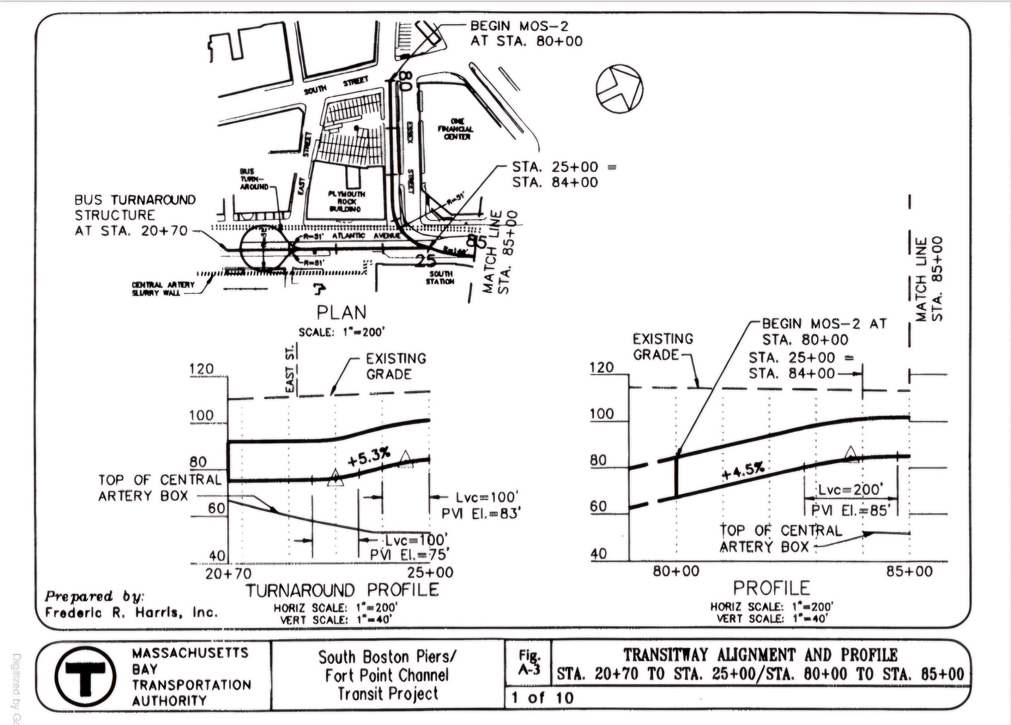

In search of bridging the missing link from SL Phase 3 BRT - SL4/5 Nubian/South End to SL1/2 Seaport/Airport (and onward to Chelsea) I was thinking that Boston and the State could make the long-desired link with a "small" tunneling project. My understanding of the Silver Line Piers Transitway is that the out-of-service loop is somewhere between E and Beach Streets under Atlantic Avenue. The pitch is to replace that loop - with a portal to the surface that "lands" right at Kneeland. There it can turn to connect to a (side or) center-running transitway along Kneeland using space from a fairly massive road diet -- 5 or 4 lanes at some places to 3 or 2.
This proposal "misses" the GL to SL connection that could make a big network difference - but - there's still a fairly decent travel market according to the BNR data for South Boston/Seaport and the Downtown, JP, Roxbury, and Mission Hill neighborhoods.
Ideally one would build a portal from Essex Street at Surface Road down to the tunnel - but it looks like such a short distance (500 feet in Google Maps) that I have a hard time believing that it would be workable given all the stuff underground there. I also don't know how the SL platforms align - my recollection was that Essex Street is probably too close/maybe just at the platforms.
The loop is actually under the CAT there if I recall correctly, you'd need to use the 'hook' that comes out on Essex St. But assuming you do that I believe it would actually work.
Good timing, since I've been reading up on the original Phase 3 proposal, but the loop is actually over the CAT.
(While I'm here, anyone have a good idea of where I can track down a copy of that 2009 FTA funding report?) Never mind, I found it but it's not as useful as I thought.
Thanks! I guess this goes to show that I might be feasible to actually make the hard turn and pop up just at South St and Essex St. I know the east side interceptor is somewhere along South St but perhaps with the bus tunnel aka Transit way being relatively shallow, it might be possible to get up to grade fast enough and not chase the grade into the interceptor.
So, fun fact: per Wikipedia the general service pattern you're proposing got a full workup by the then Secretary of Transportation in 2006, after the federal grant application for phase 3 got pulled. The general routing would have used the Essex leg, built a transfer to Park and DTX using what is now the Winter St concourse probably via Lincoln & Summer, and northbound used Kneeland and Surface. I imagine that would still probably remain the best routing today.
Since we're talking about it, my current research into phase 3 is focused on what amount of the project scope was related to the requirement that phase 1, what is now SL 4, would be routed into the transitway at Boylston to continue on to South Station and the Seaport. By 2004, under Essex to Boylston was well settled - the question of where to put the portal and how you'd route its associated tunnel to Boylston wasn't. I'm fully aware of the legacy of "equal or better," but... That was a commitment to getting downtown. Seaport wasn't a thing in 87, and was barely a thing in 2006. what needs to happen to make it ok for the T to just ... Not connect SLs 4&5 to 1-3 as a OSR, and instead make it a transfer to a Greenified SL2? I have my thoughts on this, which I'll need to flesh out in a future post.

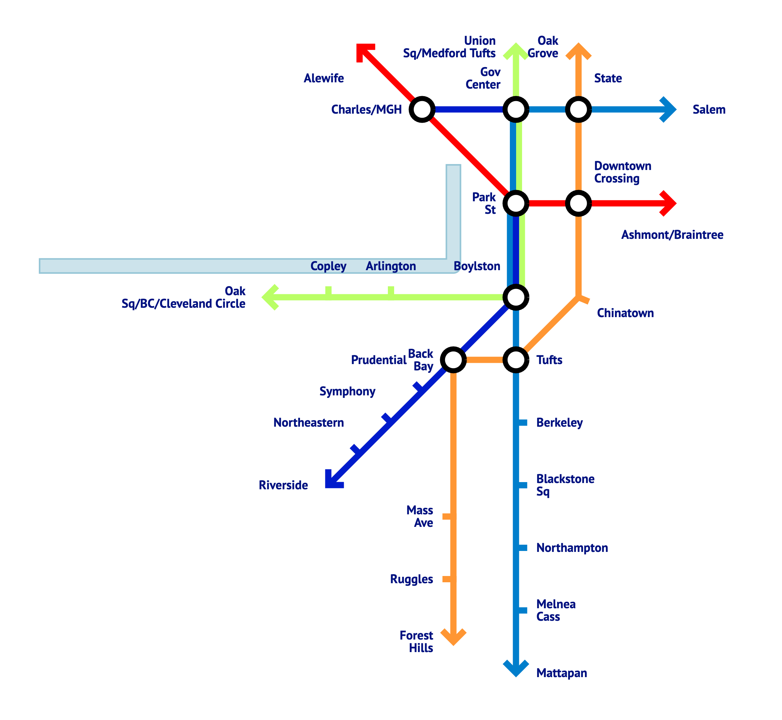

This is honestly so much of a crackpot idea that I'm not sure where it belongs, it's originally somewhat based on a bad idea from someone who is extremely anti-Green Line on Reddit. I present to you GLRC but Blue Line:
A new flying Y junction would connect the Blue Line to the Tremont St subway, taking over the outer tracks through Boylston and through a new Washington St subway, continuing down to Mattapan. Is this a good idea? Probably not. Is it interesting? Definitely yes.
I like the Oak Square restoration of Green Line service. I like the Blue Line extensions to Charles and Salem. I can get behind the D-E interlining. I like that there is rapid transit to Mattapan. The rest of it is highly questionable, though.
Those are really just side notes. The Blue Line to Boylston is the main idea, and you're absolutely right that it's highly questionable. A less questionable version might be something like doing GLRC but sending the Arborway branch up through Longwood/Fenway, then using high floor vehicles on Huntington/GLX/D branches, but that leaves you stuck with high floor vehicles on a Washington St route which could be fine or even preferable for the first section to Nubian but less great once you're paralleling the Fairmount Line and more frequent stops are better.
