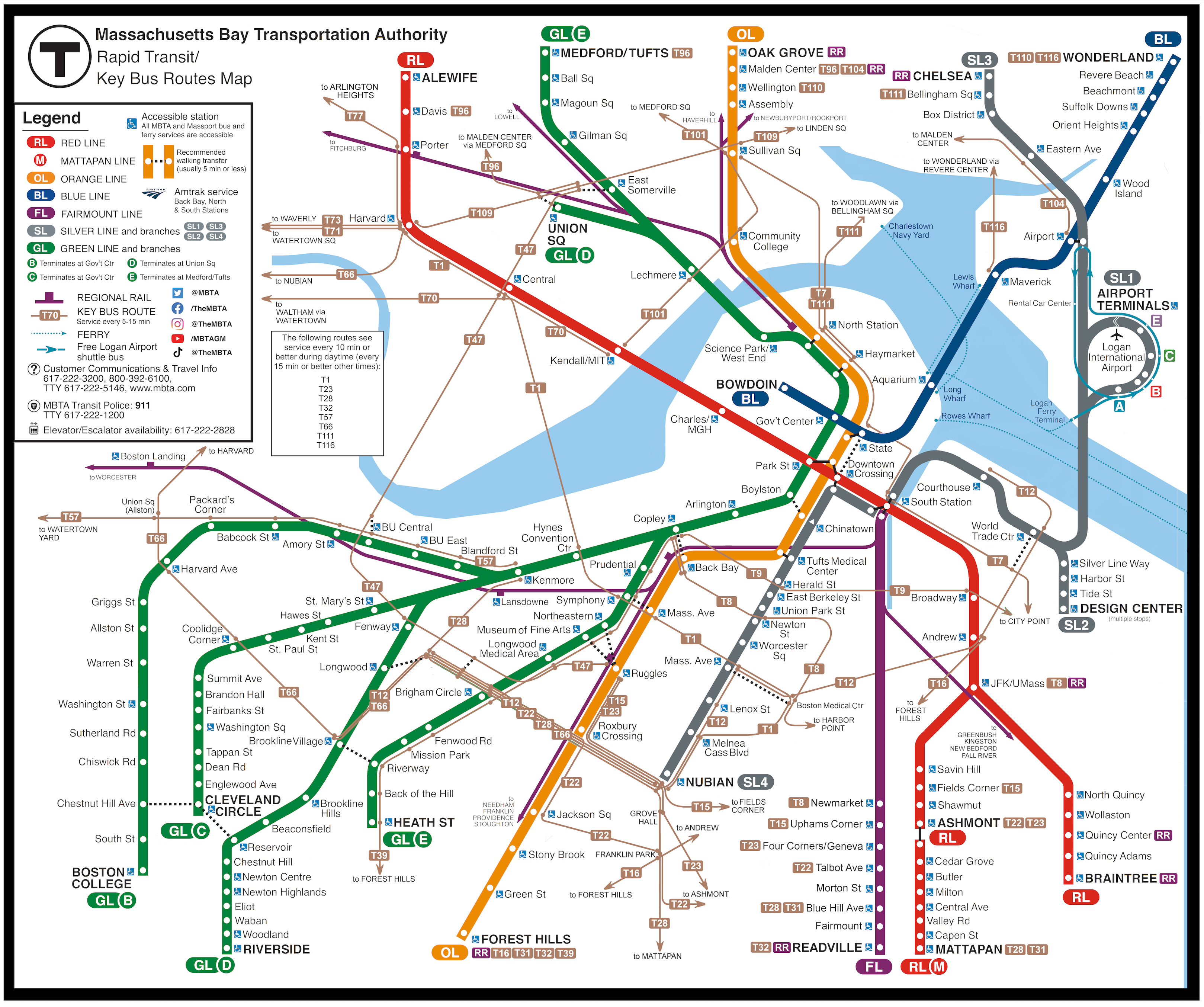

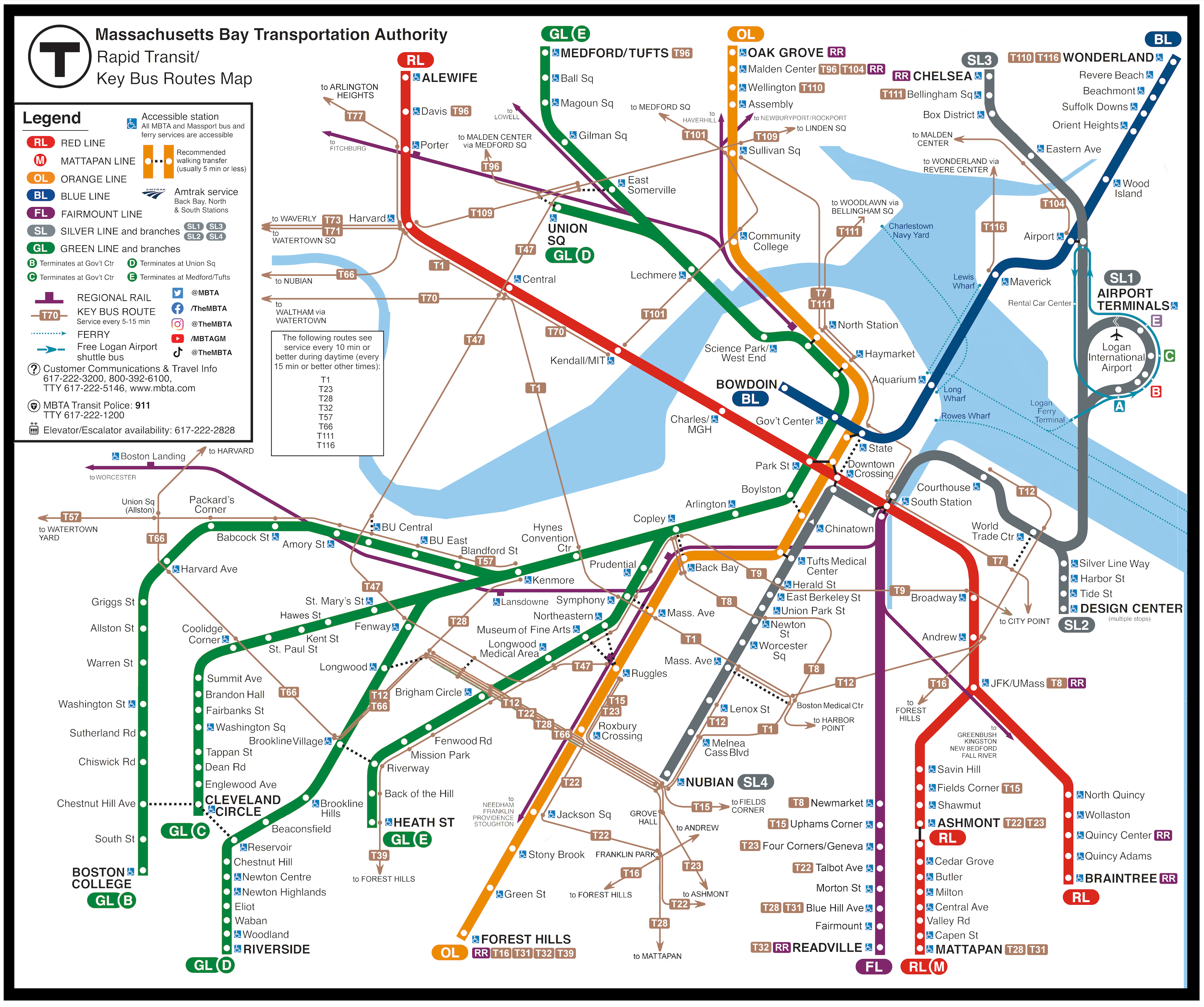

First: I redesigned my redesign of the MBTA system diagram from earlier this year. Two versions included at the link, but the "latest and greatest" (which I may have already posted upthread in here, not sure if it was this specific one though) is:
Excellent work! The dark background works quite well. I think we have our differences on a general "Vision" (More spider-webby light rail focused vs more concentrated heavy rail) that have been discussed and debated plenty, so I won't focus on that, I'll just touch on the general design:
  • I think this map does a good job balancing geographical accuracy with showing accurate service patterns, although I think this goes out the window a little bit the further east you go. I keeping the geographically accurate style might require enlarging the map and shrinking the size of some elements.
  • Transfers: The solid black lines for subway transfers work quite well, but I think the smaller dots for buses and especially the way the CR is handled are somewhat lacking. North Station in particular feels quite unclear, and the dots at major bus transfer points like Longwood or Nubian end up too bunched and scrambled to make sense.
  • Should the box describing which key bus routes have better than 15 minute service exist? Having good service is what makes a key bus route a key bus route with the BNRD, it feels somewhat redundant.
  • Should walking connections be specifically highlighted? On a map focused much more on geographic accuracy than the current map it again feels quite redundant
  • On geographic accuracy: I think you've maybe swung a little too far in that direction with the GL branches at the expense of transfers that are made much more commonly along the RL and FL. Showing the connections between the buses at Nubian and the FL/RL would likely be much more useful, and almost certainly better utilized, than connections like Riverway-Brookline Village. Maybe it's better to make some parts less accurate?
  • Not having the CR lines continue to the end of the map feels like a mistake to me. At Readville for example it's impossible to tell what CR line(s?) you can actually transfer to.
  • If the Fairmount Line is receiving the same treatment as the rapid transit lines on this map I think it deserves a new color. The merge at South Station with the CR lines merging into the FL is somewhat confusing. However, if this is a map of the current situation I think it should be treated like the other CR lines, given the... shall we say, somewhat lackluster service.
  • Only having the Amtrak label and transfer points, not on the map itself, make it harder to find for someone not familiar with the system.
  • I think the truncated bus routes with arrows are overused. I like them for routes like the 57 or 77 where they just head off into the abyss, but for routes like the 16 or 39 where Forest Hills is right there, it's just needless complexity and text on the map.
And now the real nit-picks
  • I really think the rounded of the termini on the current map is better than the square ends, especially with the more rounded look of the current map generally. I think they work better the spider-man inspired version.
  • The arrow at Chinatown on the SL isn't mentioned in the legend
  • The Hingham/Hull ferries are shown, but not labeled.
  • "BrooklineVillage"
  • The buses, especially the Logan shuttle, would be easier to see if they had a white buffer around them as they crossed rapid transit lines.
  • No line for the 32?
But I don't mean to over criticize, I really like the emphesis on geographic accuracy, it's a different way of doing things that I think can make a truly excellent map if it's fully committed to.
I think this question has more to do with the massive geographical distance to the south between OL, Fairmount and RL, and the massive number of Frequent Bus Routes that run there (which itself highlights needs for better transit). The only way to map out all the bus routes with any hope for clarity is likely to expand the "geographically accurate" zone significantly, possibly all the way to Ashmont and Mattapan.
An argument can be made about compressing the Green Line branches and making them not geographically accurate, but the limiting dimension on this map is north-south and not east-west.
Thanks for pointing this out. I noticed the headway info when viewing the Remix map in the past, but wasn't (and still am not) sure if they're intended to be accurate. Too many routes had a very similar schedule of 25 min during peak and 50 min midday, so I didn't know if they were placeholders. But looking at the data again, yes, it seems quite plausible to be the source of data that @Riverside used.
@TheRatmeister, agree with most of the points you raise. The concept I was trying to explore with this diagram was to have an inner section with geographic accuracy and visual bus lines, and an outer section that would be more diagrammatic, less geographically accurate, and would mark bus transfers and CR transfers. That idea worked... to a certain extent. I was hoping to create a subtle but distinct visual boundary between those zones, but it didn't turn out to be distinct enough to be obvious why the bus routes (and CR lines) peter out randomly.
But to your point about showing connections to the Fairmount Line and Red Line, that's what these flags are intended to show:
I experimented with drawing the bus lines all the way to the outer Fairmount and Red Lines, but found that it ran into the same problems I have with the current official diagram:
^ I don't feel that there is enough visual structure when it's diagrammatic to this extent.
If I make a new version from scratch, I'd experiment with keeping geographic fidelity down through more of Dorchester, but I think at that point the map will be 70% geographically accurate, so...

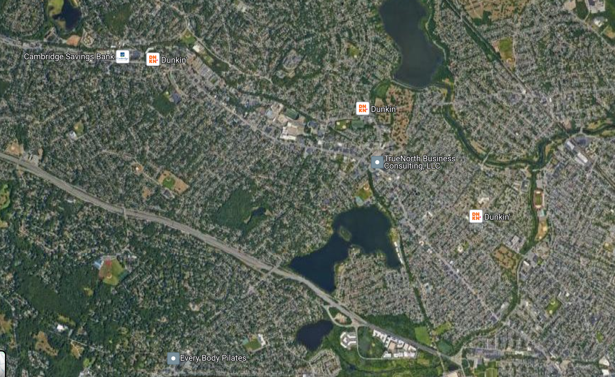

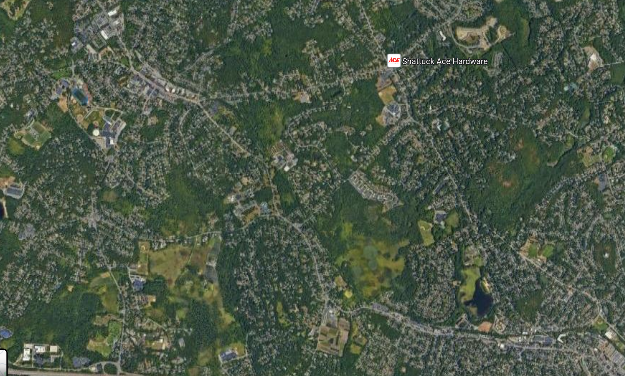

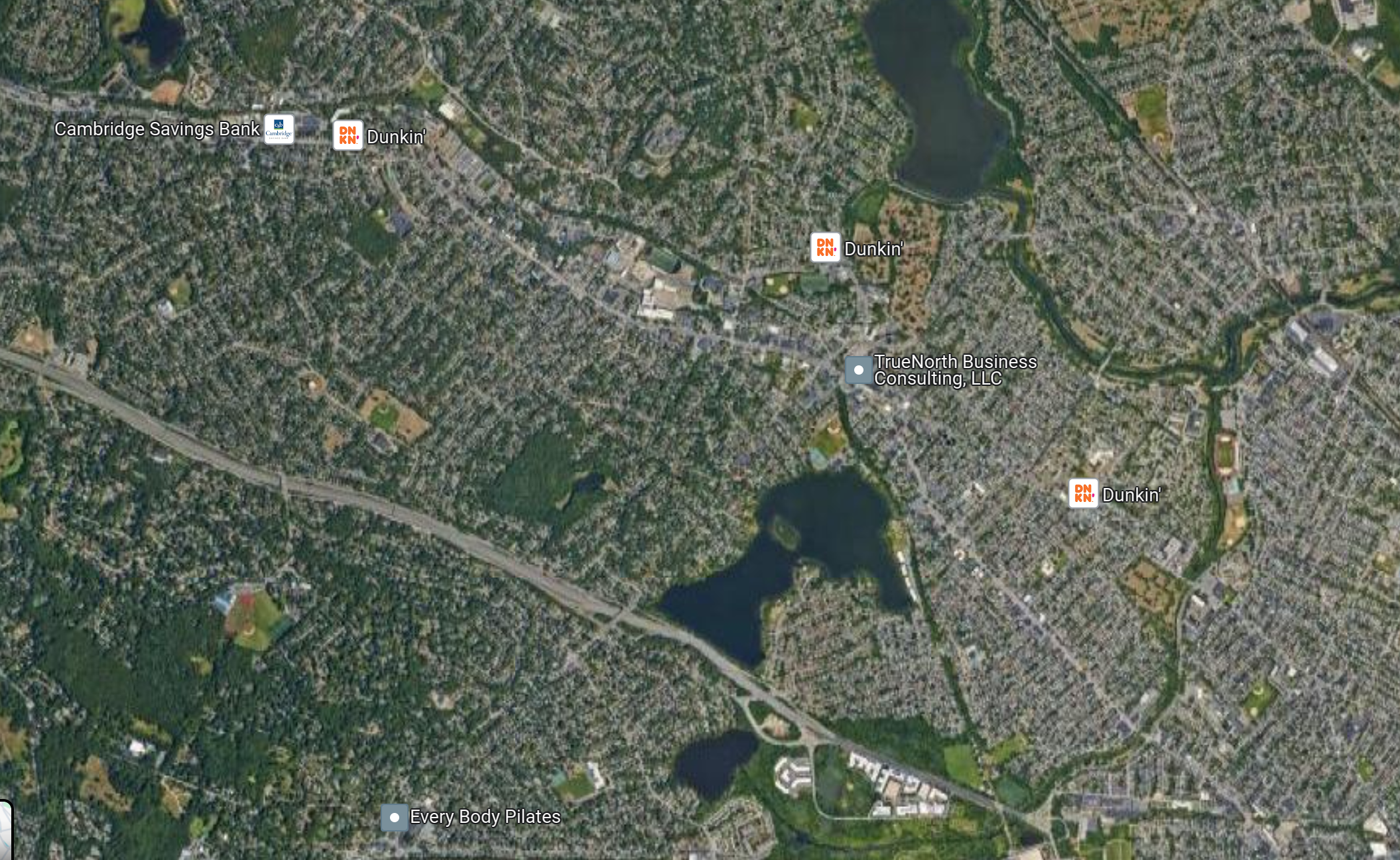

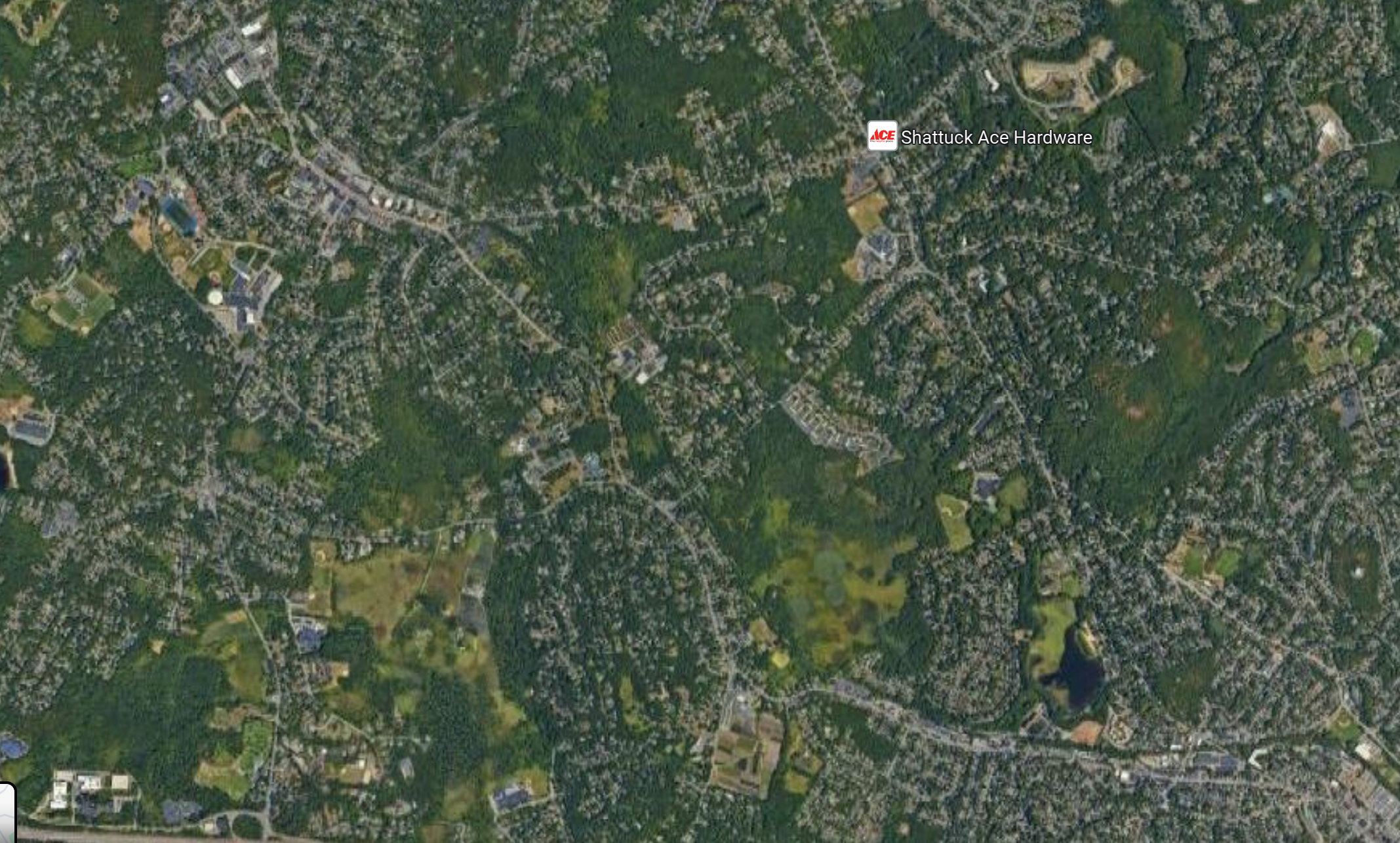

Idk. This much greenspace just seems at odds with heavy rail:
(Compared to Arlington, below)
FWIW, I think this much green space means that in a very very speculative far-future world with proper zoning, a transit extension to Lexington has higher potential for TOD than Arlington. (I know, I know.)
