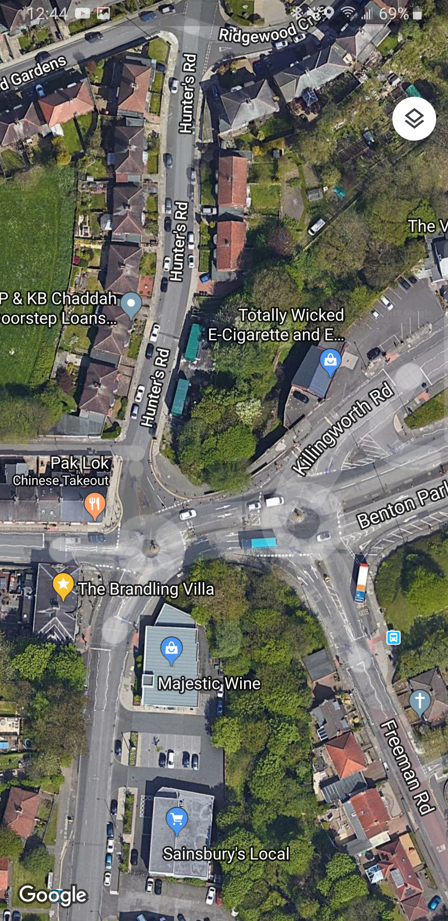

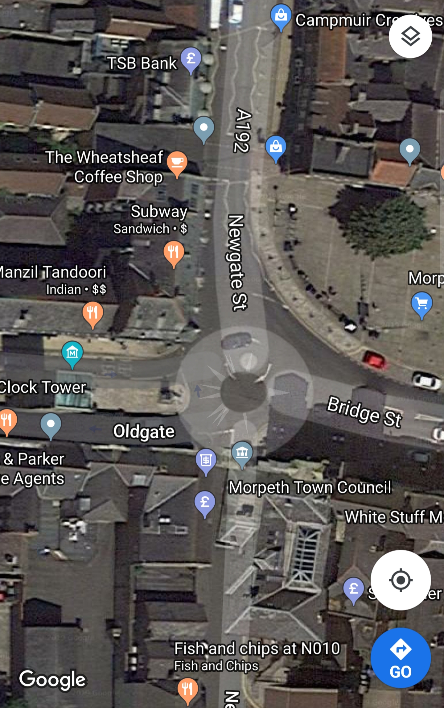

Correction: there's no room for American roundabouts. A British mini roundabout can fit in the smallest of British town squares all they involve is painting a circle on the road and some yield signs. Of course they have their own fair share of problems so I'm not advocating for them either.
And of course that leads to the uniquely British double mini-roundabout near where I used to live:
Absolutely would not recommend that. Which only spreads to this hellhole:
However I am glad to see MassDOT does consider roundabouts for small intersections now. Implemented correctly they can be both traffic/speed calming and congestion improving.

Correction: there's no room for American roundabouts. A British mini roundabout can fit in the smallest of British town squares all they involve is painting a circle on the road and some yield signs. Of course they have their own fair share of problems so I'm not advocating for them either. View attachment 1598
Those look like pedestrian hell. And it's worth noting that the UK is on a trend of tearing up roundabouts out of concern for bike and pedestrian safety.
