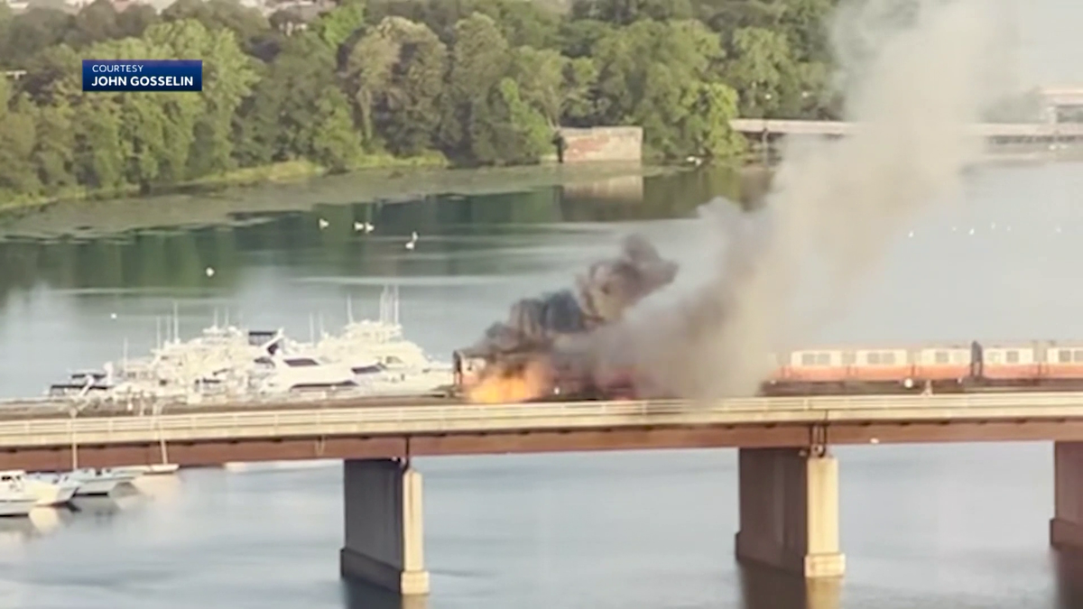

Honestly, that might very well be a proximate cause of this; per NE Transit the 1400s are due to be scrapped starting next month in batches of 30, so I doubt they're getting lots of maintenance attention. Looking at that fire, it looks like electrical arcing, and while I'm far from an expert I'm willing to say that skimped maintenance, plus heat related reduced tolerances, added up to something catching the third rail....I'm guessing this is an incident that having the new trains come in would resolve it. But the old trains needs to stay functional and safe until it's enough are them are here.
Just quick note on a typo, the last inspection was June 23, 2022, less than a month ago.Paraphrasing Poftak:
The train was last inspected June 23, 2021. A sill fell off the train, and all cars have been inspected for loose sills. Sills are not essential to the function of the train, but cover parts that do.
The motorman led evacuations, but a few people took it upon themselves through self-evacuation through 4 windows.
