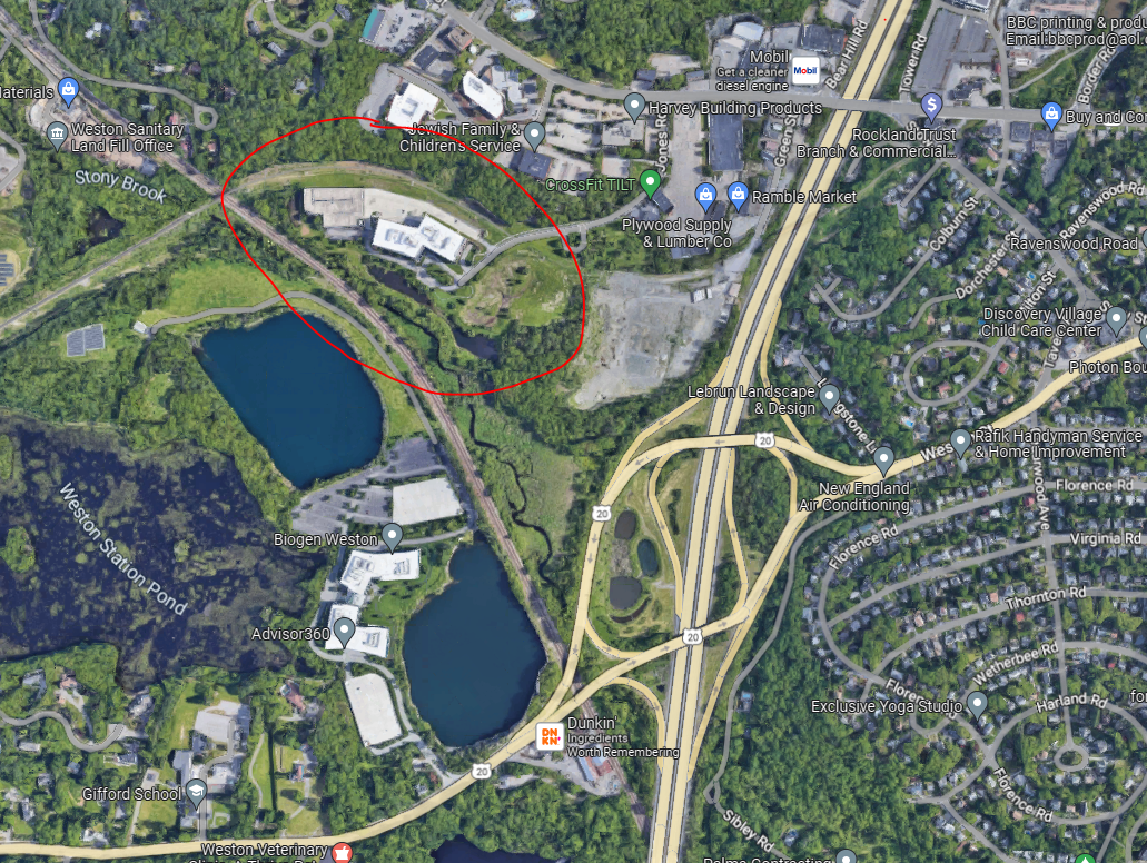

It looks like there would be enough room where this office building is, although the wetlands may prove difficult to build over/around. You would also need to redesign the interchange slightly to have access ramps, so it may be getting into more crazy transit pitch territory. I think Brandeis/Roberts would be far enough but you'd have to close Kendal Green. This spot would be a good anchor for regional rail inbound every 15 mins or so to NS.
That is the exact parcel where a station has been officially proposed: http://www.mapc.org/wp-content/uploads/2017/11/128_Report.pdf. (See p.38 of the PDF.)

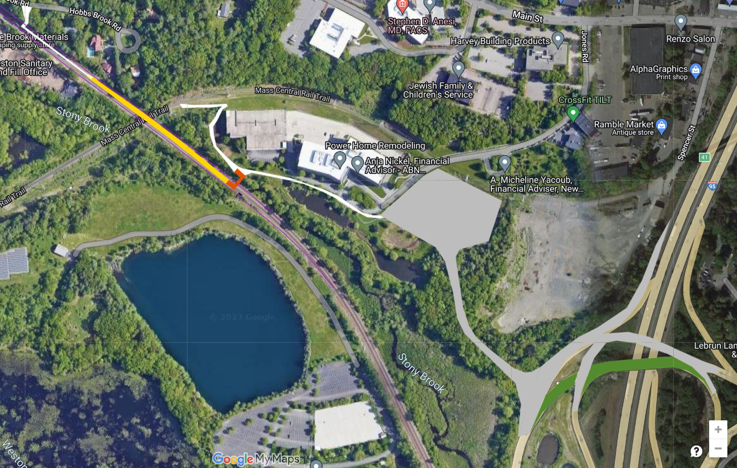

10-minute sketch of how you could make it work. Basically just expand the size of the rotary to give you enough room for a junction with the access road. Not exactly going to make the interchange better, but I can't imagine it would make it much worse. There aren't going to be too many people driving from the south (since Riverside is closer to the Pike), and hopefully those closer to downtown Waltham can use buses to get there, so I would hope that will limit the amount of traffic having to do the additional weave to get to the station.
The station should be an island platform so that terminating trains can use either track. There's probably enough room under the existing trail trestle to widen the tracks and add the platform, but it's not a majorly historically valuable bridge. Up and over at the southeast end, and a gated grade crossing for the handful of pedestrians walking from the Kendal Green area.
The folks on Hobbs Brook Rd would have a coronary over that secondary entrance.
