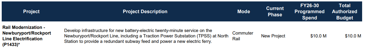

Building a substation to power the orange line and a ferry and somehow claiming it has something to do with electrifying the Newburyport line is interesting.
I mean, they're not proposing a new one - there's already an Orange (and Green) Line substation in the North Station basement. Unless I'm very mistaken, it's even fairly new - it was rebuilt as part of the 2004 superstation. This diagram predates that, but is likely still largely accurate - North Station is a major node in the power system.
The catch is, it's fed by ancient cable from the South Boston Power Complex. That's failed a few times in recent years, to catastrophic effect, and so cable replacement features heavily in the CIP. Also, the existing infrastructure isn't going to have nearly enough power to feed the demand from charging BEMUs in the North Station terminal district. After all, there's a reason why GLX substations (too new to be shown) are fed by Eversource. The T's existing power system just won't stretch to supporting it, BEMU charging or OCS so either way you're going to need to build a pretty substantial expansion in electrical infrastructure at North Station by bringing in a high voltage line from a utilty.
I'd weight the "develop infrastructure" bit of that CIP line more heavily - I read it as basically an early action with side benefits. Notice how little green (Ie, redundant external utility connections) there is on that diagram? Sizing the connection to provide the NS OL/GL substation with a redundant power supply from Eversouce concomitant with bringing the power needed for the future North Station terminal district seems prima facie reasonable to me.
The
The southside supplies the entire terminal district from a 25 kV Amtrak substation way out in Sharon that covers 30 linear miles of wires end-to-end, so there's nothing saying that there needs to be a sub sited right at/near the terminal district to provide adequate power. They wouldn't need to build any Regional Rail subs at North Station or Boston Engine Terminal at all if the stupid discontinuous electrification plan didn't leave Somerville-Chelsea un-wired in pants-shitting fear of undercutting 3 measly Sullivan Square overpasses. Now they're going to have to put a regular sub in Chelsea/Revere AND augment the terminal district with one for charging instead of just letting the Chelsea/Revere sub be built out like to-be-expanded Sharon to cover everything for 15 miles in each direction. This is where their claims of "cost savings" from batteries starts to come completely unglued.
I also highly doubt that the North Station sub work is even going to provide a capable feed for BEMU charging. 600V DC traction subs are radically different from 25 kV AC traction subs. It's not like you can build one to safeguard the subway's power draw and just use the slack to charge BEMU's. It would have to be a completely separate and other sub from the existing 600V DC network, and there's not likely enough room for that at North Station.
The
You're not wrong regarding the short gap in the discontinuous electrification plan being illogical, but I would point out that the 2022 Network Rail analysis of just the Providence/Stoughton Lines indicated that running on OCS would require an infill substation in Roxbury, let alone electrifying something the size of the proposed Widdet Circle yard. The same applies to the Northside; I actually think the NS sub would be at the CR shops where there's a better grid connection, then just cabled over.
As far as the transit sub goes, it provides 600V DC to the 3rd rail/GL catenary, but everything in the distribution network until the TPSS is 13.8kV AC, every line in red on that map; I believe it's rectified down to 600V DC at the unit sub level. I would point out that some substations like those from Oak Grove to Wellington are clearly missing, but I believe those, like GLX, are directly utility fed with 23kV, stepped down to 13.8kV.
In essence, I'm not expecting them to power the NS Regional Rail sub off of the Transit side, I'm thinking the opposite. I'm expecting them to bring in something along the lines of a trio of 25kV lines for the RR side, and add in the switchgear and a 25-13.8kV stepdown transformer. That's actually fairly limited as far as equipment goes - I imagine the NS basement is roomy enough that they have the slack space. and would enable the transit side to fail over to the RR side when one of the South Boston lines goes offline.
You're not wrong regarding the short gap in the discontinuous electrification plan being illogical, but I would point out that the 2022 Network Rail analysis of just the Providence/Stoughton Lines indicated that running on OCS would require an infill substation in Roxbury, let alone electrifying something the size of the proposed Widdet Circle yard. The same applies to the Northside; I actually think the NS sub would be at the CR shops where there's a better grid connection.
Standard 25 kV railway electrification takes 115 kV single-phase from the utility and puts it through transformers to 50 kV traction voltage (which is then distributed to the trains at 25 kV)...the world-standard "2 x 25" scheme. So it's still quite a bit different from the T's entire rapid transit electrification infrastructure with that whole maze of 13.8 kV interconnects. The nearest 115 kV utility source is Hawkins St. substation by Bowdoin, which is close to North Station but a fairly small neighborhood substation that probably doesn't have capacity to spare for the T's appetite (or else it would've been tapped for redundancy long ago). If not there than they'd be tapping the vastly larger regional source at next-closest Mystic Generating, which lends itself much more to a traction sub sited in Somerville than North Station. If they were planning for the RR side to backstop a disruption on the rapid transit side, they'd be doing this at the nearest GLX substation instead of at North Station.
So no, I don't think it's very likely that that this CIP line item has fuckall to do with BEMU's.
