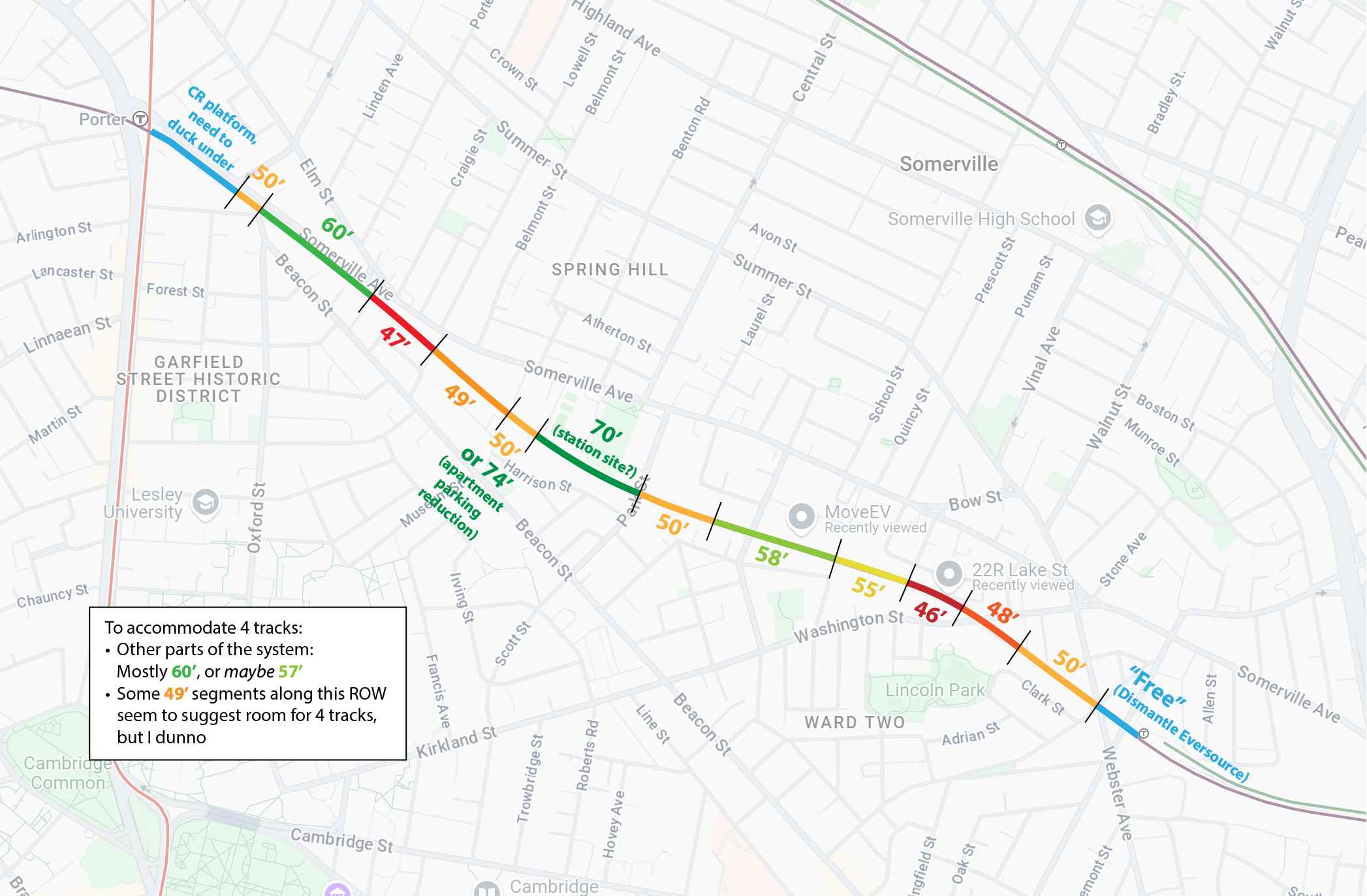

Here are the "reasonable maximum" widths that you can get without heavy disruptions:
With a few exceptions, most of this ROW are 46-50 ft wide. Some of these pinch points are building-to-building, and occur throughout the route.

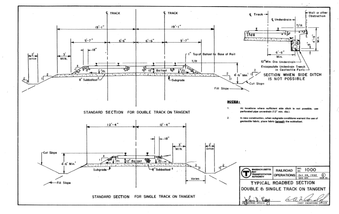

How wide must a ROW be to accommodate 4 tracks? I don't know, but here are two pieces of conflicting evidence.
On one hand, I looked at other quad-tracked parts of the system. I'm inclined to think of 60 ft as a safe requirement for 4 tracks. Some arguments exist for getting down to 57 ft, but they're uncertain and subject to parallex errors, etc.

49 ft vs. 57 ft seems like quite a big discrepancy. So... I dunno. Perhaps others with more engineering expertise, like @F-Line to Dudley, can explain?
Regardless, this section further west is only 47' wide, and looks even less promising.

ParcelsSatelliteReasonable maximum (with simple parcel purchases, parking eliminations, etc.)
Prospect St - Webster Ave
(will need widening regardless)
50 ft42 ftarbitrary
Webster Ave - Washington St50-66 ft49-66 ft48 ft or less
Washington St - Dane St47-54 ft37-57 ft46 ft at the turn, 55 ft west of the turn
Dane St - Park St45-54 ft50-56 ft50 ft
Park St - Kent St52-81 ft50-75 ft70-80 ft for the most part, 50 ft or 74 ft to the west
Kent St - Lowell St52-59 ft with parcel purchase, 45-50 ft without49-59 ft49 ft
Lowell St - Beacon St47-70 ft47-50 ft47 ft to the east, 60 ft to the west
Beacon St - before Porter CR55 ft50 ft50 ft

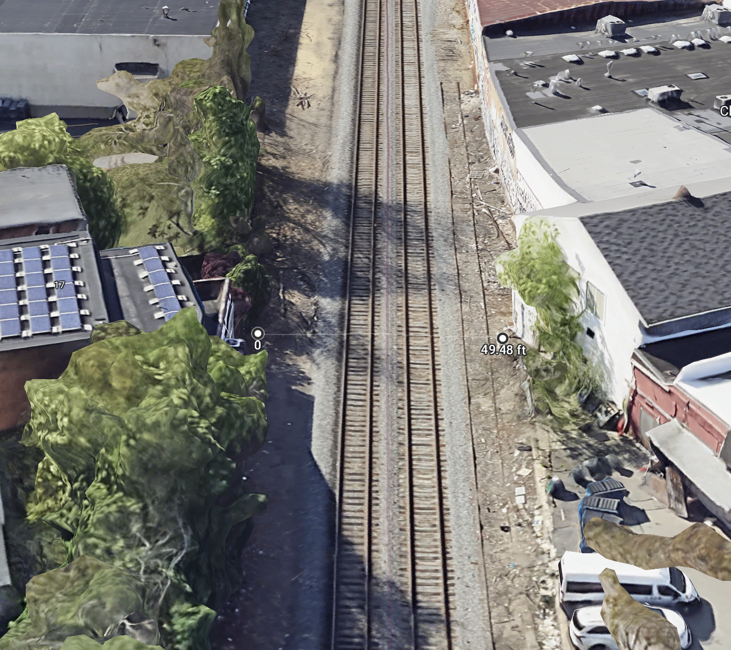

      • The pinch point is at 15 Webster Ave / 23 Clark St, with 49 ft between track boundaries

    • That said... At this section, you can clearly see remnants of a 3rd track to the north. Space to the south looks about the same, so perhaps a 4th track can be added. So perhaps fitting 4 tracks in 49 ft may be possible after all?

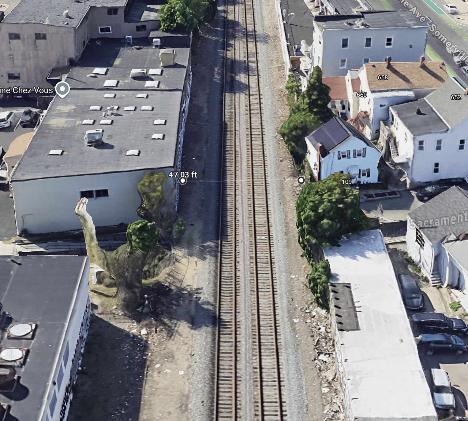

      • 47 ft is indeed the pinch point between 7 Miller St (building) and 109 Sacramento St (house)

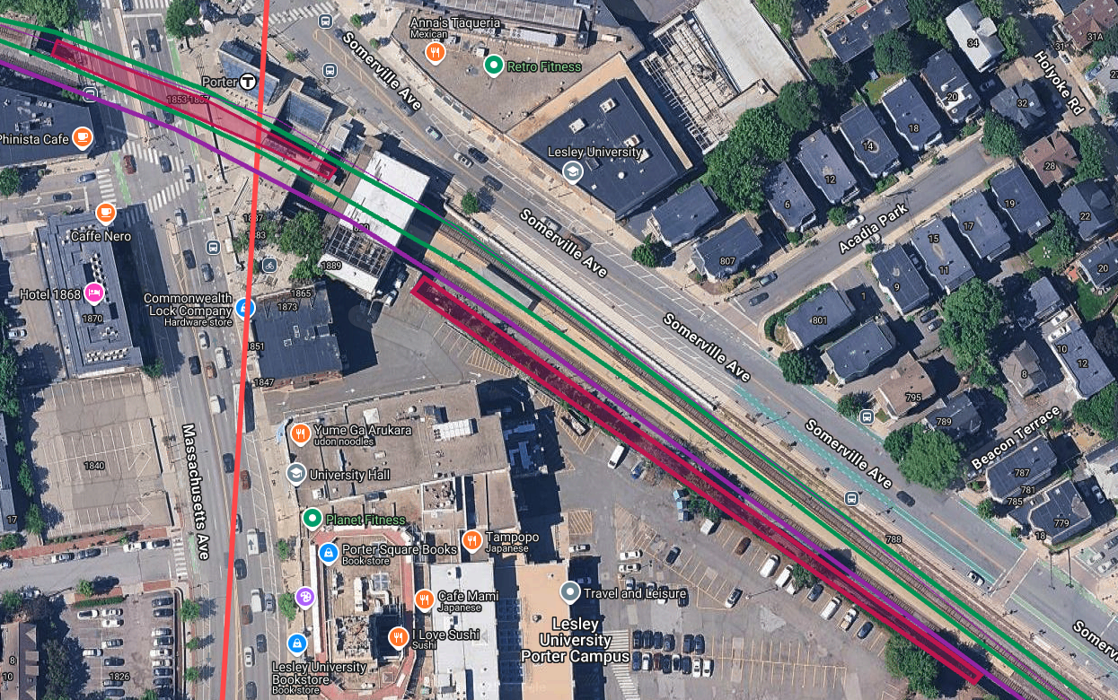

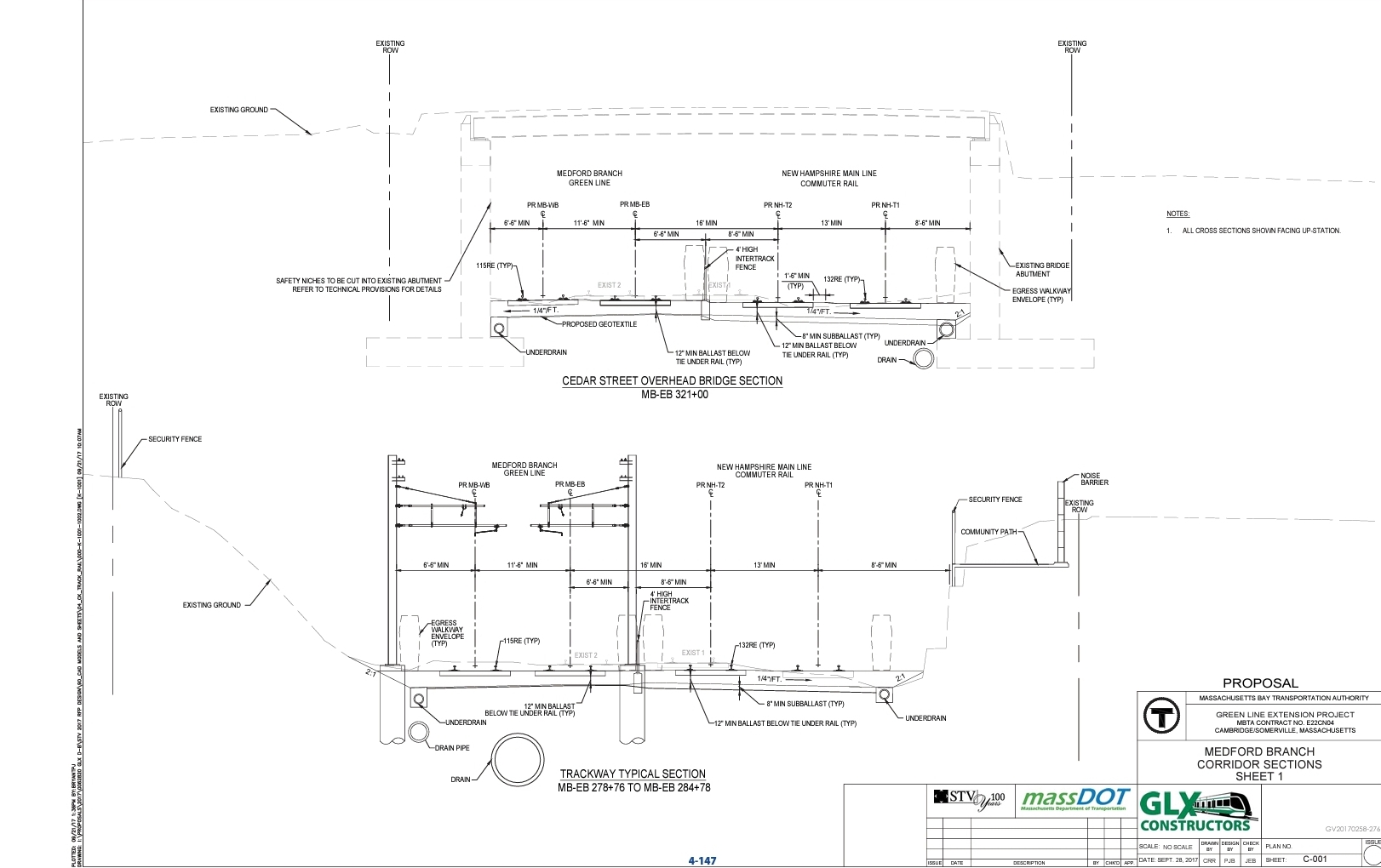

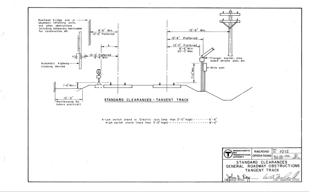

GLX adopts the Commuter Rail Design Standards Manual for its horizontal clearances, so there wouldn't be a mode difference for new construction. Applying math to their schematics for tangent double-track, 49' would be doable if the drainage channels are engineered directly underneath the tracks instead of to the side. That would slightly increase cost and might make utility co-placement a little harder, but it wouldn't affect overall feasibility. Curvature increases the clearance allowance very slightly, but you don't have any curvature on this ROW except for the 46' section north of Washington where some rear parking spots might need to go and Conway Park Station where it's already 70'+. So maybe 3 pinch points total, plus the assumed Porter duck-under.
Doesn't sound fatal at all. If they managed to engineer a 4-track ROW on the Medford Branch with the Community Path in the mix without getting killed on property acquisition costs or controversies, this extension really shouldn't faze anyone.

    • Per parcel boundaries, the narrowest was 60 ft:
      • Between Gilman and Magoon (on a curve)
      • North of Ball Sq
      • (There's a brief 46 ft section between parcel boundaries just south of Harvard St bridge, but that seems vacuous as one of the parcels overlaps with satellite images of tracks)
    • Per track boundaries on satellite images, the narrowest was 57 ft:
      • 60 ft at the Gilman-Magoon curve
      • 60 ft at Cedar St bridge
      • 57 ft south of Harvard St bridge
      • 61 ft just north of the Cross St bridge -- but this one has a bit of slack on both sides of GLX tracks, and can possibly be compressed to 57 ft if necessary
  • Old Colony main line, with RL Braintree Branch involved where applicable:
    • Per parcel boundaries, the narrowest was 59 ft:
      • 59 ft just south of Redfield St bridge
        • The parcel boundaries briefly narrow down to 57 ft after that, but it seems somewhat vacuous
      • 60 ft at Walnut St bridge
      • 47 ft for 3 tracks south of Adams St bridge (upscaled to 62.7 ft for 4 tracks)
      • 45 ft for 3 tracks at Granite St bridge (upscaled to 60 ft for 4 tracks)
      • 45 ft for 3 tracks at Hannon Pkwy bridge (upscaled to 60 ft for 4 tracks)
    • Per track boundaries on satellite images, the narrowest was 58 ft:
      • 61 ft at the Bass River bridge (4 mainline rail tracks)
      • 75-78 ft for 5 tracks north of Sevin Hill station (downscaled to 60-62.4 ft for 4 tracks)
      • At most 60 ft at the southbound Morrissey Blvd bridge
        • A bit of slack in both construction and measurements, may narrow down to 55 ft (low confidence)
      • 58 ft at Redfield St bridge
      • 59 ft south of Billings Rd (south of North Quincy), just north of where Old Colony merges back into single track
  • Southwest Corridor:
    • Per parcel boundaries, the narrowest was ~59.2 ft:
      • 74 ft for 5 tracks at Carter Playground (north of Ruggles, downscaled to 59.2 ft for 4 tracks)
    • Per track boundaries on satellite images, the narrowest for 4 tracks would be 56 ft, but uncertain:
      • 70 ft for 5 tracks at Carter Playground (north of Ruggles, downscaled to 56 ft for 4 tracks)
      • 77 ft for 5 tracks at and north of Heath St (downscaled to 61.6 ft for 4 tracks)
      • 76 ft for 5 tracks south of New Minton St (north of Green St station, downscaled to 60.8 ft for 4 tracks)
On the other hand, this section along the Fitchburg ROW itself clearly shows traces of a former 3rd track. The space on the other side of the ROW seems similar, meaning a 4th track can possibly fit there. But the ROW is only 49 ft wide here.
Specifically, the GL standards call for 11' per track minimum spacing on center, 12' preferred net of catenary poles and fencing. Much of GLX was built to 11'6", so it's probably safe to say 24' inclusive of poles. Double Commuter Rail track is specified at 13' on center, 8'6" min (12' preferred) net of side obstructions. I think the problem is they're engineered it as two parallel but separate RoWs, with individualized clearance requirements for both GL & CR, likely for maintenance reasons. Based on those numbers, I get a minimum of 52 feet. Add back some space for catenary and signals, and 58-60' is your mark.
Looking at the GLX cross section, it appears they settled on 55'6" as their minimum cross section for the NH Main + GLX, and similar makes sense for GLX Porter and Fitchburg.
Working off this, if we assume that each GL track is 11' wide (minimum spacing, narrower than the eventual design), each CR track is 13' wide, no additional clearance outside any tracks (even the two outmost tracks), and catenary and signal poles take no space, we get... 48 feet.
So yeah, looks like that might be doable for the 49' segments, with the caveat that any additional clearance requirements would likely be extremely tricky.
Could the 13' spacing for CR be plausibly reduced, or is that already the bare minimum? I'm having trouble reconciling the clearly different design standards for GL and CR tracks in the charts above, versus F-Line's comment here:

Instead of trying to cram in the 4 tracks and engineer a new Porter platform above or below (which seems to me like the biggest headache of this whole thing), would it be possible to single-track the Fitchburg line between Union and Porter? This way, you have a lot more breathing room through the corridor and with some reworking of Porter maybe you could even fit both CR and GL platforms on the same level (not parallel of course, but perhaps either side of the current mezzanine. Or maybe even reconfigure and shrink the CR platforms for GL use).
We've talked here about how single track is doable for RER frequency as long as the segments are short and there are stops on either end to time trains. The Salem tunnel, to be specific, is about 0.8 miles of single track from what I can tell (but about 1.4 miles from the proposed South Salem station to where it is double-tracked again north of Salem station. Union to just past Porter, where the ROW is large enough for 4 tracks, is 1.4 miles. Coordinating this segment all the way from North Station seems like a mess and I've read F-Line's post about why a Union Square infill is a hard no for now. However, I'm curious to y'all's opinions on whether it would be possible/preferred to sacrifice one CR track, build Union Square CR infill, and slightly rework Porter on one level, compared to trying to fit 4 tracks down the ROW and create a whole new level for platforms somewhere around Porter.
Or potentially a hybrid model where there is a Regional Rail passing track somewhere in the ROW between Porter and Union (assuming some part of the ROW is a bit wider)?
Yeah. Keeping the CR mode operating--and operating at nearly full double-track capacity--during the week throughout construction definitely widened the clearance tolerances a lot for that project. The most they could do around a weekend outage was temp-move short lengths of CR track around discrete construction zones; they couldn't dig under and re-engineer the entire trackbed at once to do things like self-contained drainage channeling. If you could stand to have the Fitchburg Line truncated to a Porter-Wachusett shuttle for several months at a time and use the Alewife maintenance yard as a temp inner layover, you would probably be able to engineer a significantly narrower ROW at the pinch points by virtue of having the full ROW all available at once for construction activities in 3 dimensions down to the soil base.
It would be interesting (and probably impossible to get it going so quickly) to do this along with the Draw One bridge project at North Station. I think they're going to keep all 4 tracks over the Charles running during weekdays and 2 tracks on the weekends during the construction of the bridge (10 years?). In a perfect world where projects could start tomorrow, couldn't it help both projects if they happened at the same time?
The Porter platform would have to be double-track to fit :15 service on the inner Fitchburg Line, and that puts you immediately out of space here to squeeze the Green Line at-grade. There will definitely be opposite-direction meets around stopped trains with a schedule that dense. The Salem tunnel isn't an applicable comparison, as that's a very short length where in-motion trains clear the single-track within seconds. The Salem comparison that matters is "Does the Salem mainline platform need to be doubled up?" to achieve :30 Rockport + :30 Newburyport = :15 Salem service. That answer is very likely a yes at Salem, and almost certainly a yes at Porter.
Is that even possible? Maybe a second track could be fit in, but not another platform.
They might have to take a sidewalk/path from the adjacent condo complex to make the new outbound side platform fit, but yes it's fully feasible. And they probably don't have a choice given that the odds of an opposite-direction meet with branching :15 service are so high.
