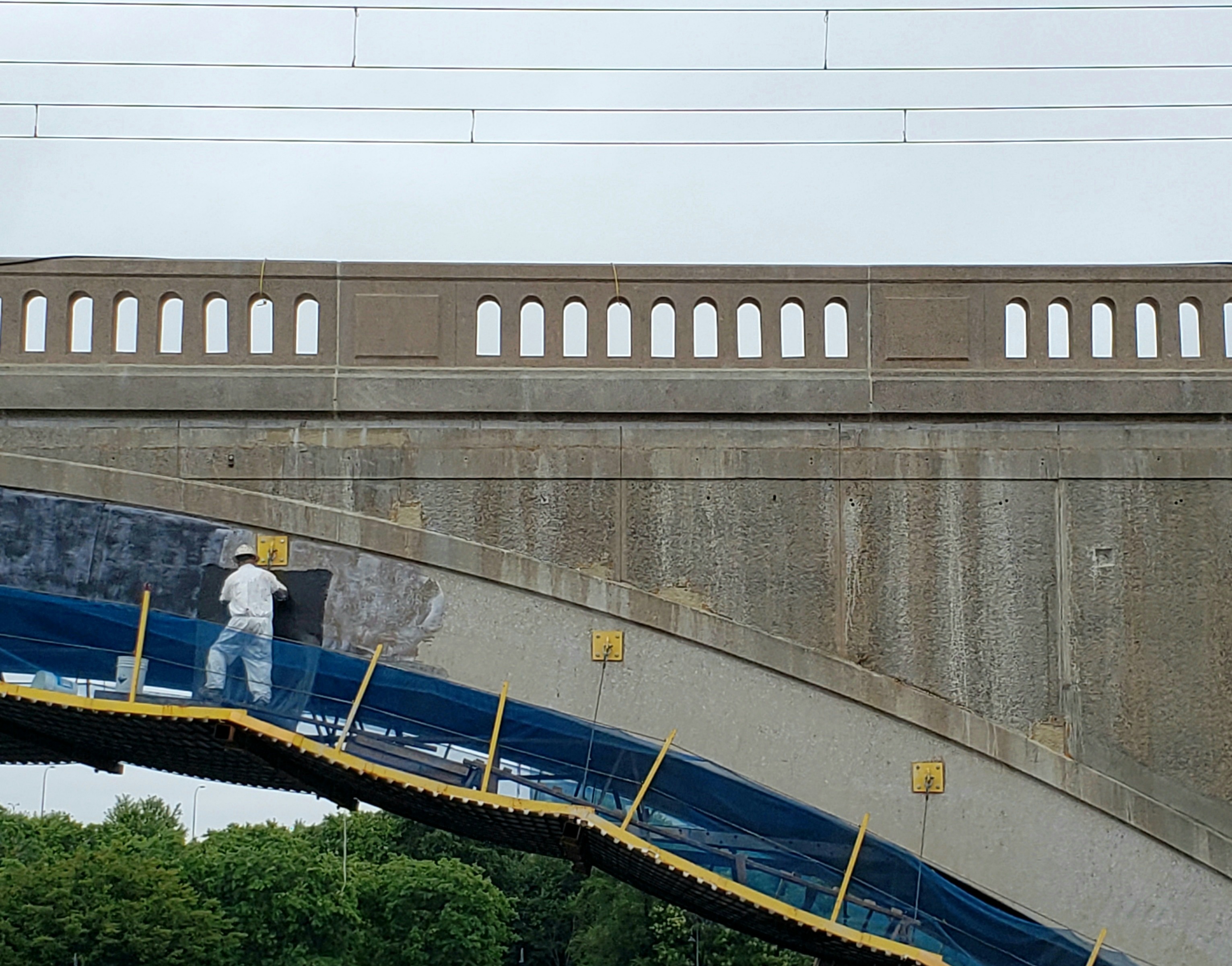

Based on this guy's PPE, this seems like some kind of acid wash to produce uniform appearance post-restoration (from today):
The consistency looks more like a poultice, which is similar to how people restore marble fireplace surrounds.
I still don't understand why they didn't go with a brownish integrally colored concrete. Some touch-up staining would have been required, but not so much.
It actually seems like they're doing both. Those guardrails/balustrades up top seem to have been re-cast and replaced. They were completely removed, with rebar sticking up, and now they're back. They've definitely been cast with a color tinted concrete, and the patches are all tinted brown as well.
You're right. The guardrails definitely look like they were replaced with integrally colored concrete. The same colored concrete should have been used for the archway portion (that the worker is shown applying the acid wash to).

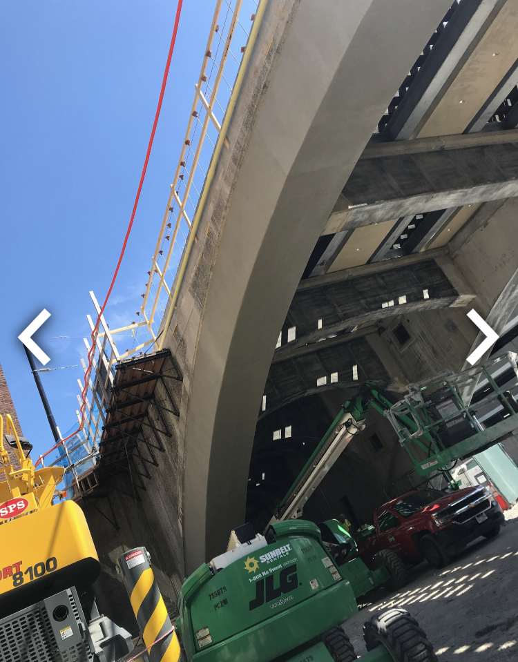

Hello, I've been lurking for a couple months but this was worth making an account for. The arches on this bridge are actually being strengthened with carbon fiber sheets. The white pasty stuff on the arch is the epoxy being used to adhere the carbon to the concrete, and the black sheet that the worker is holding up is the fiber that's about to go up. Then, the fiber will be sprayed with sand and painted over to match the concrete. I had a co-op the first half of this year working as a field engineer for the subcontractor doing this work. Here's the finished product on the span over the basketball courts, taken sometime late May:

Wow, really appreciate you making an account to share this. So, I am guessing that the portion of the arch in my photo to the right of the worker has been sanded smooth to accommodate this process?
Your photo above also shows what I was referring to regarding the old guardrails being removed.

Yeah, the existing surface had to be sanded down for the epoxy to adhere better. The guardrails were definitely replaced as well, though I don't know too much about the specifics of that that other than watching it happen.
It's a really cool system, I hadn't heard of using carbon fiber for structural applications at all before starting work on the job, it's mostly used for bridge or parking garage rehab as reinforcement.

I had no idea they were refurbishing it this extensively, looks like theyre really investing for the long term here. Great first post!
Funny thing is: I remember the articles back in 2019 when they said they’d be using Carbon fiber wrap, but at the time (and since) I pictured wrapping steel elements, not big concrete with big cross sections.
