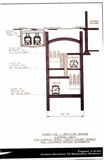

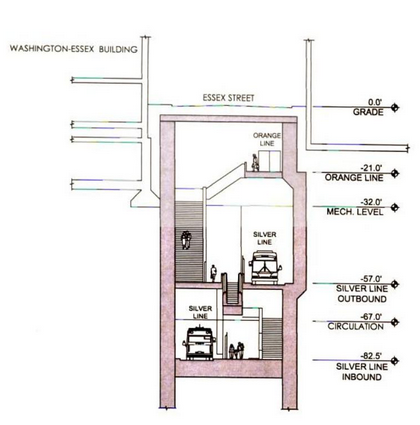

SL Phase III's tunnel bore interacted with building foundations at both Chinatown and Boylston stations, adding a lot of mitigation cost to the core segment. The project's tripling price tag between 2003-2009 wasn't all tied up in the flailing over portal locations; a good portion of it was the escalating mitigations on the mostly-settled core alignment. In both station cases the building foundations narrowly breached the level of the upper/outbound bores. Not by much--it was a scrape--but it happened and building-by-building across the Essex-Boylston corridor we don't know what the depths are on other buildings that veer very close to the tunnel.
Chinatown:
Boylston:
It's hard because these close-abutting foundations are fairly deep, and there are clearly some buildings on the corridor that go >30 ft. deep. Increasing the tunneling depth is only going to increase the grades already so close to the max limit for LRT, so that's not an unlimited solution either. The Phase III project as designed maxed out just about all the possible wiggle room on the core alignment, leaving little left to chance.
Do you know/did it state in the report if the existing buildings are bearing on spread footings or if there are timber piles underneath the footings that are not shown? It also appears in this section that the station construction was to use slurry walls, similar to big dig technique. Was that how they planned to build the entire alignment? That section leaves little room for construction tolerance, especially if there are timber piles underneath an existing building. The CA/T at least had a much wider ROW to work with.
No, the tunnels were mainly intended to be either mined or TBM'd. TBM technology especially hasn't just remained static for 20 years, so this part would likely need to be re-evaluated.
They would have to look at using a large enough diameter to fit the stations within the bore. That should mitigate the concerns over the adjacent foundations and leave a larger margin for error. Of course, the head houses will need to be excavated but I think there’s room for that at Washington st across from the 2 Chinatown head houses. The boylston station connection would be more difficult.

I believe the 2nd Ave phase 1 stations were cut & cover rather than mined, meaning maximum interface with under street utilities.
For our hypothetical tunnel, I'd actually probably say accept the disruption and launch our TBM by Boylston; if you're going to dig a pit, you might as well only do it once, and launch the TBM through what would become the station cavern, especially since you can usually back a TBM out (once disassembled.) Also, If my understanding is correct, the 1898-1920 Boylston Subway actually runs under the edge of the common, not the street itself, so you could dig a pit there. Disruptive, yes, but especially with recent movements towards shallow/surface launching TBMs, you're basically there once you clear the street utility layer - and something like a Rectangular TBM might be able to do it in a single pass.

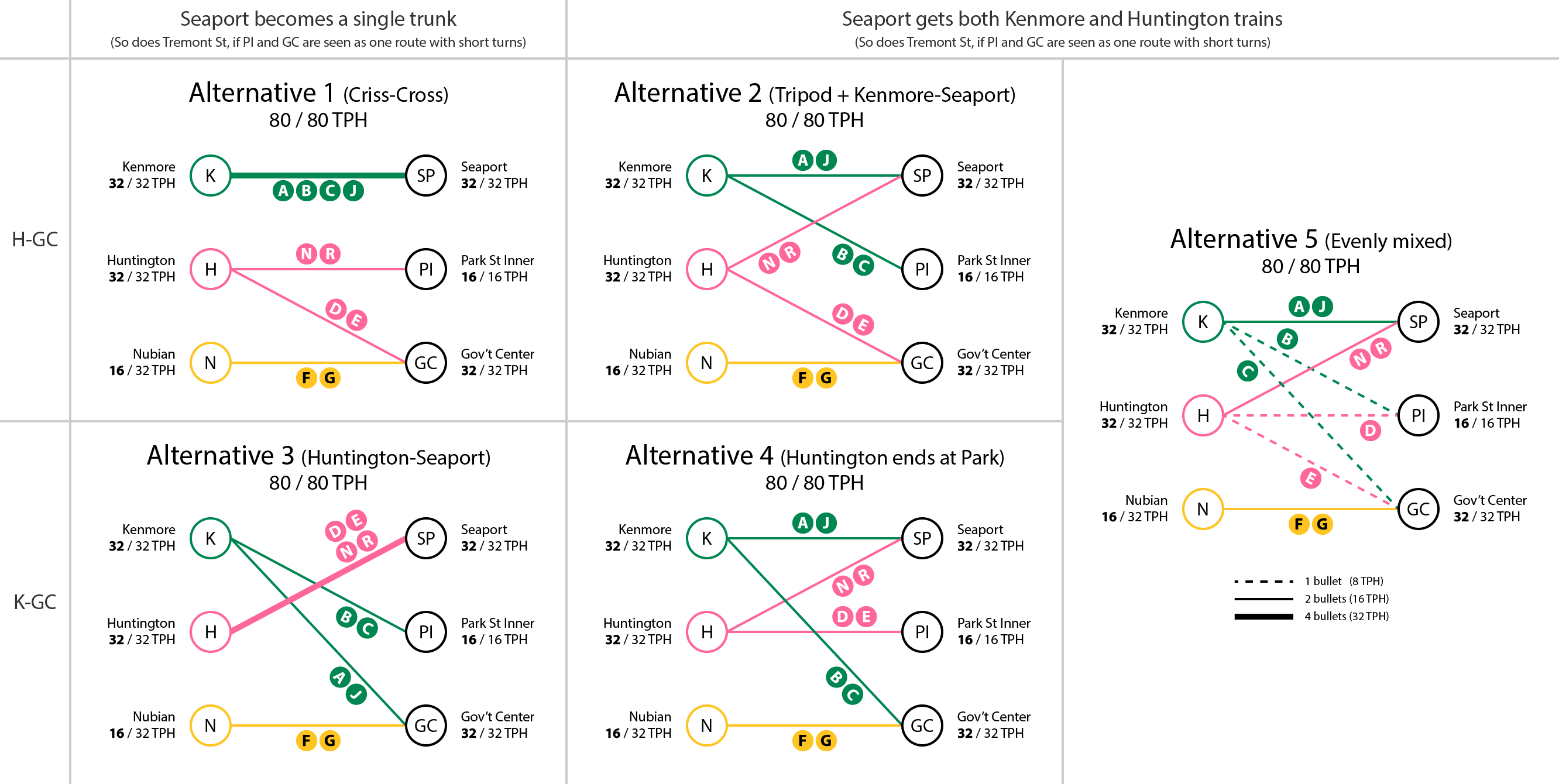

Since @Riverside made this post about the "Criss-Cross" GLR model almost a month ago, as opposed to the more traditional "Tripod" model, I had been doing some internal evaluations of the two, in an attempt to figure out which one is better. In this process, as hinted at in this comment of mine, I realized that we need a cleaner framework to reason about capacity.
So I've designed such a theoretical framework, which abstract away the engineering details (tracks, flying junctions, etc) and several operational details (e.g. outlying branches).
For the first time in almost a year, I actually managed to write a post on my own blog about it:
Routing the Green Line Reconfiguration (Part 1): A Theoretical Framework of Capacity and Service Patterns
TL;DR:
  • The Green Line Reconfiguration (GLR) system likely has a theoretical maximum capacity of 80 TPH, up from today’s 32; but hitting this maximum is non-trivial.
  • Most prior GLR proposals, namely the “Tripod” and the (naive) “Criss-Cross” models, only hit 64 TPH instead.
  • Adding short turns terminating at Park to Criss-Cross gets you 80 TPH. It comes at the drawback of interlining — but as it turns out, interlining is inevitable for maximum capacity.
  • There are (at least) 5 different service patterns that hit 80 TPH, not just limited to short-turning Criss-Cross.
  • Evaluating them will be left for the future — but share your thoughts now!
Feel free to discuss and evaluate these alternatives or the framework itself! I plan to do my own evaluations at some point, but those will definitely be influenced by everyone else's thoughts.
As another reminder, I have a list of potential future blog posts in the last section of the article. Let me know which ones you are most interested in or want me to write!

Alternative Criss Cross:
32 TPH between Kenmore and Seaport, 16 TPH from Nubian to Park St Inner, and 32 TPH from Huntington to Government Center.
See, that's exactly what I thought when we discussed this.
However, at this point I'm not sure if it's worth it. One of the four items below need to be done:
  1. Flip the flyover junction tracks south of Boylston, so that outer tracks at Boylston connect to Boylston St, and inner tracks connect to Bay Village
  2. Flip the quad tracks between Boylston and Park with grade separation, so that Bay Village trains use Boylston outer and Park St inner
    • Requires rebuilding this section of the subway under Tremont St and part of Boston Common
    • Probably more feasible than #1, but still expensive and disruptive to existing operations
  3. Flip the loop north of Park St, so that Park St outer tracks loop around, while Park St inner tracks continue to GC (ala Kenmore loop)
    • Requires rebuilding the entire section of the loop north of Park St, to grade separate the new outer loop and the new inner thru-tracks
    • Seems infeasible -- space north of Park St is very tight, both laterally (Tremont St narrows) and vertically (constrained by street above and Red Line below)
  4. Build an entirely new ROW for Nubian to hook into Boylston Inner from the west
    • Along one of the several SL Phase III alignments that Riverside and you mentioned; the Charles St-Park Plaza alternative seems the most promising
I'll first make the executive decision to remove #1 and #3 from consideration: They achieve the same purpose as #2, but with worse engineering.
Now consider: What new infrastructure is needed?
Where Huntington trains feed into#2 (flip Boylston-Park)#4 (Nubian-Charles St)
Huntington-Arlington
(assuming Huntington trains use existing Arlington station, and possibly Copley station)
  • Boylston-Park flyover
  • A new Hynes-Seaport trunk that's grade-separated from existing Arlington station
    • EITHER: Pike Hugger, as Riverside proposed
    • OR: Quad-track Copley-Arlington, then use Kneeland/Essex/Marginal to SS
  • Charles St subway, from Boylston to BV
Huntington-Bay Village (then Boylston Outer)
  • Pike Hugger West (for Huntington)
  • A new Hynes-Seaport trunk that's grade-separated from Huntington's Pike Hugger West
    • EITHER: Diverted subway east of Arlington, using Kneeland/Essex/Marginal to SS
    • OR: Pike Hugger, with quad-tracked Pike Hugger West
      • This requires closing Arlington station altogether
  • A new Hynes-Seaport trunk that's grade-separated from BOTH Huntington's Pike Hugger West AND Boylston-Charles-BV subway
    • EITHER: Diverted subway east of Arlington, using Kneeland/Essex to SS
      • East of Arlington, you NEED to dive below Boylston-Charles immediately
Note: "Pike Hugger West/East" = Pike/Marginal subway west/east of Bay Village, respectively. "Pike Hugger" means both the western and eastern segments are needed.
I won't attempt to evaluate them in great detail right now, but a few thoughts:
  • #2 (flip Boylston-Park), if practical enough, seems to strictly dominate #4 (Nubian-Charles)
    • Covers a much shorter distance, and has non-negative impacts on other infrastructure compared to $4
    • The wildcard is #2's own cost and practicality, especially with ongoing revenue service during construction
  • The top left quadrant (#2 & H-A) is essentially Riverside's original Criss-Cross proposal, + Boylston-Park flip
  • The bottom left quadrant (#2 & H-BV) is probably what you had been hinting at for a while
Regardless of the alternative, at least one new western segment & at least one new eastern segment have to be built in ALL scenarios:
  • West: Arlington + Pike Hugger West / Quad-tracked Arlington / Quad-tracked Pike Hugger West
  • East: Pike Hugger East / Kneeland / Essex
This applies to even the 5 original alternatives, before we even think about Nubian-Park Inner.
Also, if we fix #2 as given, we're essentially decomposing the problem into two: (a) How to enable Kenmore-Seaport; (b) How to do the Boylston-Park flip. This particular discussion thus only affects (b), so the real question is -- is eliminating the N-merge worth the Boylston-Park flip?
Given this decomposability, I don't think it's pertinent to us figuring anything out at this stage. It's really more of an operational question (impacts of the N-merge), and can be done as piecemeal.

This should actually be possible without leaving Boylston St, barely. You've got around 550ft to descend 30 feet, which gives you a grade of around 5.5%. This avoids any problems from Arlington station. It's not really avoidable for the same reasons that the Charles St Subway itself is unavoidable.
So with that in mind, let's go back to alternatives 1-5:
Alternative 1: Needs the Charles St subway. Whether you want to use the Park St loop for Hyde Sq trains or Nubian trains is a separate question. Whatever trains use the Park St loop go via Charles St. I'm going to retroactively put my "Nubian to Park St Inner" proposal under this Alt since the infrastructure is basically the same.
Alternative 2: Requires a Huntington-Seaport connection while maintaining the Boylston St Subway as-is. There are plenty of options for how to do this, but none of them seem simpler or easier than a direct route via Essex St, which doesn't work with this service pattern. "Long Pike Hugger" with quad-track is likely necessary for this Alt.
Alternative 3: Could be done by extending the Pike Hugger Subway to Hynes, and using the existing curve at Copley for Huntington trains. However that would also mean cutting off the GLX and downtown generally from Huntington, which seems unwise.
Alternative 4: Either requires the continued use of the flat junction at Copley at 48 TPH (non-starter), or the full Pike Hugger Subway with an extra flying junction, and the longer Pike-Seaport connection. The latter isn't impossible, but it's substantially more interlined, and likely more costly than Alternative 1. For that to be justifiable, Huntington-Seaport service needs to be quite popular, as LMA service is still on the table with the current D branch as part of Alt. 1.
Alternative 5: I have no idea how you would even do a service pattern like this but extensive use of the flat junction at Copley seems necesssary.
I'd go ahead and strike out options 3 and 5. Cutting off Huntington from Downtown/North is not a good idea, and I don't see a way for Alternative 5 to be physically possible. That leaves 1, 2, and 4. All of these are probably possible, but alternative 1 seems to be by far the simplest. Yes Seaport gets fewer 1SRs. I think given the added complexity of the other alternatives, this is an acceptable comrpomise.
True. I did figure that having to dig deep before Charles would still not be a deal-breaker overall, but good to have some concrete numbers!
As for the discussion of the 5 alternatives, with the caveat of replacing "need Charles St subway" with "need separation point X", here are some additional comments:
My opinion on Huntington-Seaport is quite the contrary: I think the Full Pike Hugger is the best alternative for Huntington-Seaport alone.
  • The distance disadvantage -- the most significant drawback of Full Pike Hugger -- is by far the least notable for Huntington-Seaport than for any other service pattern. I measure 1.33 mi from Huntington/Exeter to Essex/Surface via the Pike. That becomes a "whooping" 1.29 mi via Exeter-Boylston-Essex, and 1.23 mi via Stuart-Kneeland-Surface. If you say Full Pike Hugger is longer, I'm not feeling it.
  • Even accounting for uncertainties near South Station, the Full Pike Hugger is still easier to build (likely by a notable margin), especially when distance isn't a huge concern. In contrast, no matter how you slice it, Essex is by far the hardest to build among the "eastern half" options: no other alignment runs into building mitigation risks even after accounting for forced TBM.
More broadly speaking, I think we should avoid "working backwards" to cross out theoretical alternatives because of being too married to particular alignments. Hope this doesn't come as an offense, but the overall impression I got from your comment was that you started by assuming Essex is the default option for the eastern half. Everything else builds upon this assumption, and other eastern alignments only come into play when absolutely necessary. Frankly, a key reason why I even wrote this post is to minimize the influence of engineering details from high-level decisions.
I believe there are very plausible builds for Alternatives 3/4/5 that allow Huntington to connect to Park/GC, nor do I think any of them requires flat junctions that absolutely cannot be replaced with flying junctions. Hopefully this will be made clearer once I get to elaborate in future posts.
