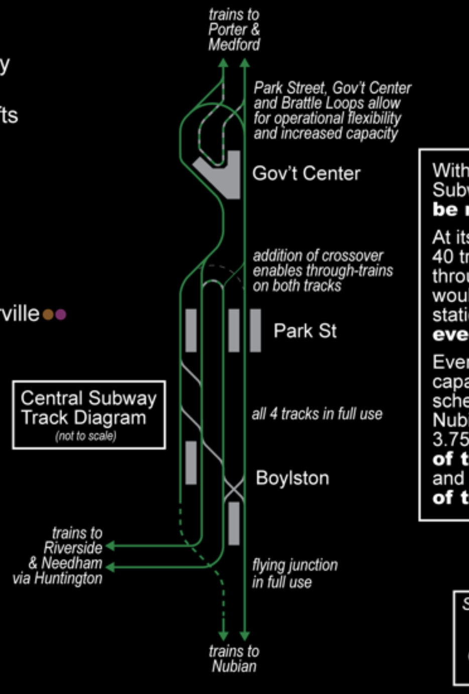

I highly, highly doubt it. Copley is right under the Public Library, Trinity Church, and the Old South Church. Expanding it in any way is very likely to be politically, financially, and/or technically infeasible. The only way to do quad-track would be to close the station, and I don't think it really needs to be stated why that's not a great idea. As long as Copley can't be quad-tracked, this proposal is a non-starter. This seems to have been a generally accepted truth for basically the subway's entire existence as I don't think it has ever been officially proposed, unlike Park-Gov't Center.But kind of a nitpick: If a quad-tracked Copley-Arlington subway turns out possible, I think that may avoid the need for Pike Hugger West altogether. Not saying this is more desirable -- but I have indeed been placing a lot of thoughts on a quad-track Boylston subway lately.

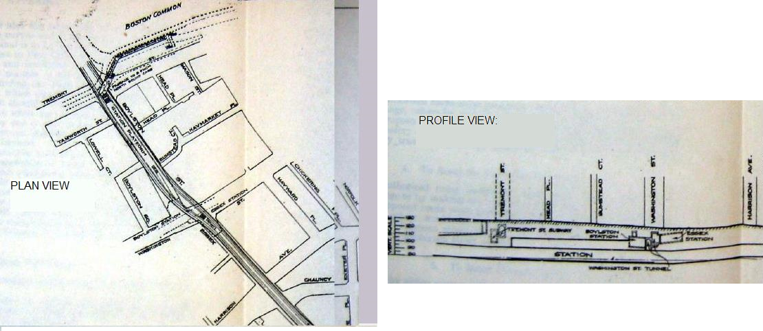

I'm focused on the distance that needs to be tunneled under narrow streets. In the case of the Essex St alignment, that's the whole distance. For Pike Hugger, it's the distance from the Pike to the Transitway hook on Essex St. Essex works out to about 3800ft, Pike Hugger is around 3400 ft if you tunnel under Hudson St, or 3700ft if you tunnel under Harrison St, plus the Pike-hugging section. Even if we assume the pike-hugging section is three times as easy to build, it's still 1400ft from Tremont St, so total under-street distance would need to be ≤3300ft. You would definitely see some saving from not including stations, but also, now you're not including stations. There's now no 2SR or better from Seaport to Kenmore and Huntington (and beyond) without either a quad-track Pike Hugger or a new bi-level station where the Huntington Ave Subway meets the Pike. The workarounds really start to pile up when you take an indirect route.
- The distance disadvantage -- the most significant drawback of Full Pike Hugger -- is by far the least notable for Huntington-Seaport than for any other service pattern. I measure 1.33 mi from Huntington/Exeter to Essex/Surface via the Pike. That becomes a "whooping" 1.29 mi via Exeter-Boylston-Essex, and 1.23 mi via Stuart-Kneeland-Surface. If you say Full Pike Hugger is longer, I'm not feeling it.
I'm not convinced this is an avoidable problem. For one, you still need to end on Essex St somehow to hook into the transitway, so any solution, as far as I can tell, needs to be under Essex at least as far as Lincoln St for the steep climb after passing under the sewer. And if you're not starting at the Post Office Sq incline, you need to get there somehow. So you either need to navigate the deep foundations and narrow streets of Downtown, or underpin Big Dig tunnels, or maybe both. I think this moves the problem, rather than solving it.In contrast, no matter how you slice it, Essex is by far the hardest to build among the "eastern half" options: no other alignment runs into building mitigation risks even after accounting for forced TBM.
My interpretation of your alternatives was to compare them with the technical details and possibilities that exist outside of theory. For right now, that means that (in my opinion) since the Essex St subway is (likely to be) the most cost-effective connection between any part of GLRC and the Seaport Transitway, any alternative that doesn't make use of that better bring something else to the table. I think this has long been understood to be the hardest part of GLRC, for many of the same reasons that SL Phase III ran into. You have to navigate a complex underground landscape of subway, sewers, foundations, and highways. There are many ways to do that, but without evidence to the contrary, I'm inclined to choose the one that is generally shorter, has fewer incredinly sharp turns, has an existing portal location available, and has had a significant amount of its underground complexity already mapped.More broadly speaking, I think we should avoid "working backwards" to cross out theoretical alternatives because of being too married to particular alignments. Hope this doesn't come as an offense, but the overall impression I got from your comment was that you started by assuming Essex is the default option for the eastern half. Everything else builds upon this assumption, and other eastern alignments only come into play when absolutely necessary. Frankly, a key reason why I even wrote this post is to minimize the influence of engineering details from high-level decisions.
Also, I really don't think trying to avoid the Charles St subway is the way to go here. In terms of engineering, that's probably the easiest part of any of this, a short, mostly flat cut and cover tunnel under a (relatively) wide street is probably not where the cost would really pile on.

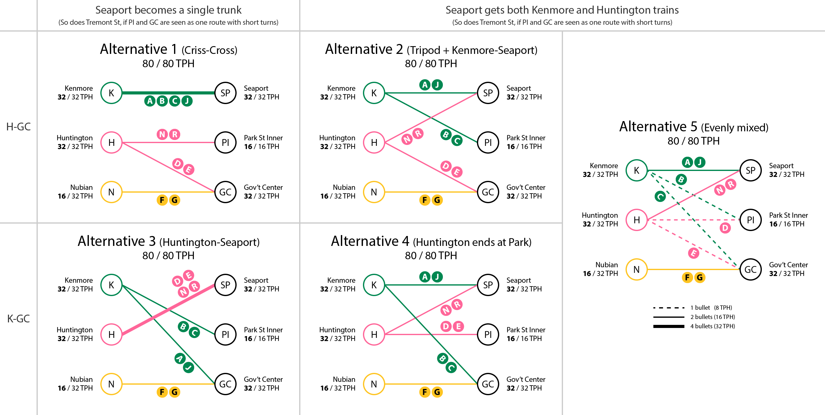

LMA is absolutely the bigger destination. Which is why it's great that it can be reached both from Huntington, or from Kenmore. The real differentiator is the section between MFA and Prudential, that alone needs to justify the added cost of connecting Seaport service to Huntington compared to Kenmore.On most days, LMA seems like a bigger destination than Kenmore is.
Kenmore alone doesn't justify 32 TPH. A trunk that feeds into Brookline, Allston, Brighton, LMA, and Harvard does.So if Kenmore can justify 32 TPH, why can't Huntington?
If you think there are I'd be more than happy to see them. I just can't think of any way to do 3/5 without using the junction at Copley, which for the reasons I outlined earlier, I really do not think can be replaced with a flying junction at any reasonable cost. 4 is definitely possible, I just don't really see it being worth it between the full Pike Hugger subway and the required flying junction to merge Kenmore/Huntington trains into a single trunk.I believe there are very plausible builds for Alternatives 3/4/5 that allow Huntington to connect to Park/GC, nor do I think any of them requires flat junctions that absolutely cannot be replaced with flying junctions. Hopefully this will be made clearer once I get to elaborate in future posts.
