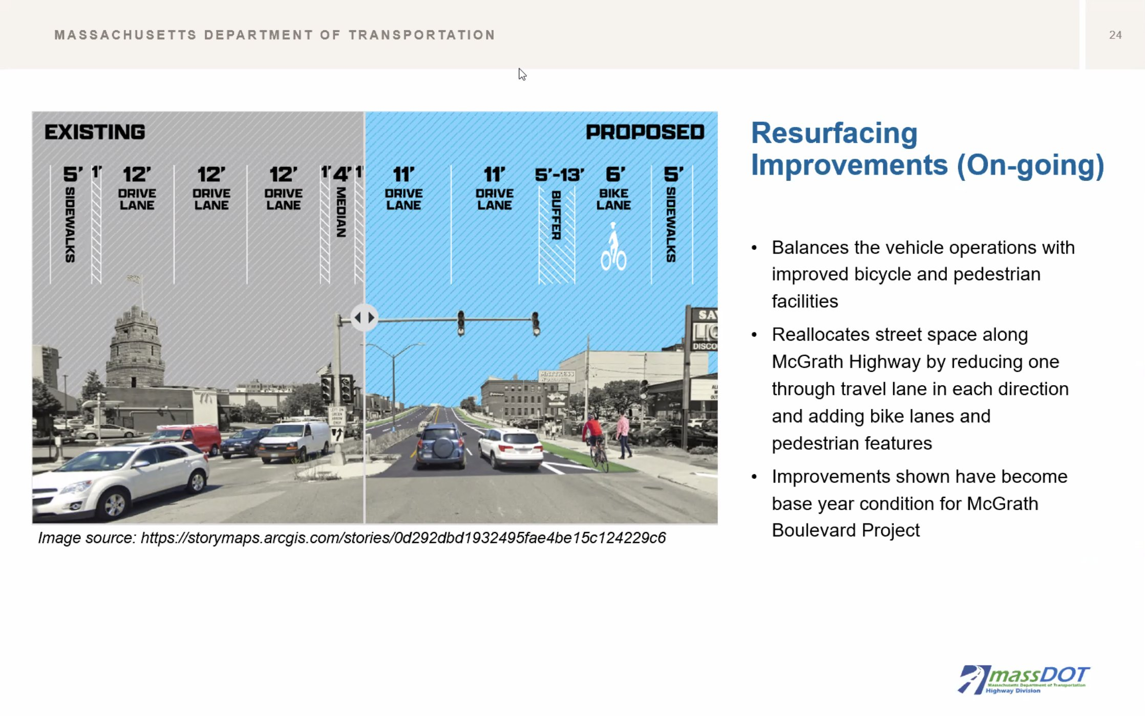

I assume you're referring to the resurfacing / road diet / Squire Bridge work? As I understand it, that work is basically preservation and "early action," intended to last only as long as it takes to get to the grounding. There's a whole series of interlocking projects here: The Route 28 / Route 38 (McGrath/Mystic/93) Intersection, the I93 Viaduct Preservation, McGrath Resurfacing. McGrath resurfacing is the one that's currently under construction and reducing the number of lanes from 6 to 4, and adding bike lanes, and why the Union Branch will be shut down soon for substructure replacement to Squires Bridge. That bridge, or something very similar, specifically is likely to remain even post grounding thanks to the need to cross the Fitchburg Line/ Union Sq branch and Grand Junction.
Keep in mind that the 2013 study on Grounding was actually proposing ~6 lanes through the area, and reducing it on the current McGrath to 4 means they are likely to reduce if not eliminate the demand for the grounded McGrath to carry 6 lanes as well. In fact, despite the budget for FFY27 increasing by 15 million, the overall project is expected to cost less - likely as a result of reduced scope, and it continues to feature in the TIP. In fact, that $15M is specifically included with a note to accelerate the project timeline. Ultimately though, its a 4 year project (presumably including design, permitting and bidding) starting in FFY27 probably CY28, I would expect what they're building now to be used at least through the end of the decade.

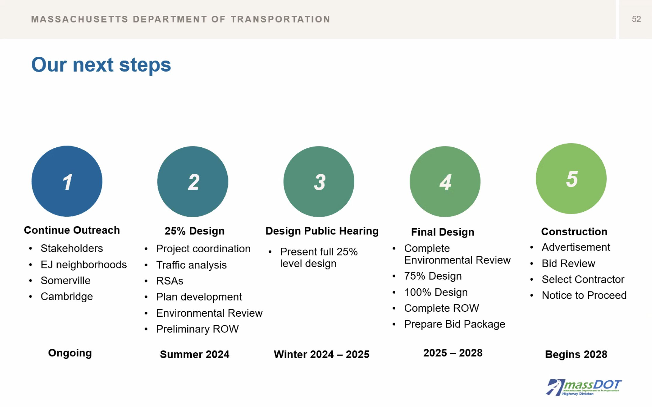

The meeting flyer says 25% design by the end of the year.

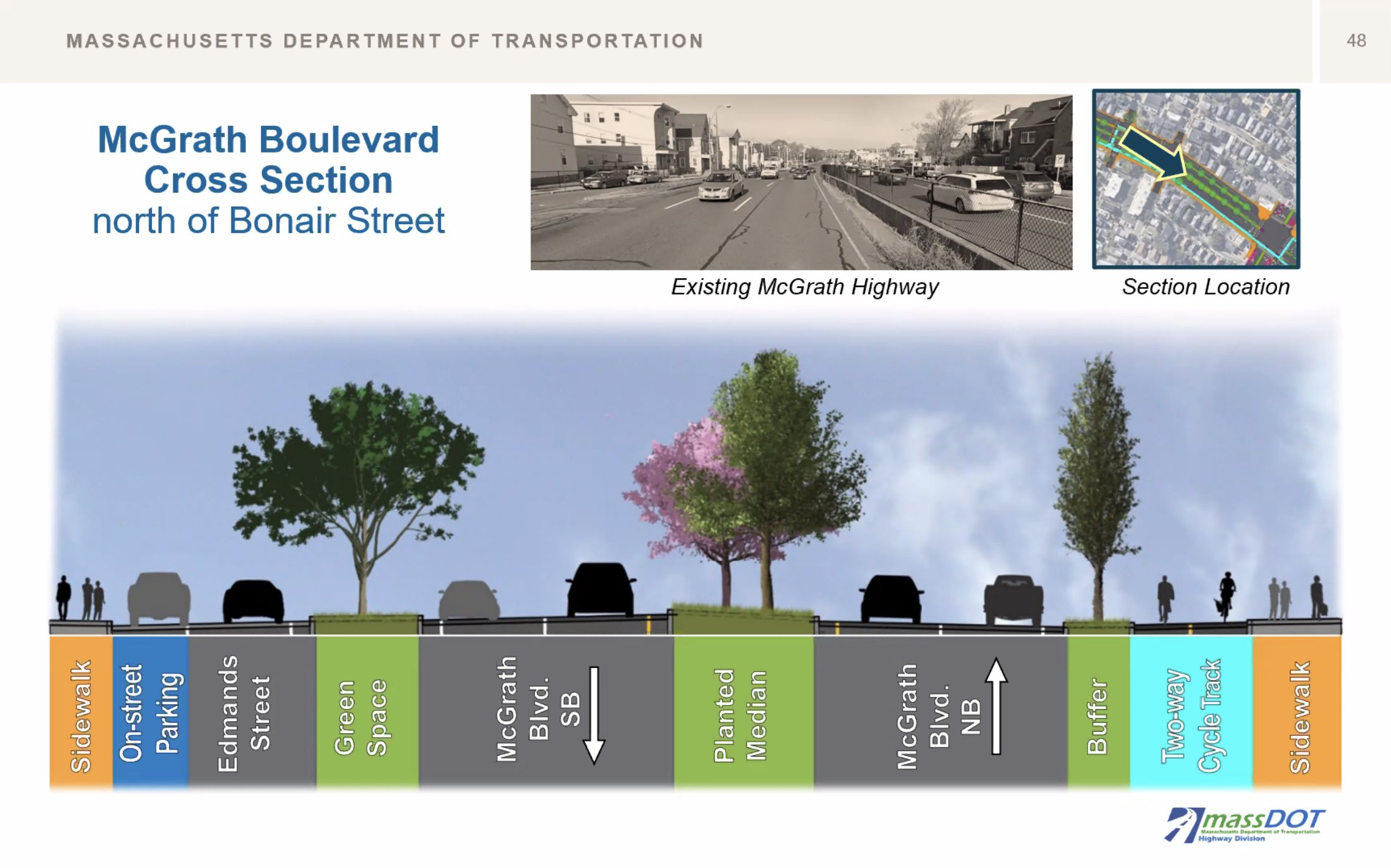

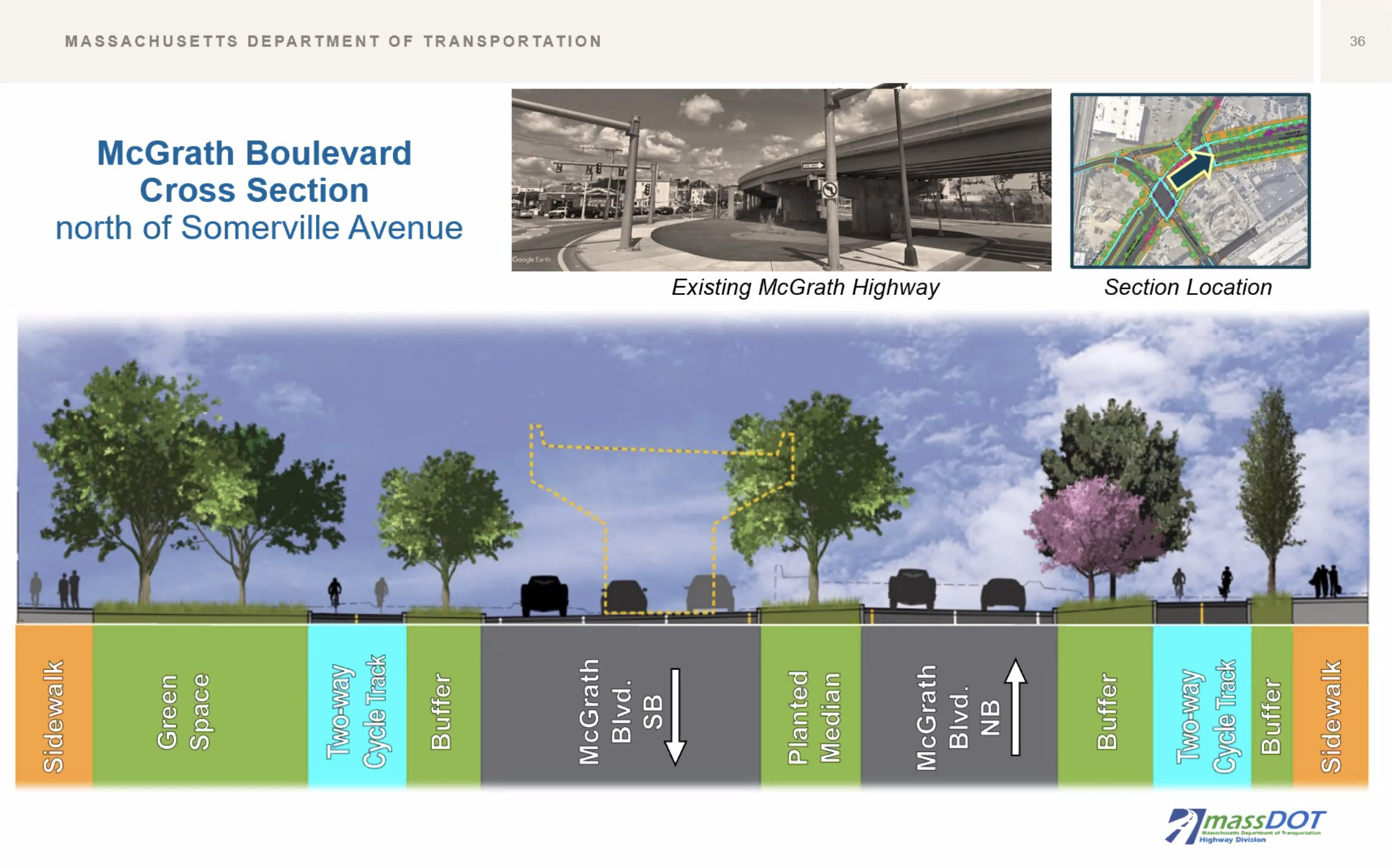

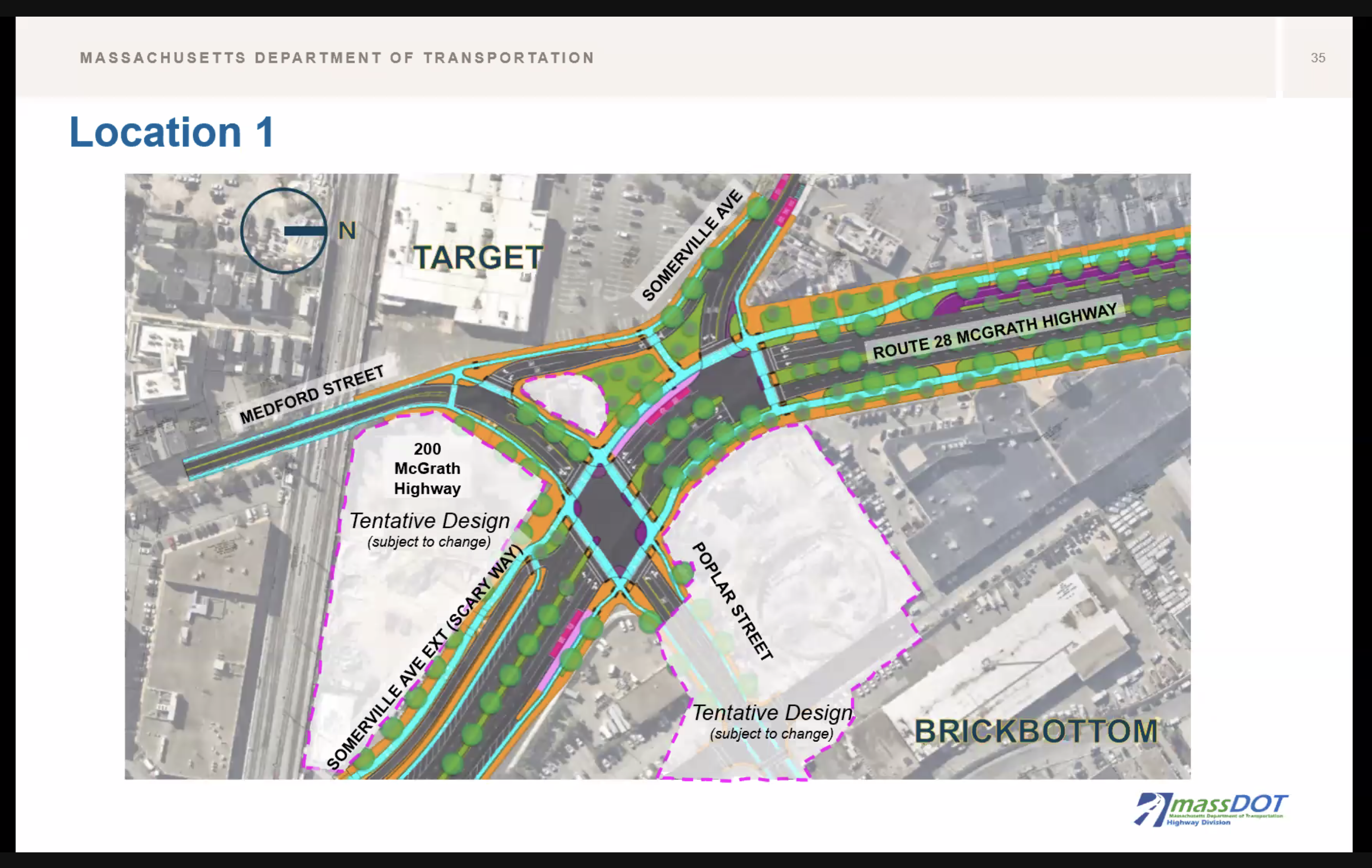

I was able to attend the meeting. A big question that arose for me was: why fill the existing right-of-way with more road infrastructure (medians, verges, parallel frontage/local access roads, and long driveway access cuts) just cause there's the space to?
A lot of what was shown seems to aim to keep the existing width of the corridor, doing little to stitch back together the urban fabric it tore through upon construction. Why not cede some of the remaining space after the road diet + bike lanes + bus infra. to development that's better in scale with the scale of the McGrath corridor? Upzone abutters and yield some of the corridor to create space for development. Development along the corridor (of a denser variety) would help shield the surrounding quiet neighborhoods from traffic noise and direct exhaust, while better framing the wide Blvd., and would help stich together the surrounding neighborhoods.
The presenters highlighted the new 'green space' that was being created, but... it's still going to be alongside or in the middle of regular McGrath traffic volume and speeds...
Here are the main 'design' slides I captured from the meeting:

Funny how you mentioned bus infrastructure, because it looks like bus lanes are entirely missing from this design. Especially when the T plans to introduce a BRT route SL6 that runs via this section of McGrath, citing the redesign process as part of the consideration, and said "almost the entirety of this alternative would operate on dedicated bus lanes".
