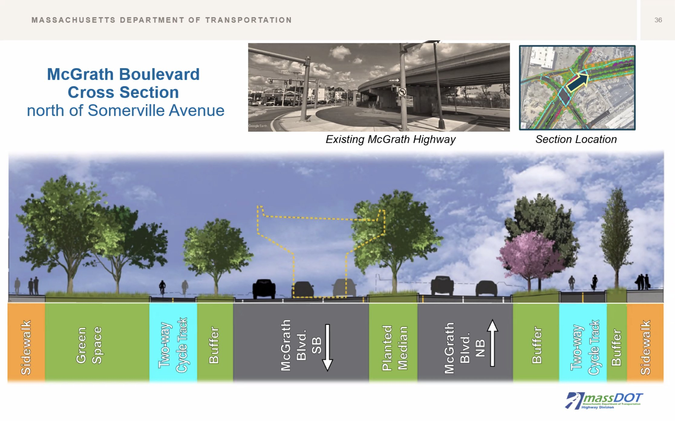

Even as someone who bikes in Somerville a lot... does anyone know what warrants two two-way cycletracks, rather than one two-way or two one-way tracks?
I would rather one of those tracks and some green space be traded in for median bus lanes.

Two travel lanes is an improvement, but no bus lanes and I'm still seeing monster 6-lane intersections :mad:
Absolutely essential to include bus lanes (in both directions), and also bus-only left turns onto Washington St from McGrath Hwy for busses as mentioned above.

As others are noting, the ROW is still quite wide. Even with the dramatic improvement of demolishing the elevated highway, people are likely to have a strong preference not to cross the street if they don't have to. Also, with the wide planted buffers shown in this cross-section, the bike lanes are likely to feel a bit like shared use paths. Those are typically bi-directional, and I bet people would ride both directions in them regardless of whether it's signed one-way or two-way.
That makes sense. If they're proper shared-use paths, though, then are the sidewalks necessary?
I didn't mean to imply that this design had shared use paths, only that the wide & green-buffered bike lanes might "feel" sort of like a path. Sorry if there was any confusion.
Shared use paths carry distinct accessibility requirements that do not apply to bike lanes (one-way or two-way). The proposed design is very much for two-way bike lanes and would probably require significant modification meet accessibility regs for a path. In general, in busy urban areas, separate facilities for bikes and pedestrians are preferable. IMO, two-way bike lanes and sidewalks on both sides are desirable for most ROWs, including this one.
Makes sense @Codman89 . You weren't implying that they were shared-use paths in this design. My thinking was that if they *could* be widened into shared-use paths, then eliminating the sidewalks would lead to a net savings in width, thus allowing for bus lanes.

I was able to attend the meeting. A big question that arose for me was: why fill the existing right-of-way with more road infrastructure (medians, verges, parallel frontage/local access roads, and long driveway access cuts) just cause there's the space to?
A lot of what was shown seems to aim to keep the existing width of the corridor, doing little to stitch back together the urban fabric it tore through upon construction. Why not cede some of the remaining space after the road diet + bike lanes + bus infra. to development that's better in scale with the scale of the McGrath corridor? Upzone abutters and yield some of the corridor to create space for development. Development along the corridor (of a denser variety) would help shield the surrounding quiet neighborhoods from traffic noise and direct exhaust, while better framing the wide Blvd., and would help stich together the surrounding neighborhoods.
The presenters highlighted the new 'green space' that was being created, but... it's still going to be alongside or in the middle of regular McGrath traffic volume and speeds...

This project looks alright to me, but the other thing you seem to never see is a legit greenway. Having three buffers that are wide enough for single trees is a recipe for salted, dead trees and doesnt do anywhere near as much as if they had two buffers, or even one, wide enough for multiple trees deep. I dont know why we seem to always have fixations with the image of greenspace, rather than greenspaces that actually are real greenspaces. Having a linear forest and putting all the road stuff on one side would be far more audacious, better from an ecological standpoint, and might actually get some use beyond just looking at and passing through.
