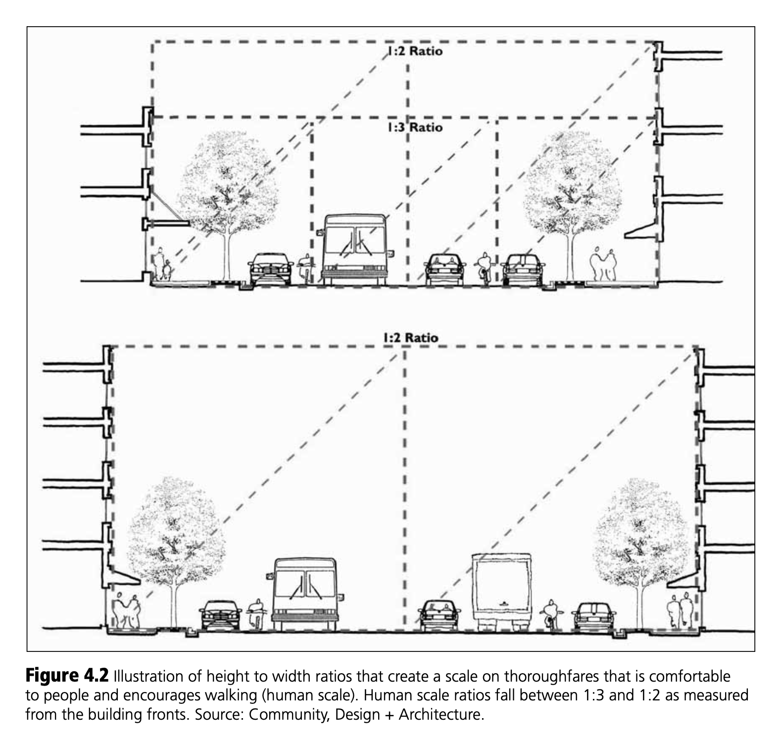

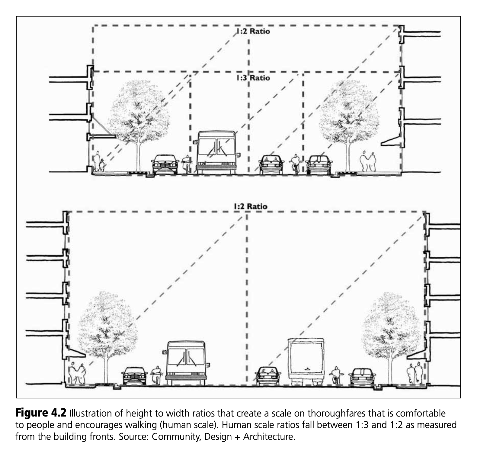

I'm wondering if including the diagram threw ppl off. I included it to spark discussion that if McGrath is 180ft wide, the recommended building heights for adjacent buildings to feel 'comfortable/human scale' would be 2:1 - 90ft or 3:1 - 60ft tall (much higher than the heights along it currently). Was not included to indicate any actual configuration suggestion - just urban scale/design principles.
I'm not advocating for the elimination of open space... I think if the state is going to stick with the wide corridor, the plan is relatively well balanced. I just think the surrounding parcels should be up-zoned to meet the scale of the right-of-way and the urban context.
Thanks for the clarification. I thought you were proposing to narrow the corridor to make it more "urban".

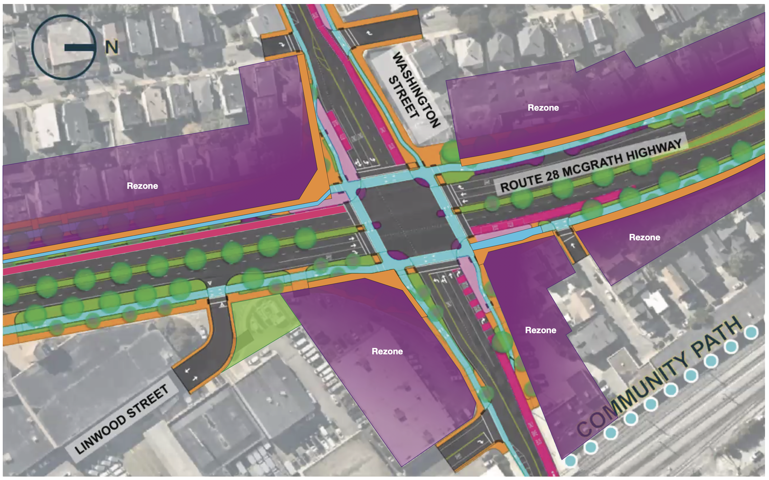

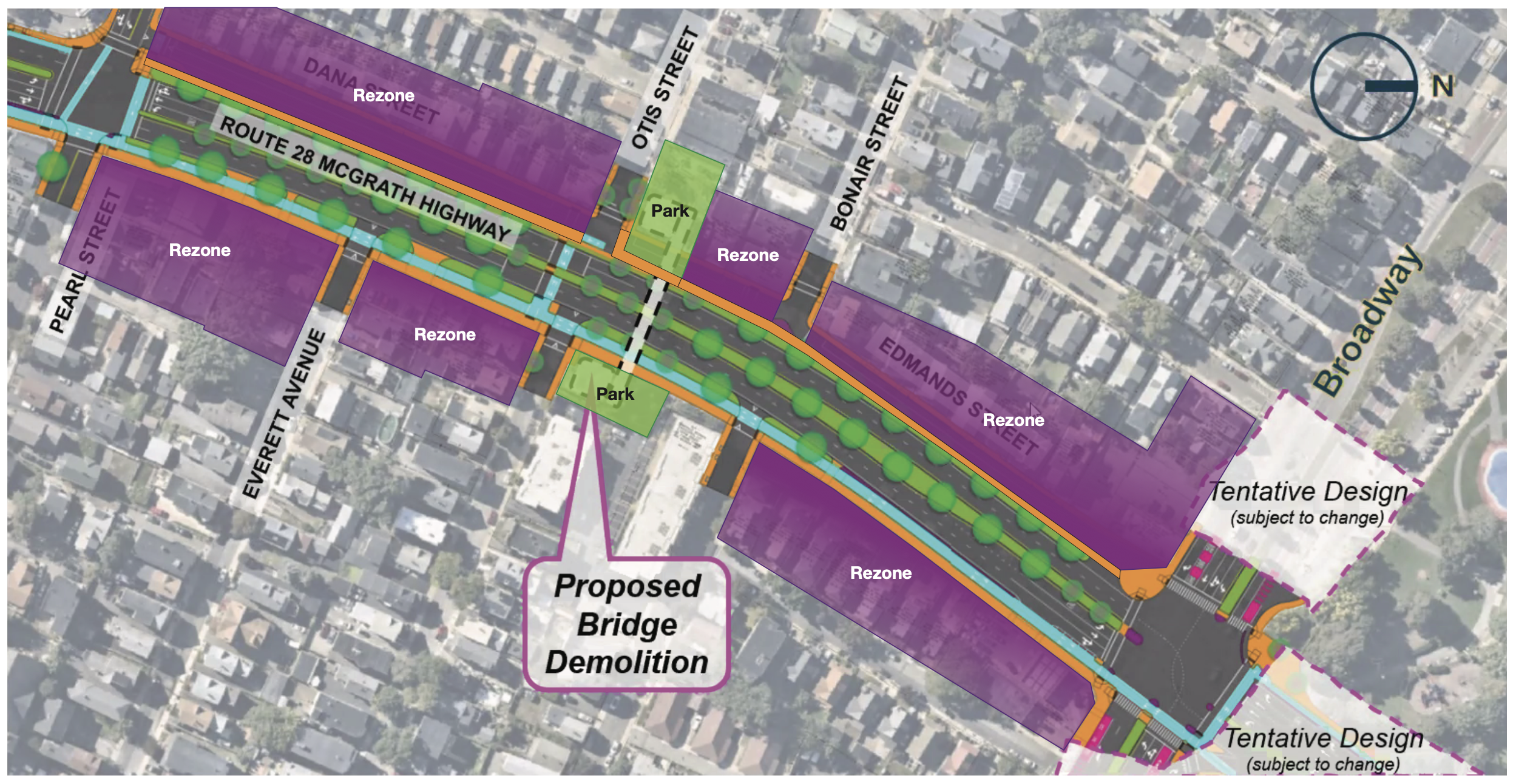

Made a quick mockup of what I previously suggested - returning some of the width of McGrath back to Somerville to be rezoned to better stitch together the neighborhoods, improve ped experience, and reduce the excess right-of-way width. (Open to suggestions, and very rough)
(would probably flip bus lane on W side of Washington - not depicted, E side of McGrath could be further narrowed)
As a variation on this, I'd actually leave the north side alone and just rezone the far more underdeveloped south side, shifting the lanes north. In fact, you don't even really need to do that, since there's such a wide buffer on the south side right now you'd mostly be narrowing the planted median. I understand the need for the carriage road and think it needs to stay.
Responding not to the diagram - that seems to be an awfully standard diagram now - rather - responding to the idea that @Longfellow said about essentially flipping the script -- building up to the highway or boulevard edge and then only accommodating pedestrians at points to get across the new McGrath and then keeping the main pedestrian and cyclist access on the "back" side of the building.

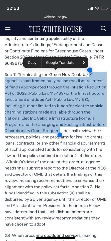

Is there anything the next administration can do to threaten this funding? Wondering how quickly it needs to be allocated.
It depends, but I suspect the answer is yes, if they wanted to.
I believe there is a way FHWA could put this in an MOU and actually lock it in. I'm not sure if they're doing that, but I hope they are.
Looks like this happened a bit faster than I expected…
