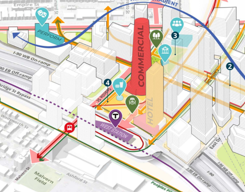

This is definitely a point of discussion. West Station will effectively be built as a deck over Worcester line, and I'm pretty sure current plans are to integrate development with it. As for the rest of the site, the only decking reference I could quickly find are here, as part of BPD's Beacon Park Yard plans. I believe this is just a proposal, without any commitments from the city or state in terms of decking. It would also leave large chunks of the rebuilt Pike without decking.
Here is a more recent presentation from the City's BPY Planning work with more decking over the highway. As Beans says, there is no commitments from the city, Harvard, or state for this much decking

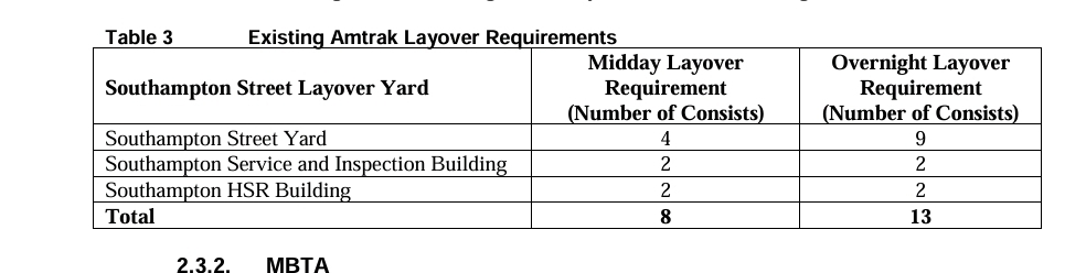

Worth noting at least a few things. 1, the T did already ED the cold storage site as part of the 2023 taking, so that's already done and dusted - the T just needs City of Boston owned roadway parcels. 2, my understanding is that the T can only layover in Southampton during the day? The 2013 analysis is definitively out of date, but I'm given to believe that they Amtrak occupies all tracks overnight, and that Front St yard tracks simply are too short @ 525ft for most MBTA Southside sets, let alone Amtrak purposes. If Amtrak needs more overnight layover, I'd like to know if any of the conceptual Widett design can accommodate Amtrak set lengths - I believe the NEC standard is up to 1050', vs the MBTA's 800ft.

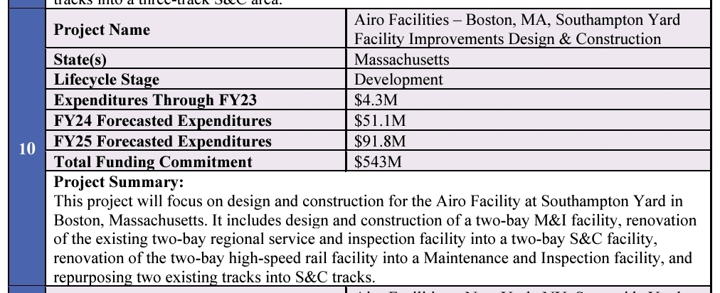

Lastly the current Amtrak investment plan might result in fairly significant Southampton reconfiguration - no plans have yet emerged, but it's out to bid. My understanding is that beyond reconfiguring the existing service buildings, 2 existing yard tracks will the site of the new M&I building, in addition to 2 tracks becoming daytime servicing tracks for Amtrak.View attachment 58857
So, a five car Amtrak West East consist would be able to fit in the Front Yard. Mm And I have not seen anything longer on the Southside than seven cars, which would be 690ft, and most are six or five.
