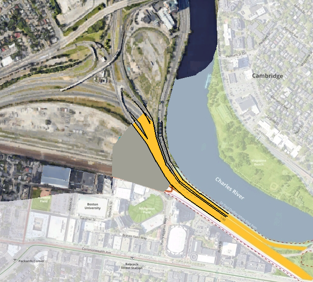

It's doable. I pasted the preferred Pike-on-the-surface Throat option onto Google Maps and got this. It looks like they'd be no spatial and connection problems with building just the Throat section first and tying it in with the existing Allston Pike interchange.
Yea this is basically what I was thinking just with a viaduct for grand junction since that gets cut off at grade.
