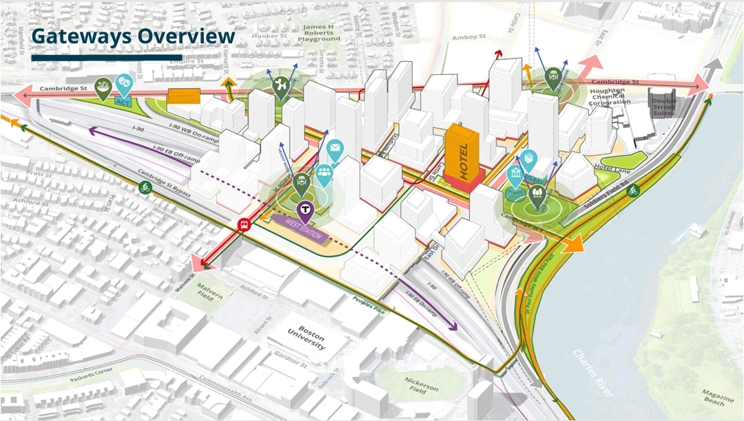

-2 tracks nets you...what, 25 feet in space. It's not much at all, and certainly not enough to build anything on. Frankly, if the station continues to be designed with giant busways that hardly any feasible routes are going to use...that's the space-waster that should be targeted if they're trying to pack the neighborhood together denser.
The main opposition to express tracks is definitely crying about any trains skipping the station. But...well, those 8-10 Amtrak RT's are not going to be stopping there in any universe and Worcester expresses probably shouldn't stop there most of the time if they care about making good end-to-end time. As said, this is not Back Bay Station in heft. So that's a lot of trains, making express tracks prudent enough if they're not taking up much space. The layout of the express tracks needs to change from the last set of renders, because the number of conflicts with the station track crossovers was stupid...but the general existence of them is smart.
Maybe with a better layout the bypass tracks wouldn't be so bad, but the current layout with bypass tracks and the layup yard is a big mess. If you want to run as many trains as possible through Allston (with some stopping at West Station and others not stopping there) you probably don't want all those switches and crossovers and inbound trains on outbound tracks and outbound trains on inbound tracks that MassDOT is currently proposing.
To paraphrase US Senator Everett Dirksen, "25 feet here, 25 feet there, pretty soon you are talking about real space" (though apparently that quote is misattributed).
And the bus parking lot above West Station is a big problem too.
