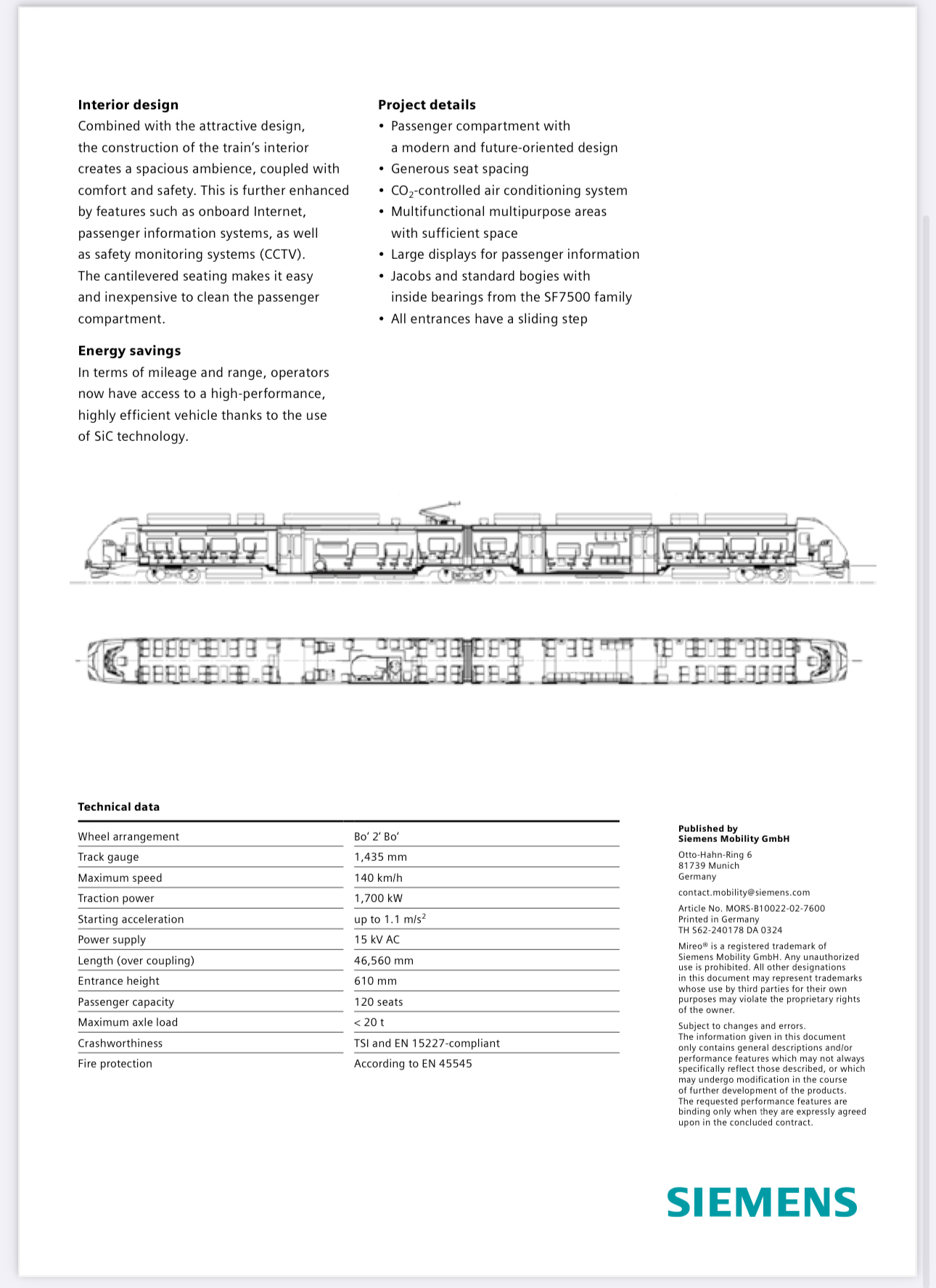

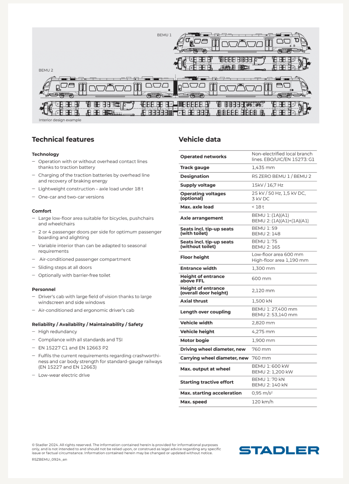

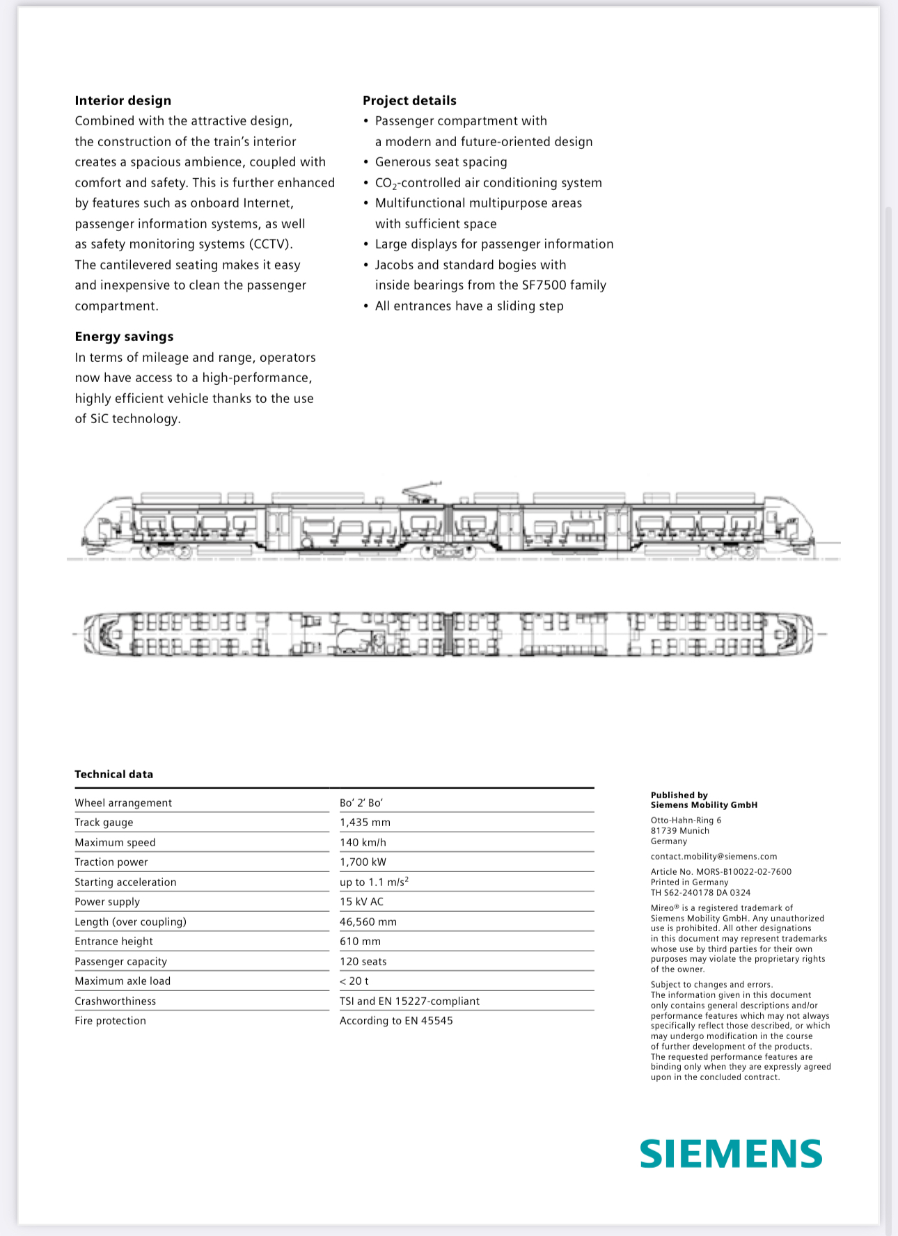

Unfortunately it's a toss-up which publicly available datasheets contain this info or not. Stadler's RS Zero which is basically a modern battery train equivalent of a Budd RDC lists a max starting accel. of 0.95 m/s^2 but it's unsure if the more powerful motors of the heavier FLIRT Akku maintain the same acceleration.
The Siemens Mireo Plus B lists "starting accel up to 1.1 m/s^2" with 380kW more power than the Akku which is a bit more ambiguous but it seems like the industry, albeit limited, standard for BEMUs is 0.9-1.1
Thanks for that!
And to just really clearly draw the conclusion out there: it looks like there are modern, commuter rail BEMUs that can accelerate roughly as good as straight-EMUs. The BEMUs have many other drawbacks, but acceleration probably isn't one of them.
Thanks for that!
1 m/s^2 is pretty standard for straight-EMUs. So it sounds like BEMUs are achieving that level of acceleration.

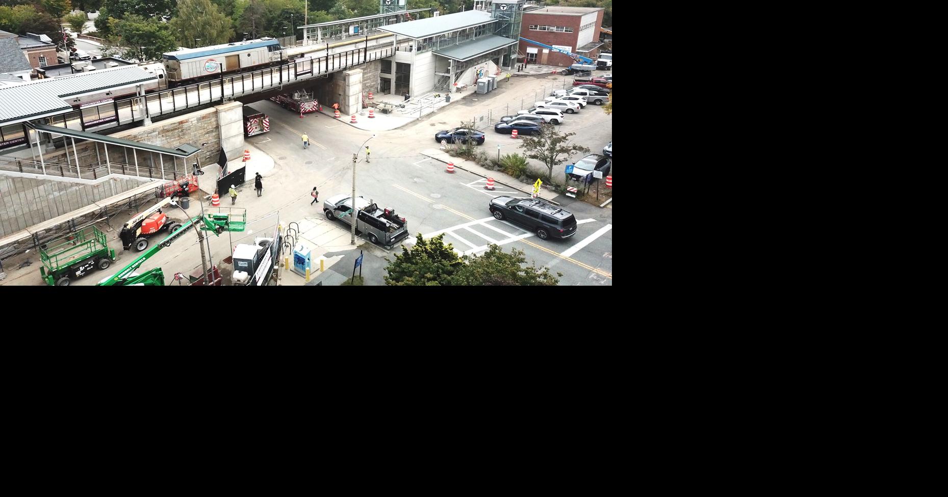

Town of Winchester refuses to give up 8 parking spots for the MBTA to run weekend shuttles during station work...
Prior noted how the MBTA doesn’t keep rider counts, so the board had no way of knowing how many people would be impacted if they chose not to grant the transit authority’s request.
Town Manager Beth Rudolph said the board had two options: approve the MBTA’s request or the bus would skip the Winchester Center Commuter Rail Station and only stop at Wedgemere. This is for November and December, as the MBTA finishes up work at the center station (with a potential full reopening scheduled for the end of the year).
Prior, in voting against the request, said local businesses are already dealing with a lack of parking. Not to mention, as pointed out by Select Board member Michael Bettencourt, the bus would only make infrequent stops thereby effectively taking those spaces out of commission even when not in use by the MBTA.
I'm willing to believe there are more than 8 riders a day on the commuter rail but what do I know

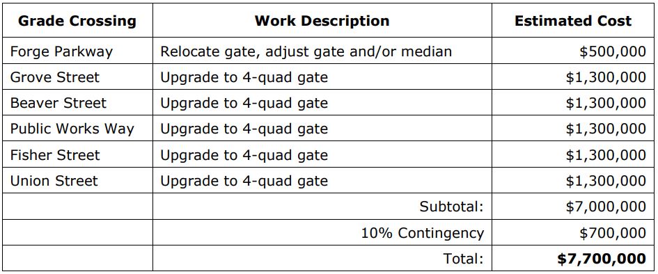

In June, the Franklin Line Quiet Zone study was released. The study examined a potential quiet zone in Franklin, encompassing all 6 crossings in town.
The proposed quiet zone would include the grade crossings of the MBTA Commuter Rail Franklin line with the following public roadways (with DOT Crossing Inventory Number):
  • Forge Parkway (921771W)
  • Grove Street (536865M)
  • Beaver Street (536863Y)
  • Public Works Way (536862S)
  • Fisher Street (536861K)
  • Union Street (536859J)
5 of the 6 crossings (Grove Street, Beaver Street, Public Works Way, Fisher Street, and Union Street) will be upgraded to four-quadrant crossings if the quiet zone is implemented. Forge Parkway does not need four-quadrant gates for the quiet zone, as it has a center-running median (which might need to be modified).
The improvements are estimated to cost $1.3 million per crossing (excluding Forge Parkway, which would be $500k) for a total of $7.7 million, according to the MBTA Engineering Division. The town of Franklin would provide funding for design and construction.
In order to provide the Town with an order of magnitude opinion of probable construction cost, we reached out to MBTA Engineering Division who provided an estimate of approximately $1.3 Million (2024 dollars) as an approximate average cost for design and construction to upgrade from a two-quad gate system to a four-quad gate system, install crossing envelope detection and upgrade the railroad signals. The MBTA noted that in some situations there could be some site-specific safety measures that may increase that cost. A 10% contingency has been carried below for that reason. The Town would be responsible for all costs associated with design and construction of any improvements required to implement the QZ.
I had been meaning to post that after I started poking around last month on it.
Seems like a reasonable estimate to upgrade the crossings? I wonder if Franklin will fund it - seems like short change for a big QoL improvement for the town.
