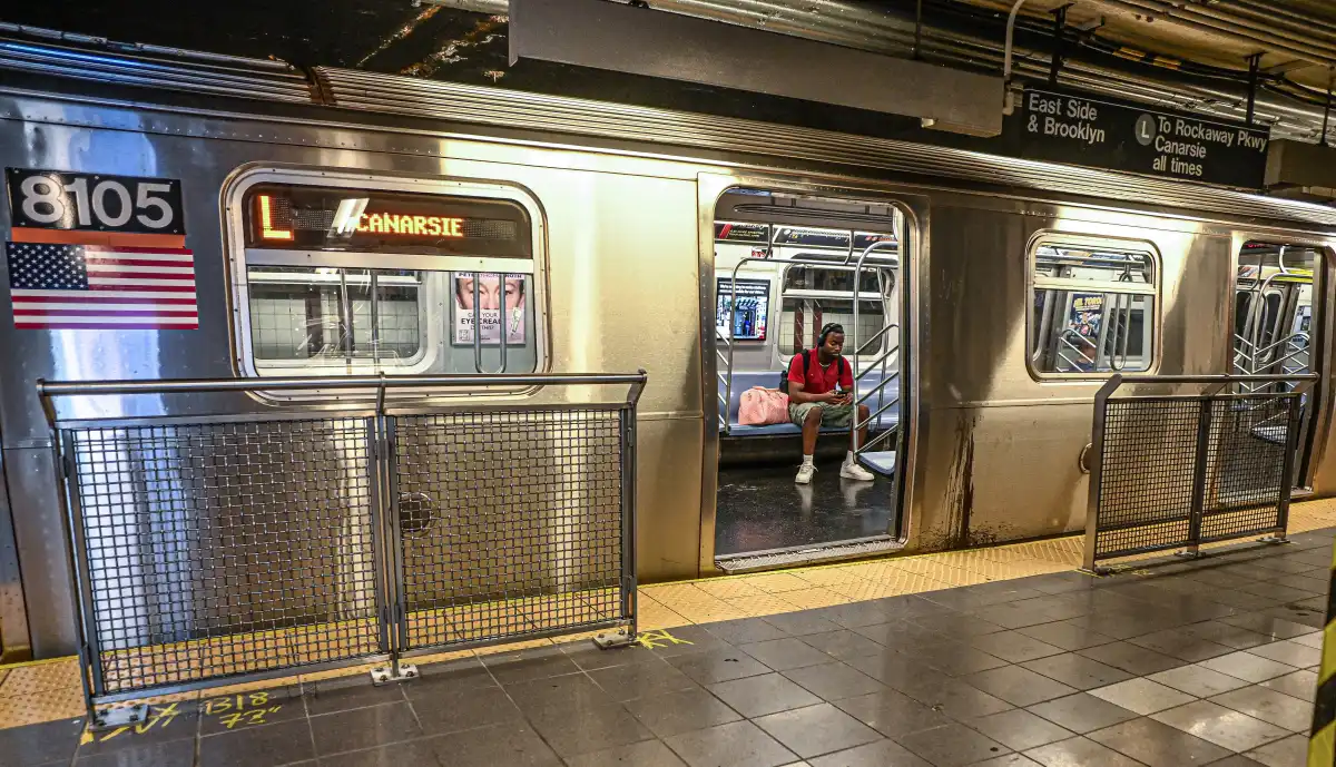

New York's fixed barriers have been quite successful, especially for cost obviously.

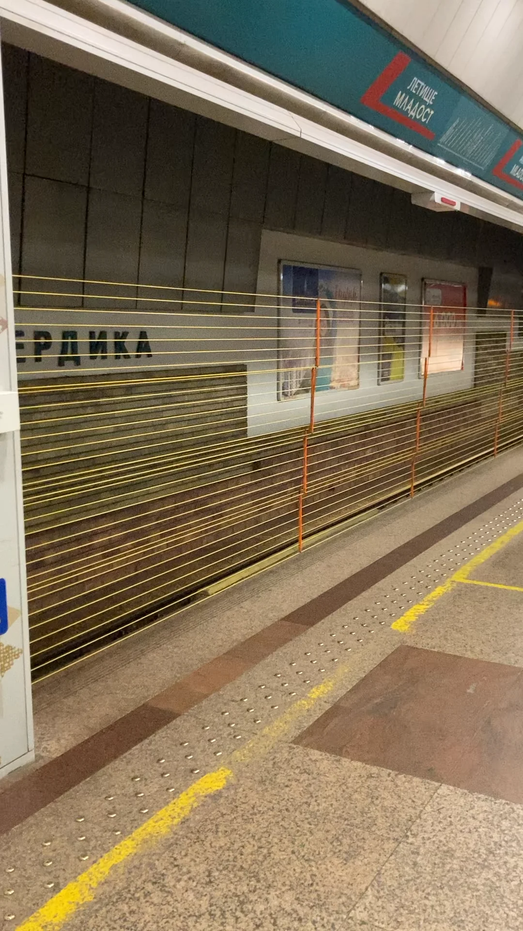

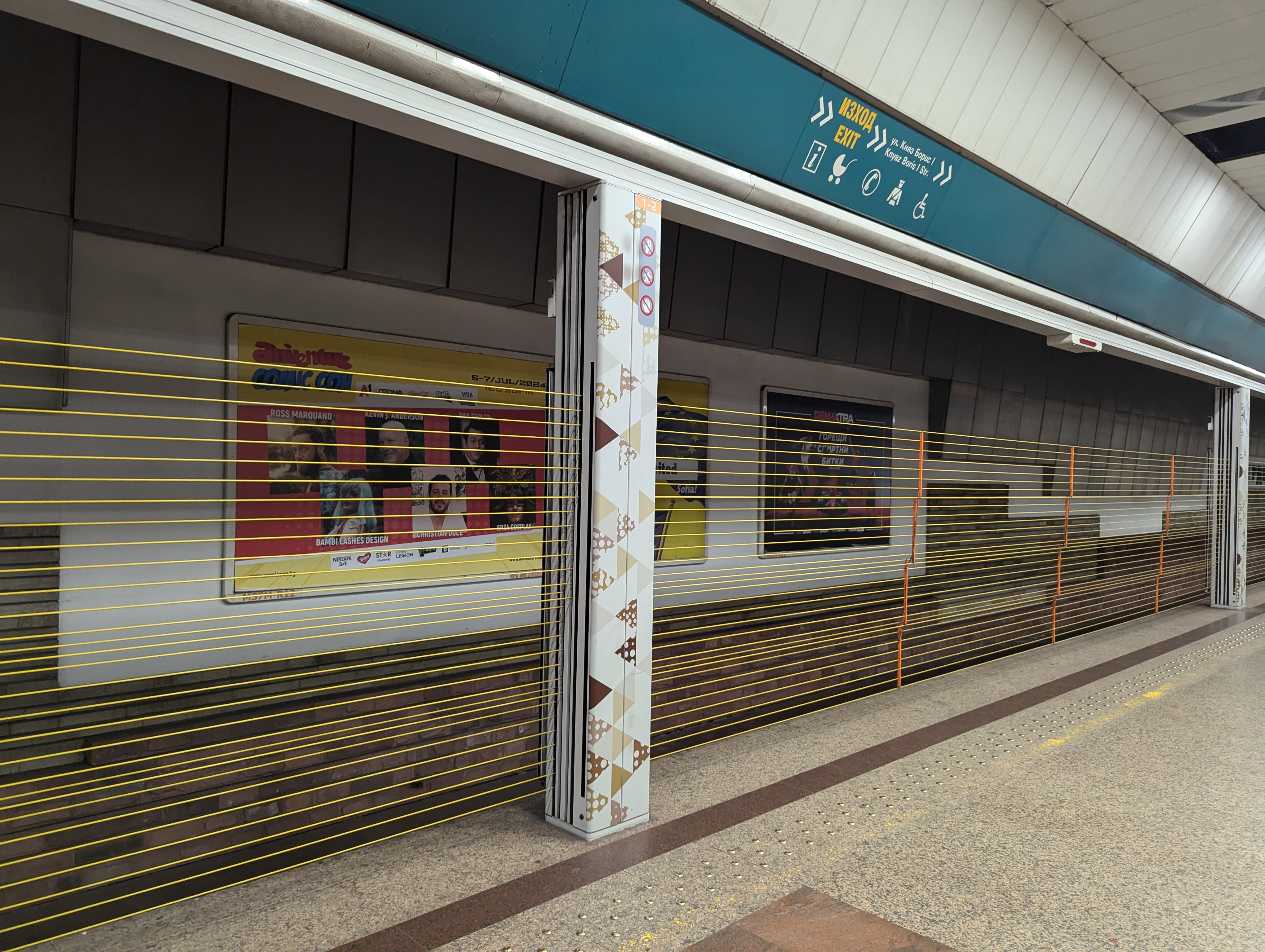

And Sofia uses an (as far as I can tell) unique system with rolling screens protecting the length of the platform.
I agree the NYC style fence is a good cheap interim step.
That Sofia system is generally similar to quite a few I've seen in East Asia, where that lifting cable style is decently common at outdoor stations on Japanese commuter lines, and particularly the Chinese HSR system. I wouldn't be surprised if Sofia procured its system from an Asian supplier. That said, it looks a lot "denser" than the ones I've seen in Asia, which usually have significantly fewer strands where a determined individual could make their way through, but certainly a good option for retrofits to our system here, where without CBTC stopping positions aren't exact.
That was clearly the motivation in Sofia, as I watched a few trains go by and none of them stopped quite at the same spot. I believe there's also some rolling stock heterogeneity which likely contributed to the decision.
The main reason I wouldn't necessarily expect to see it here is accessibility. Maybe there are better ways of doing it that I didn't see, but the implementation in Sofia generally had pillars placed across the platform, and sometimes a train door would end up (partially) behind them. Maybe there are ways to avoid that but stringing a long bit of (essentially) thin wire the whole length of a train car seems difficult.
